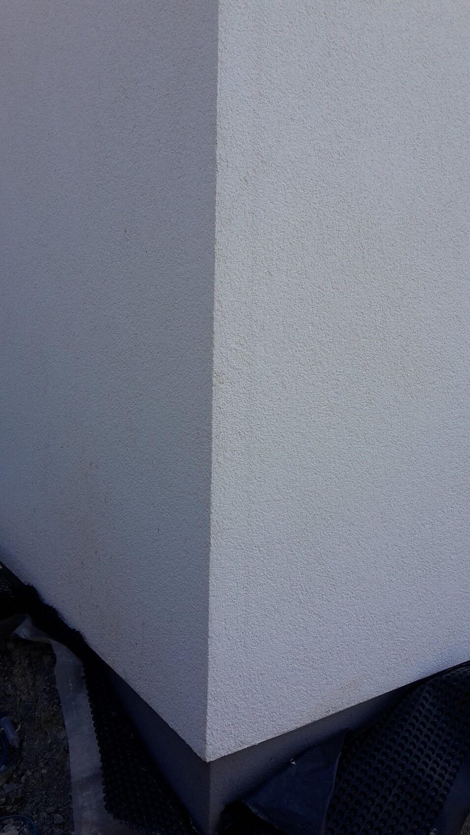

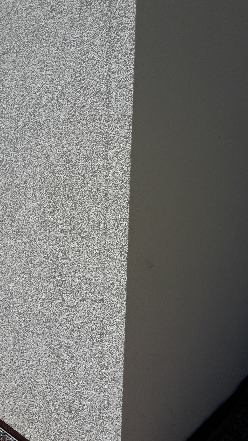

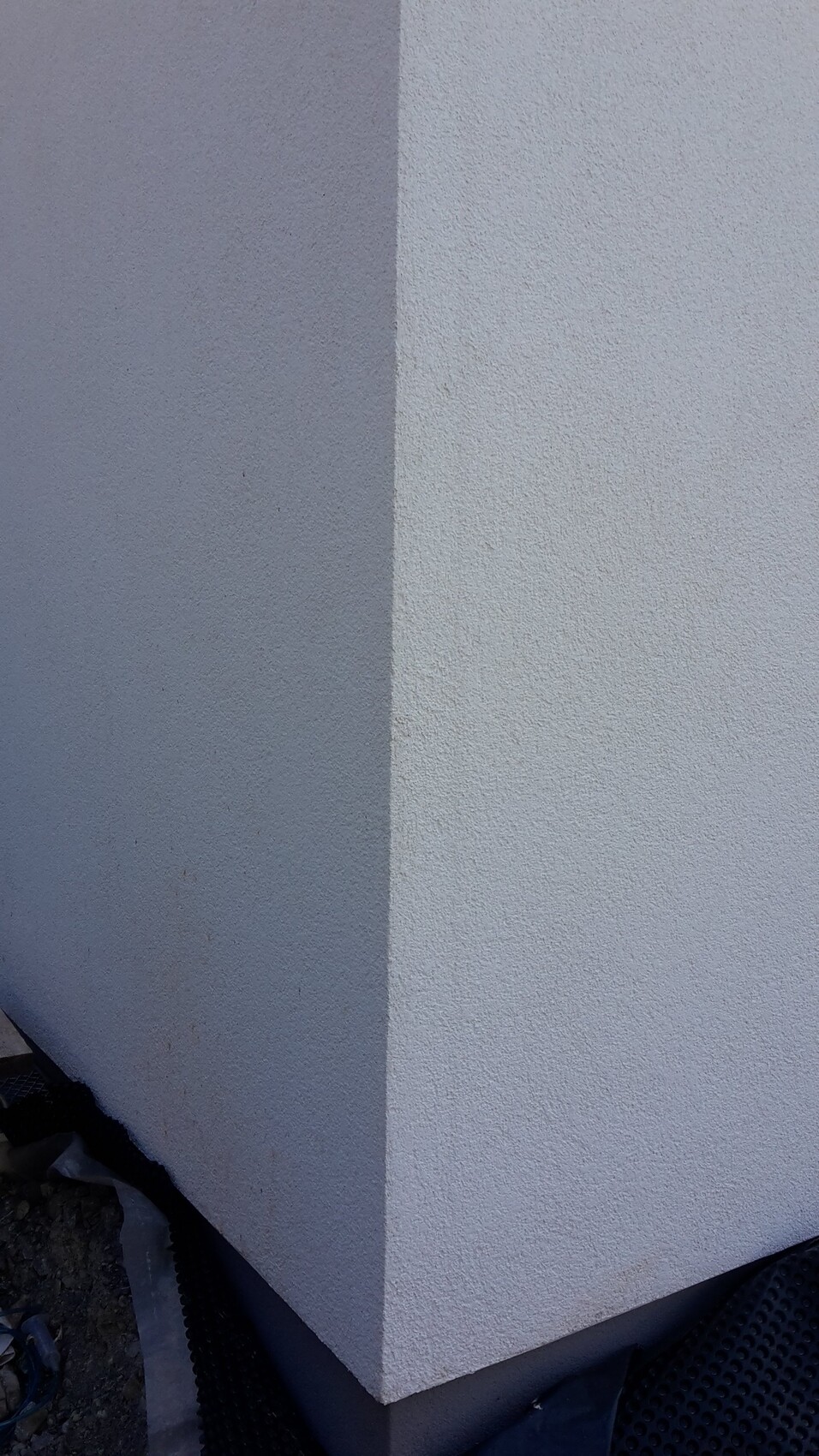

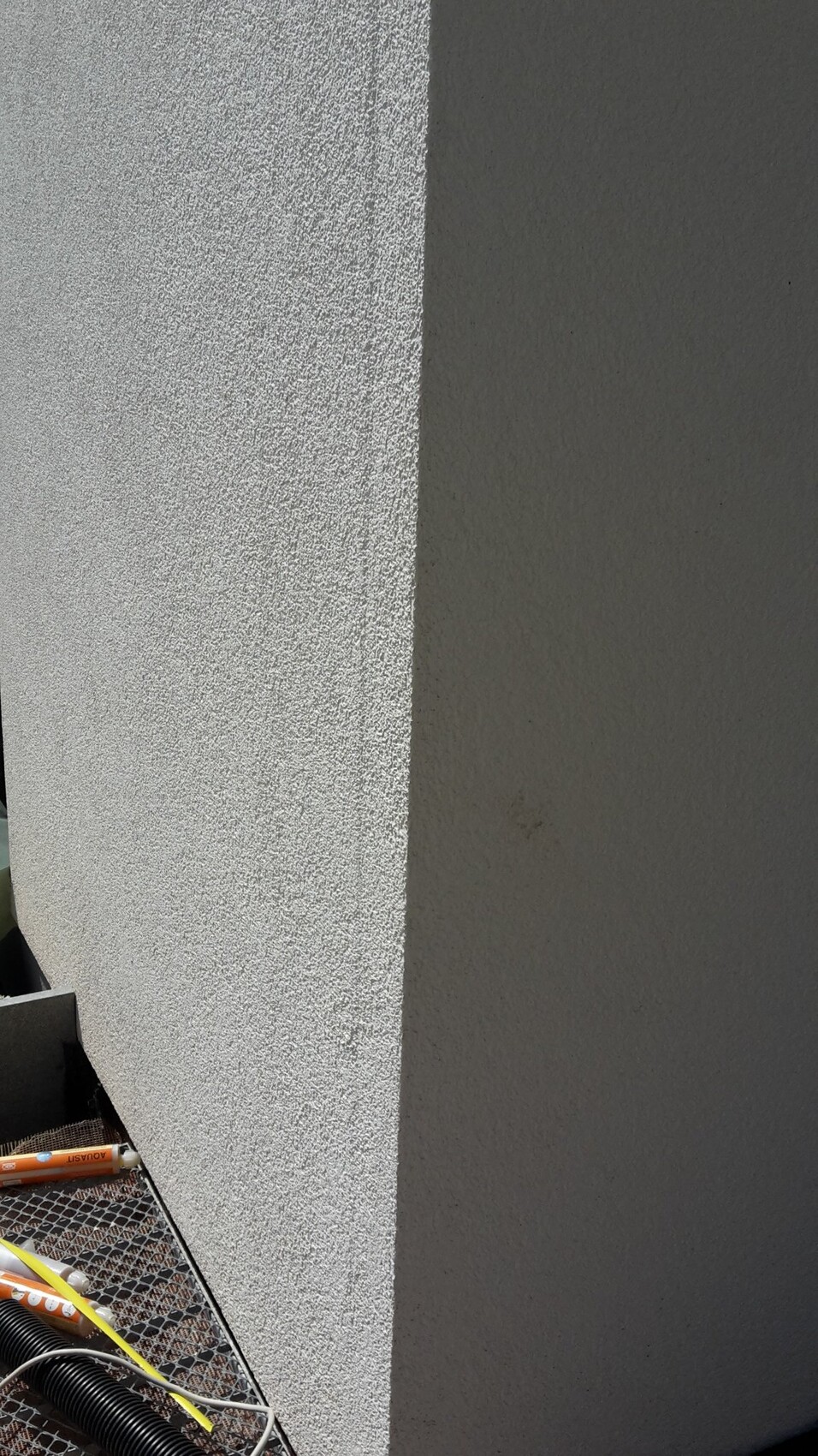

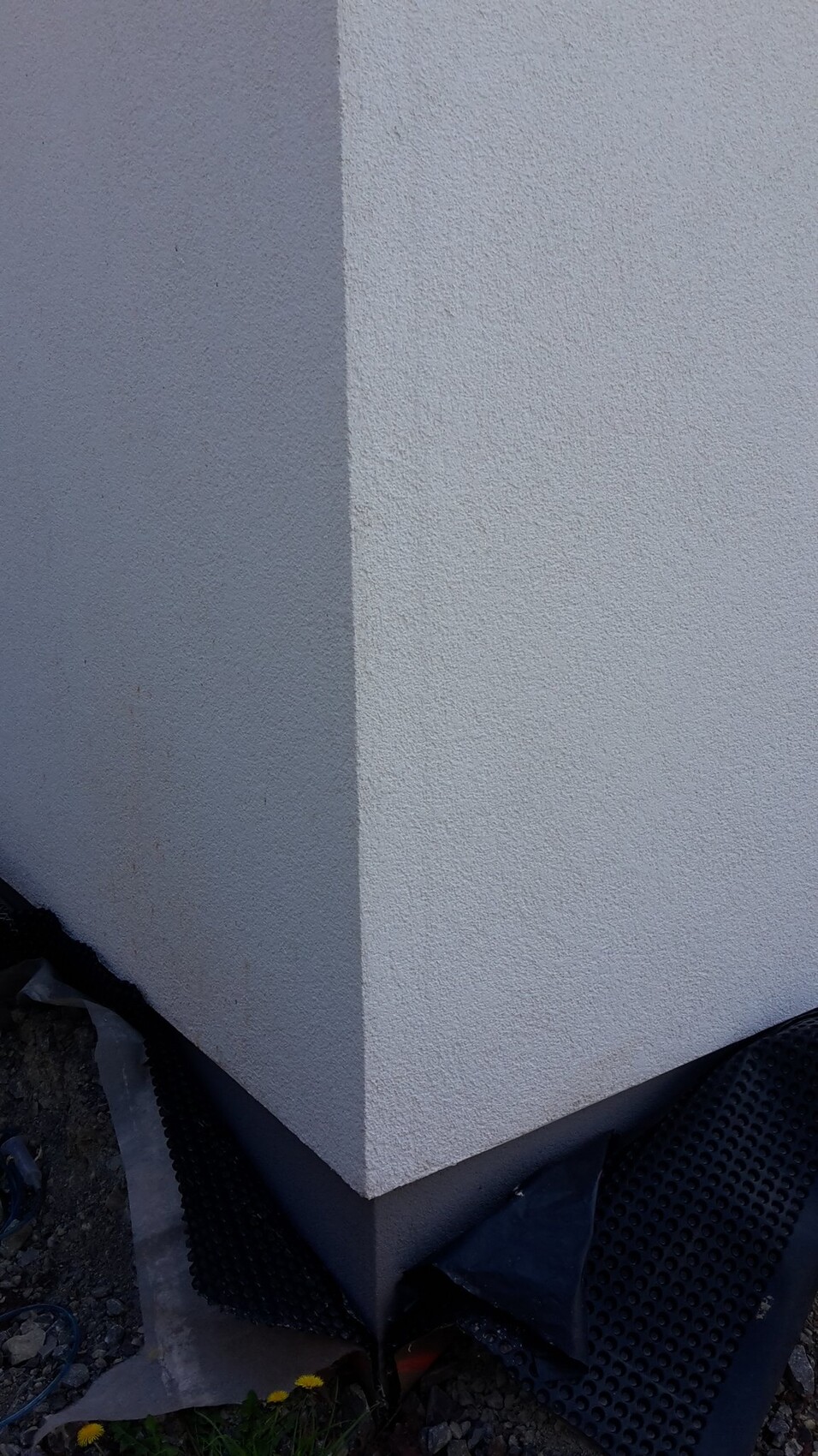

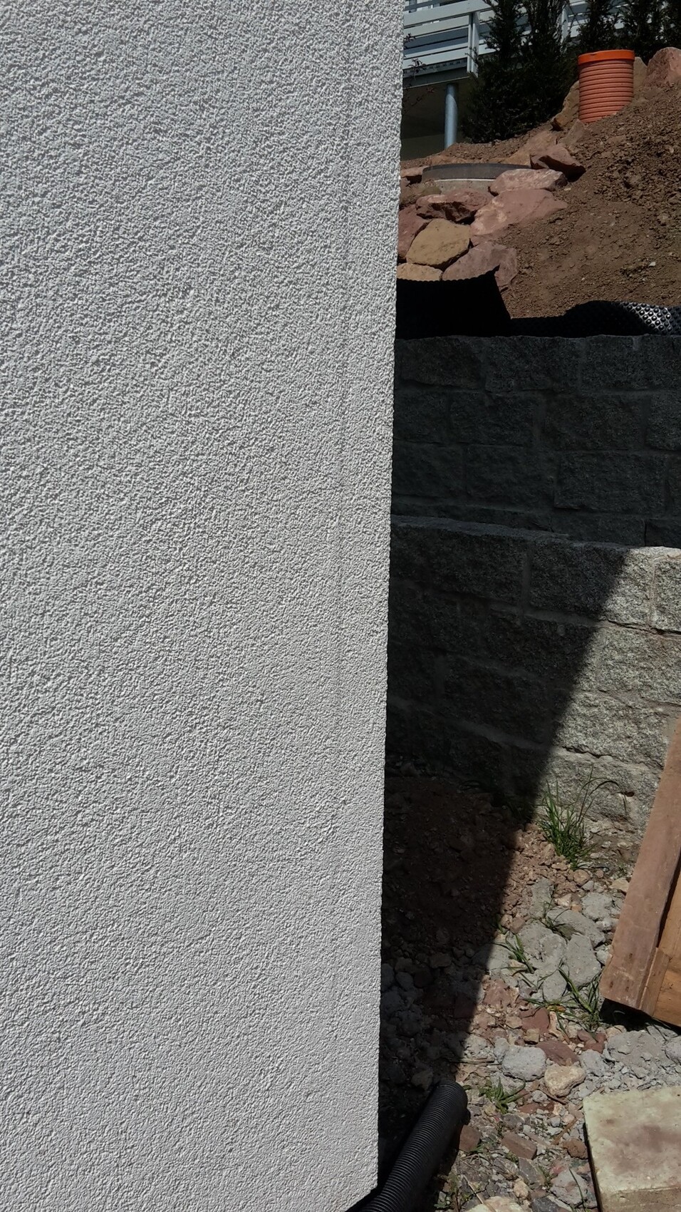

ᐅ The exterior plaster has strange streaks that look like markings or lines.

The work simply wasn’t done correctly. A base coat render is, among other things, meant to “even out” any irregularities in the wall structure, regardless of what type of wall construction is used.
In this case, the original poster simply neglected it. As a result, they will now have to follow up with the contractor, and since the tradespeople of larger general contractors often travel 300 km (185 miles) or more, it will take a while before anything happens—if anything happens at all.
There is also a guideline for the visual assessment of surfaces. This guideline clearly states that the surface should appear uniform and free of stripe marks. In my case, this did not quite work out. I have reported this to Bien-Zenker and am now waiting for a hopefully positive response.
