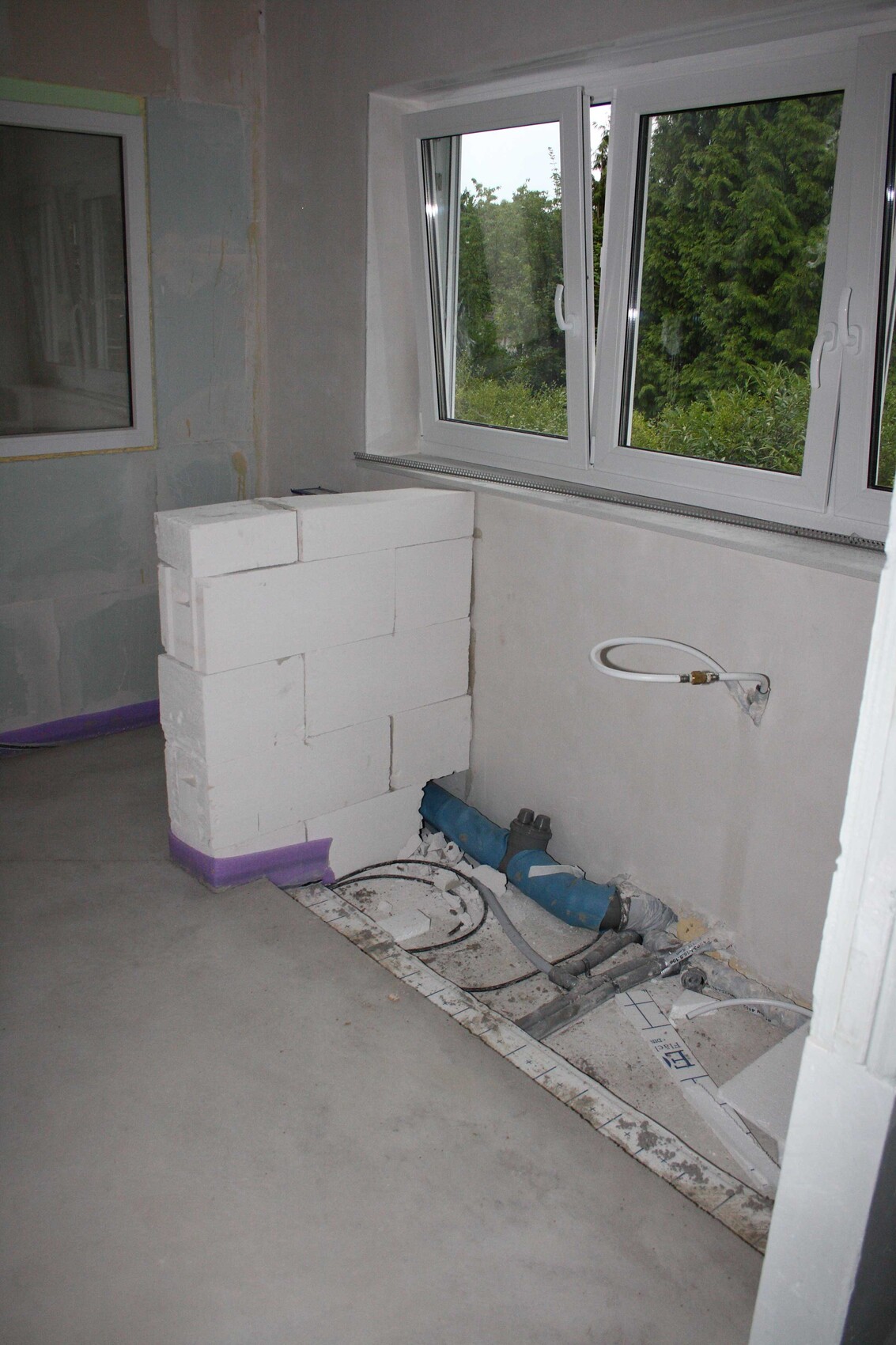

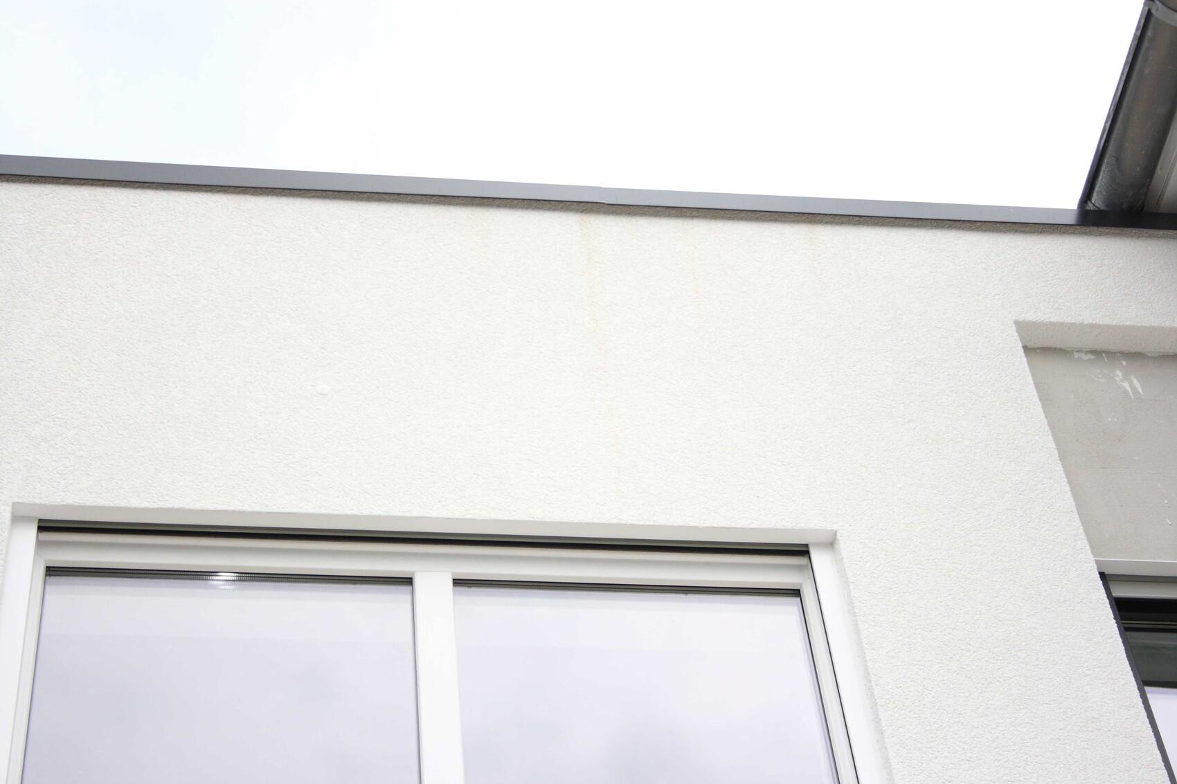

Then you should ask to see window units with an attached roller shutter box. Attached you will find explanatory images; the inspection box on the window opens from below (it can also optionally open from the front).
