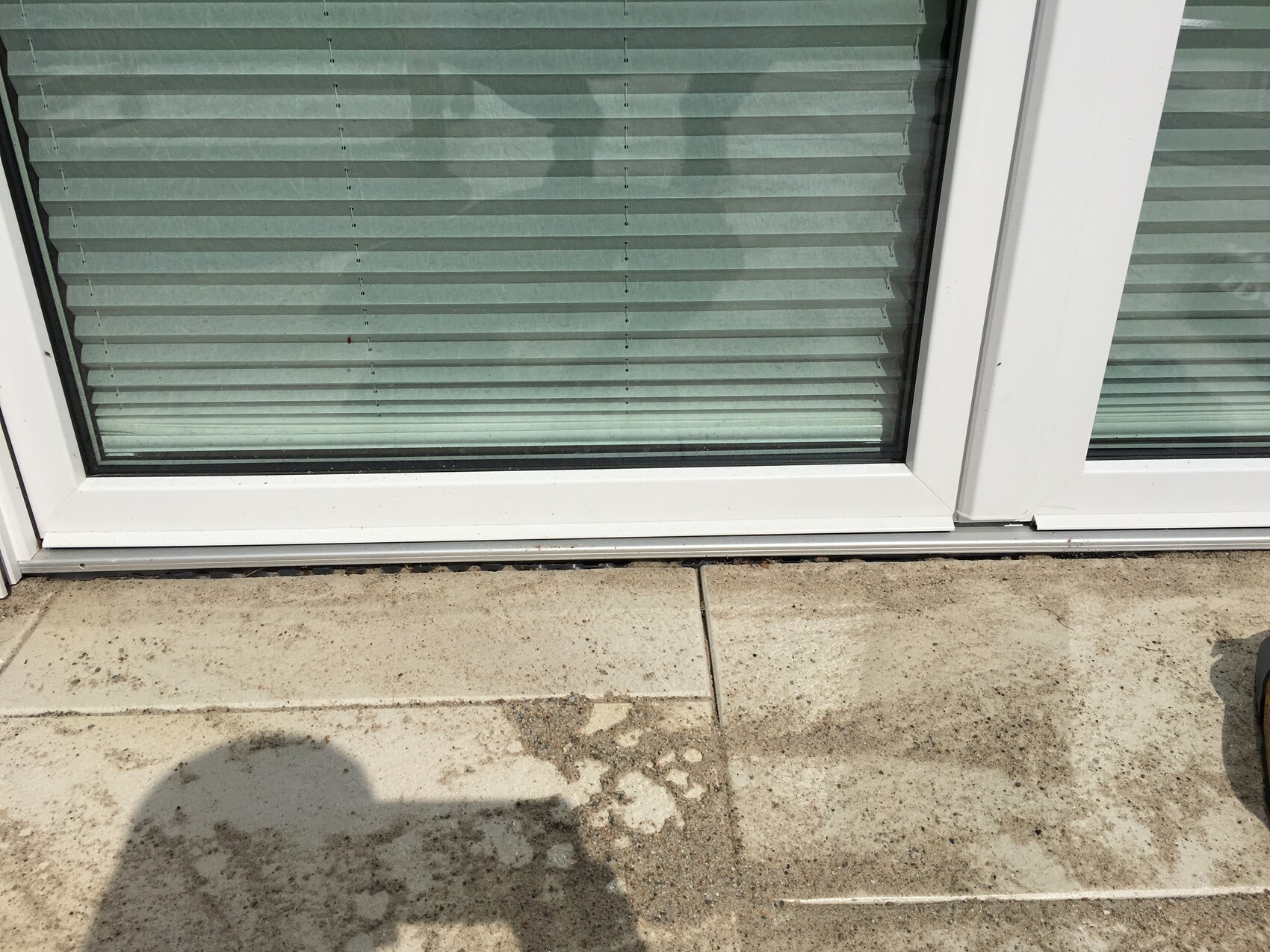

The terrace was completed by the home builder on July 14, 2016. We then pointed out several defects:
- Incorrect laying pattern – the staggered bond was not followed
- Slabs have sunk
- Slabs not installed under the patio door
- Height difference between terrace slab and patio door of about 2cm (0.8 inches)
- No smooth cutout around the downpipe (cut was square)
After long discussions and several postponed appointments, the terrace was relaid about 4 weeks ago. The slabs were lifted, the base filled and compacted.
Before the relaying, we repeatedly pointed out the defects mentioned. According to the site manager, in coordination with the landscaping company, all defects should have been fixed.
The following defects were resolved:
- Staggered bond was installed
- Slabs are level – although in my opinion, 3 slabs are still slightly sinking
All other defects were not addressed; the slab that needs cutting has been left next to the downpipe since then.
I am considering consulting a lawyer but have the following question first:
According to the site manager, there is no “construction guideline” that the terrace slabs must be flush with the patio door, meaning the slab does not have to be installed directly under the door.
He also claimed that the slabs cannot be installed under the door. However, at our neighbor’s, who only has stones laid, the stones are installed up to and even flush with the patio door, preventing any dirt from getting underneath.
Thank you very much for your help.

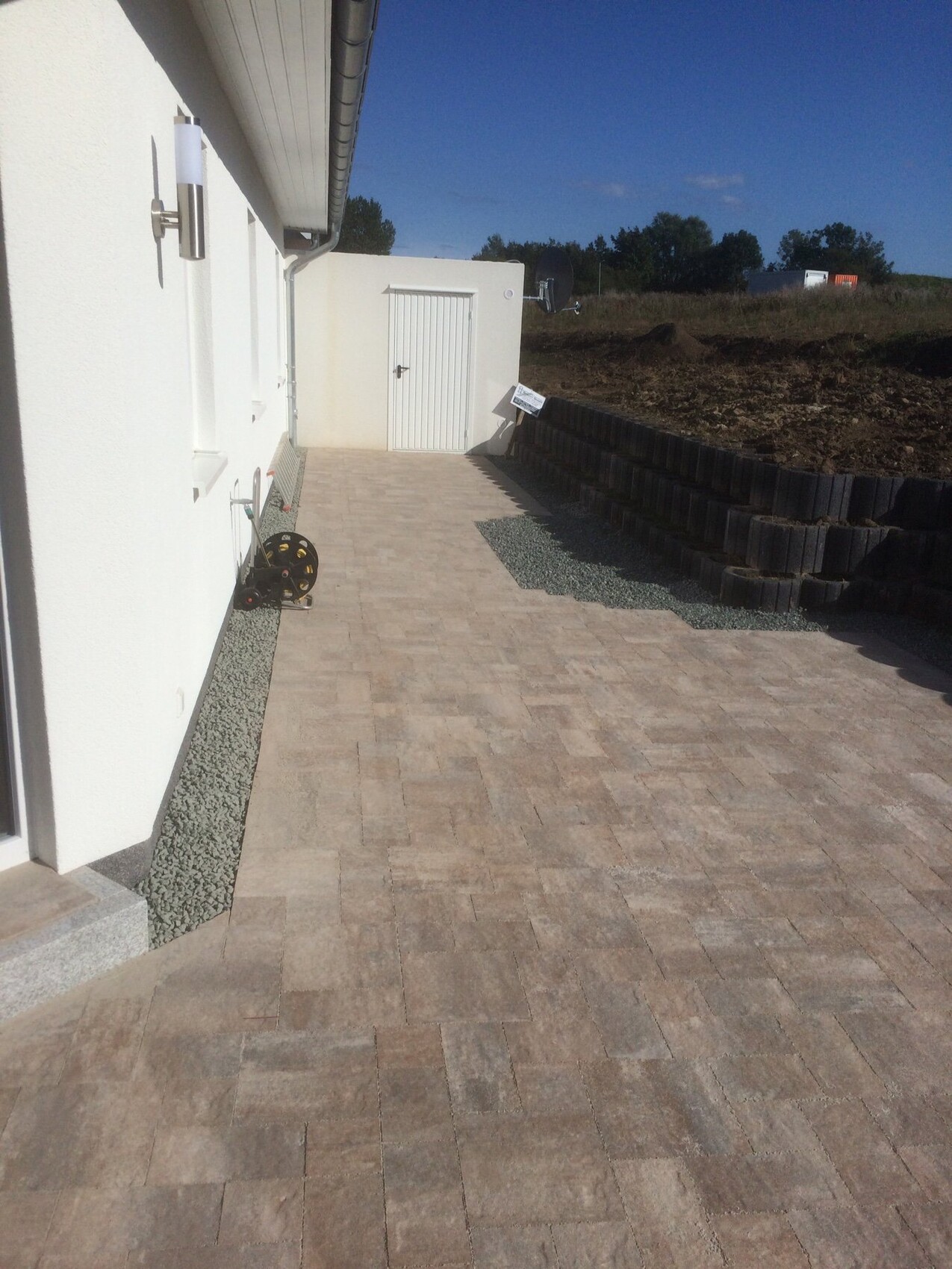

Bieber081520 Sep 2017 23:08I would also install a channel drain there.
Sorry, but I don’t see anything wrong in the photo. Everything looks fine to me. Why a gutter? A terrace always has a slight slope away from the house.
This is what a properly constructed terrace looks like from a garden landscaper’s perspective here. Drainage pipes are placed under the gravel both near the house and in front of the planters, the terrace has a slope, and there is a step with a small threshold near the door, so water will definitely never enter the house. Karsten
Nordlys schrieb:
This is what a professionally built terrace by a landscape gardener looks like here. Show-off.Similar topics
