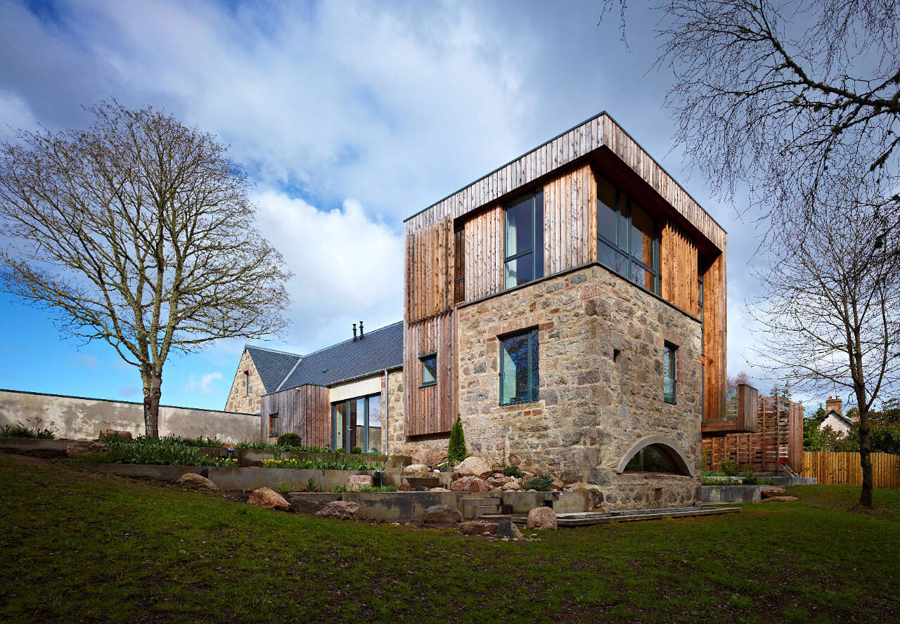

Our dream for a long time was the "Irish" look—meaning a natural stone facade—but unfortunately that is not financially feasible for us. So now, with brick slips, this is our last attempt.
Something along the lines of a country house, cottage, Irish, Scottish style.
