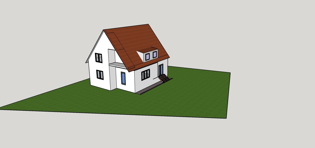

For better understanding, I have attached a 3D sketch, although it is not yet fully to scale.

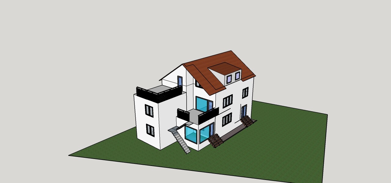

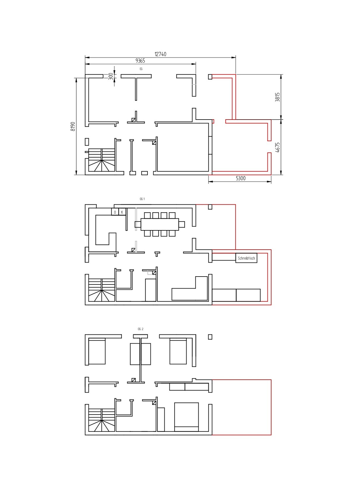

Christian_p23 Mar 2021 20:17Hello everyone,
I have gathered some more information now.
The first image shows the current status, with only minor deviations in scale.
In the upper floor, the knee wall is about 600mm (24 inches) high, there are three rooms, one bathroom, and a storage room.
The exterior walls are 30mm (1.2 inches) thick, the interior walls 115mm (4.5 inches).
The ground floor slab is solid, and between the ground floor and upper floor there is a wooden beam ceiling.
The ground floor currently has a bathroom, pantry, kitchen, dining room, and living room; however, it still needs a bedroom. The upper floor currently has three rooms, a bathroom, and a storage closet. Since it is intended to become a separate apartment, it is identical to the ground floor, and the attic shall be converted into three bedrooms with a bathroom. To provide enough space for all, I would like to carry out the following modifications:
1. Extension over the ground floor and first floor to add one additional room on each floor (no basement). The second floor (attic) would have a balcony.
2. Possibly an additional extension on the ground floor for a study / conservatory. The first floor would also get a balcony.
3. Raising the roof (with less pitch?), so that three bedrooms with a bathroom and storage room can be created in the current attic.
Since the house has a shared staircase, everything should be planned so that it can be divided into three separate apartments if needed.
Attached is also an image showing roughly how I envision it.
Development plan:
According to the responsible municipal official, this is not an issue here. All neighboring houses are significantly taller and also have various roof types.
Do you perhaps have other ideas or have you done something similar before?
Thanks in advance for your feedback.
