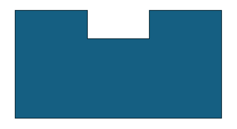

The concrete ceiling on top of the basement walls has the layout shown in image 1.
It can be seen that there is an opening on one of the long sides of the concrete ceiling.

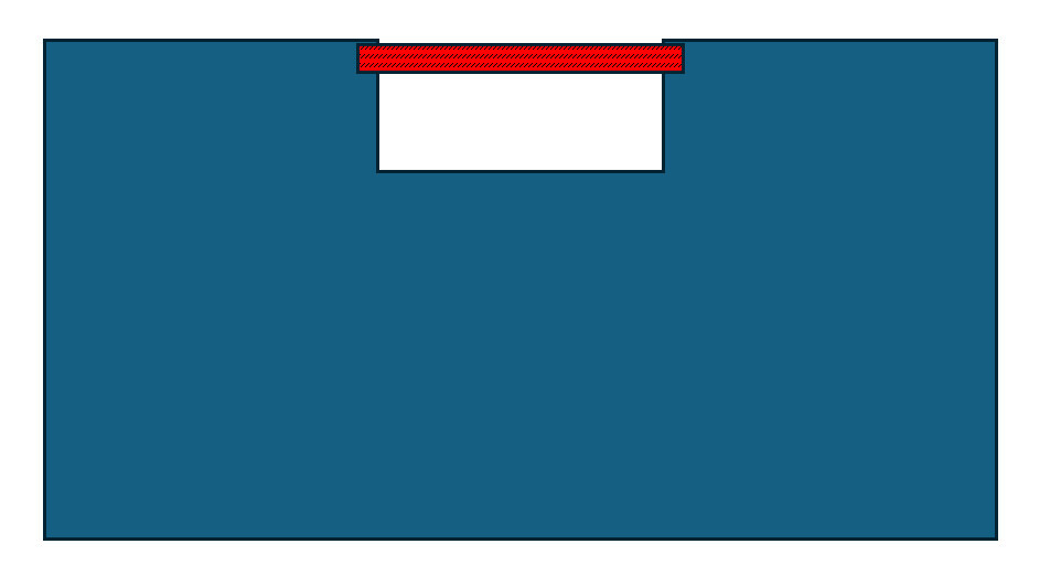

From the inside, it looks like image 2 shows (a loggia with a glass front).
This loggia (and thus the opening in the concrete ceiling) is approximately 1m (3 feet) wide and 4m (13 feet) long.
Attached to that opening from the outside is a kind of balcony (wooden deck on a steel structure).

The concrete ceiling would be cut away at a 45° angle on all three sides, and reinforcement connections would be added to these contact surfaces afterwards.
Formwork would be created, and the reinforcement connected to the existing structure would be installed.
The concrete contact surfaces would be treated with a product designed for concrete bonding.
Then, concrete would be poured into the formwork and compacted.
So far, I can imagine this procedure well, but I wonder if the large connecting slab will really be load-bearing.
Will this newly poured section have the same load capacity as if the concrete ceiling had been cast as one piece originally?
