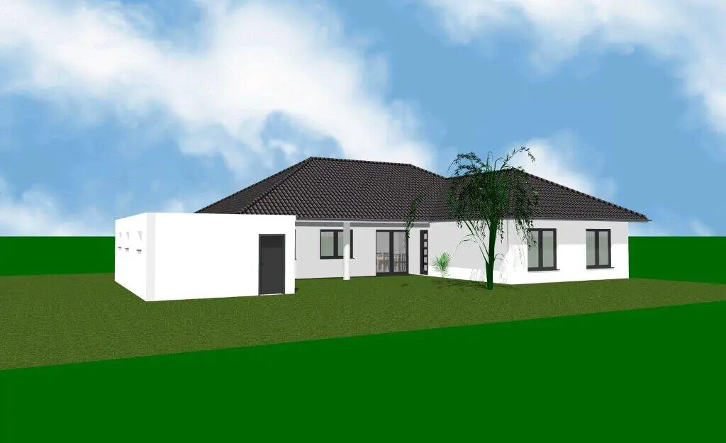

In 2016, we built a single-story L-shaped house in bungalow style (KFW70 standard). The house has about 170sqm (1830 sq ft) of living space living area, features a reinforced concrete ceiling, and the roof is a hipped roof structure with an extension made of engineered solid timber with a 30-degree pitch. The attic was originally intended only as a storage area, which was sufficient for that purpose.
Now we want to convert the attic into a living area, which was not planned initially. Unfortunately, the ceiling height is insufficient for this. We have considered solutions like a hydraulic roof lift (which is not an option for us) or a knee wall increase (currently there is no knee wall at all). However, both options seem unfeasible for practical reasons (structural concerns and probably cost issues).
Currently, there is a foldable attic ladder, but we already created a larger opening in the reinforced concrete ceiling for a proper staircase, which is now covered.
I asked about the possible knee wall increase in another thread, but it seems unlikely because the structural integrity and substructure are considered too risky.
We want to use the attic as additional living space within the next 1-2 years (for a child), but in the current state, the space is too small and too low. The usable area is now about 65sqm (700 sq ft) and should ideally be around 90-120sqm (970-1300 sq ft). (The total ground floor living space in the L-shaped house is about 170sqm (1830 sq ft).)

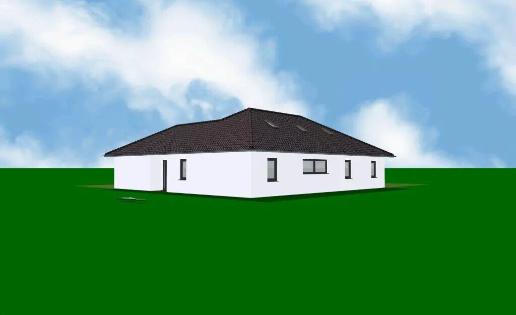

The question is whether it would be generally feasible to remodel the roof by increasing the pitch from the current 30 degrees to 45-55 degrees. This would allow us to add multiple windows (currently there is only one) and possibly install a photovoltaic system at the same time. One idea would be to use the longer "L-section" as living space and keep the shorter section mainly for storage. Although it might look odd to alter only the longer section and leave the shorter one unchanged.
The current brine heat pump has sufficient capacity to cover the needs. The neighboring houses all have roof pitches up to 55 degrees.
General opinions without detailed floor plans or calculations would be appreciated.
Thank you very much!

WilderSueden9 Feb 2023 11:37monty99 schrieb:
In the middle of the long L-section, the current height is about 2.2 meters (7 feet 3 inches). At the moment, there is only insulation laid on the reinforced concrete slab with OSB boards on top.
If we build a proper floor structure with underfloor heating there, we will lose height again.
Overall, the usable space will always remain quite small. The existing insulation and floor construction should roughly balance out. The thermal envelope is then shifted to the roof, and underfloor heating below an intermediate ceiling doesn’t necessarily require 10 centimeters (4 inches) of insulation.
2.20 meters (7 feet 3 inches) really isn’t much. I’m a bit surprised, though, since our house is definitely smaller in dimensions, and we should have about 2.30 meters (7 feet 7 inches) below the ridge beam.
Even with dormer windows, which we would add, the usable space would still be rather limited.
I do not want or expect detailed calculations, cost estimates, or feasibility studies here.
The simple question is whether this is fundamentally possible, and to what extent. There may well be people who choose not to sell their house but instead carry out such modifications.
We are fully aware that everything must be discussed with authorities, structural engineers, and architects.
