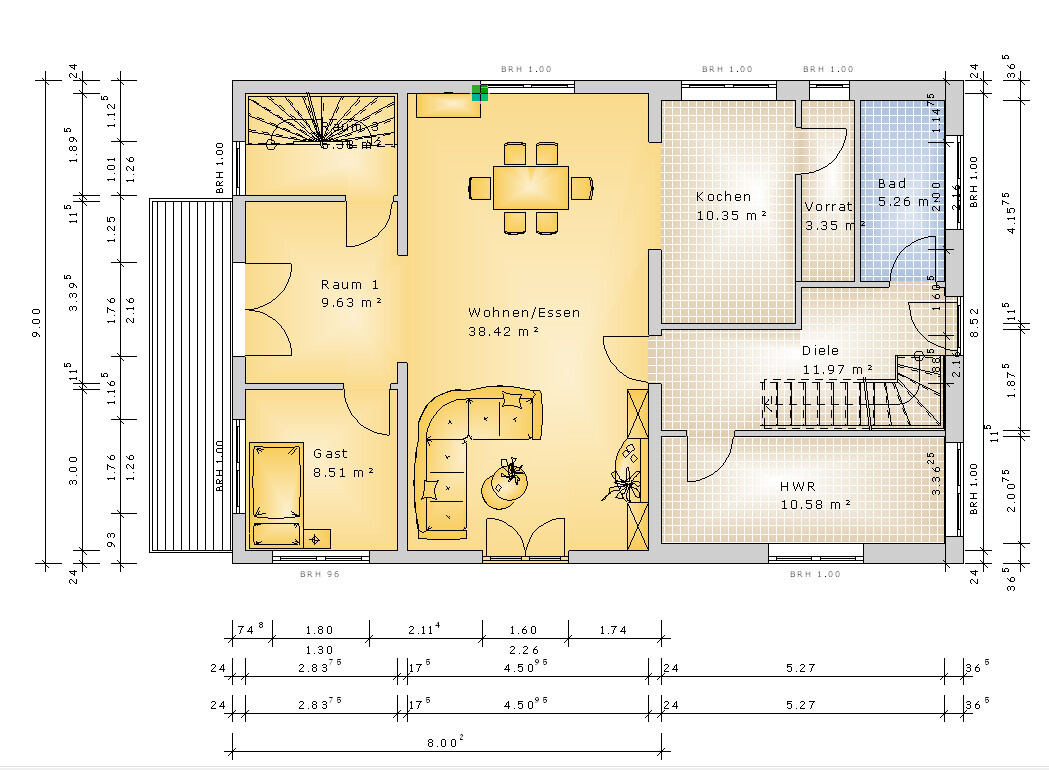

The existing building was constructed in the 1960s. Over the years, various renovation works have been carried out (electrical system, windows, ground floor flooring, stairwell, etc.). However, the electric heating consumes a lot of energy. The rooms are small, and the current layout is no longer suitable for two households. On the north side, a garage extends along the entire length of the house on a half-level between the basement and the ground floor.
The idea:
After careful consideration, an extension of the existing building towards the southeast seems reasonable. This would result in a building footprint of 14x9m (existing 8x9m + extension 6x9m = 126 sqm (1356 sq ft)). Ultimately, two separate residential units should be created. A utility room for each apartment is essential. Additionally, it would be beneficial if the upper floor apartment could also use the attic as living space. This could probably be designed as an open plan, but I lack the imagination regarding the room layout. I also don’t know to what extent the exterior wall of the old building will pose challenges for planning. It will certainly have to remain in place.
The tricky part about the existing building is that you have to walk around the house to reach the entrance door on the west side. To avoid visitors having to pass the ground floor when coming to the upper floor, the entrance area should be directly accessible from the street (south side). The question is: what to do with the existing stairwell? Demolition is problematic because it provides access to the basement. Should the old entrance remain for the ground floor and only the upper floor get a new entrance from the south side? I am uncertain. I do not necessarily want to have a basement under the extension — mainly for cost reasons, and the existing basement is actually large enough.
Technical aspects:
I would like to replace the old electric heating with an air source heat pump combined with underfloor heating. The roof covering will soon need to be replaced as well. Since the roof will have to be redone due to the extension, this could be a good opportunity to consider adding a photovoltaic system. New windows will be installed everywhere, and the exterior facade needs insulation. Does it make sense to build the extension with built-in insulation from the start? What is the best way to insulate the old building?

El_Burrito5 May 2017 19:02The description in your initial post is a bit unclear to me. Also, I mentioned that the ground floor should be posted as a JPG at some point.
What’s missing for clarity is a site plan showing the plot, the existing building, and the proposed extension in different colors.
Additionally, floor plans of the existing structure and, in a different color, the new walls and possibly any demolitions.
Your 3D model looks and will probably seem too bulky in reality.
In the 3D view, there is also an extension on the ground floor (east side): who will use that space?
Wouldn’t it make more sense to place the entrance to the upper floor in the east-side extension on the ground floor?
What I took away: a total height of 7.5 meters (24.6 feet)... which means you would barely have a usable room in the attic.
