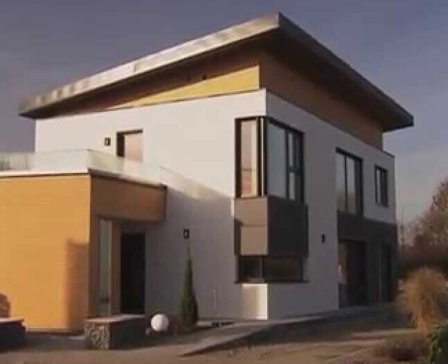

Knallkörper20 Sep 2016 17:11Your
Your construction doesn’t serve any function compared to the shed roof in the photo. Is that so hard to understand?
bauherr85 schrieb:
@Knallkörper
Okay, then let’s do it this way. How would you describe the roof on this house? Is it a flat roof with an undefined upper structure, or do you see it as a shed roof? Because it’s exactly the same, except that the walls reach up to the roofing in that example, while I chose a different substructure. Maybe it’s not clear in my photo, but the roof covering extends beyond the entire house on all sides (except the balcony). I’ll remove the supports and replace them with walls in that area, then you’ll say: Of course, it’s a shifted shed roof.
