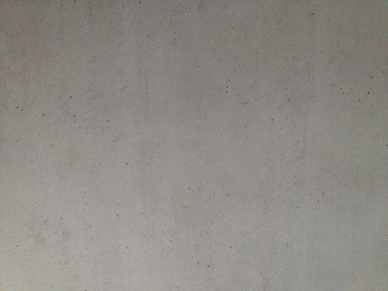

alive&kicking13 Jul 2019 00:15Hello,
Although this thread is a bit old, I am very curious about which concrete filler you used, what tools you used for sanding, and which primer or wall paint you applied.
By the way, it looks great!!!
Thorsten
Thorsten
Thank you, we used Sopro BS467, but not over the entire surface, only in one problem area.
I don’t remember which primer we used, but I don’t think it matters much. The main thing is that it’s clear and binds any dust, preventing the concrete from sanding.
I also don’t recall which paint was used. Again, it’s not really important, as long as it’s gray. I believe we used our white natural interior silicate paint and mixed black tinting paint into it, but I might be mistaken.
We worked very gradually, starting with very little paint and a lot of primer, then mixing in a bit more paint with each coat until it looked right. It worked really well.
