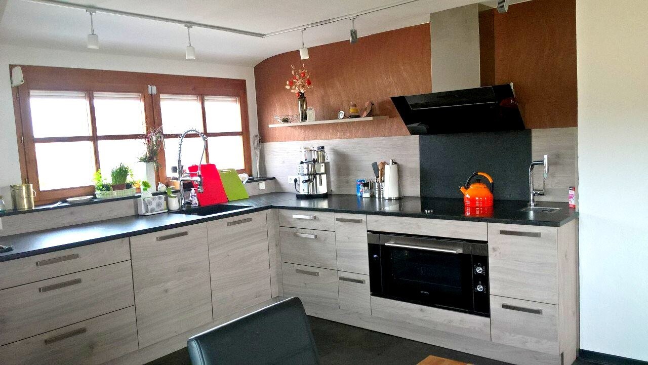

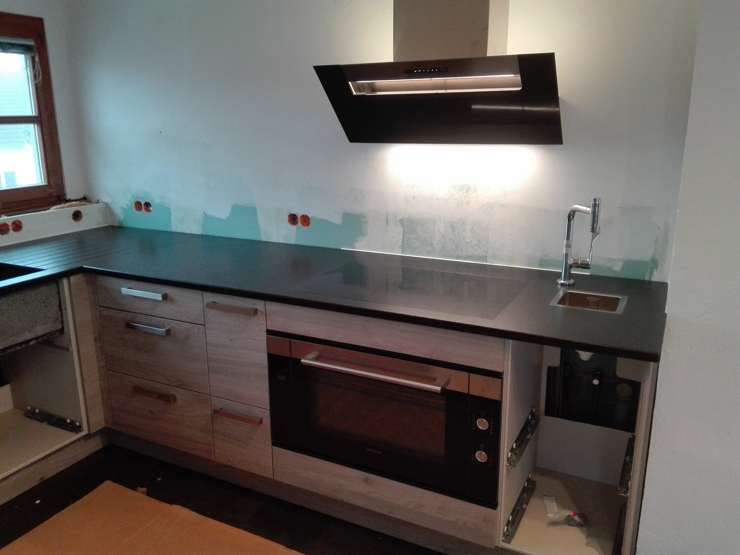

Deliverer29 Mar 2018 13:58berndn schrieb:
Could you upload a picture of how it looks?Once during installation:
And once shortly after:
The basin measures 22 x 22 cm (9 x 9 inches) with a depth of 16 cm (6 inches) and is located about 35 cm (14 inches) from the front edge.
