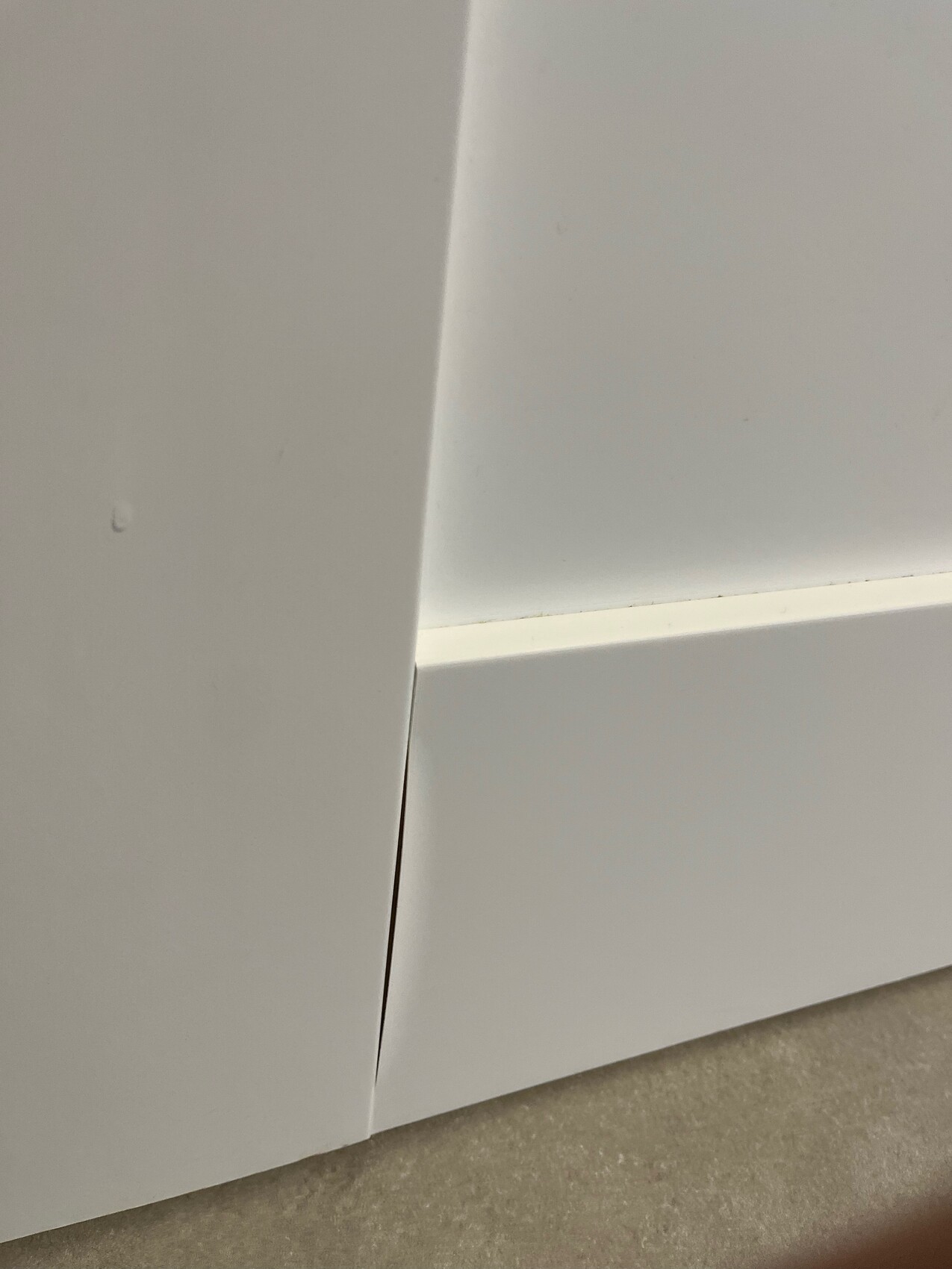

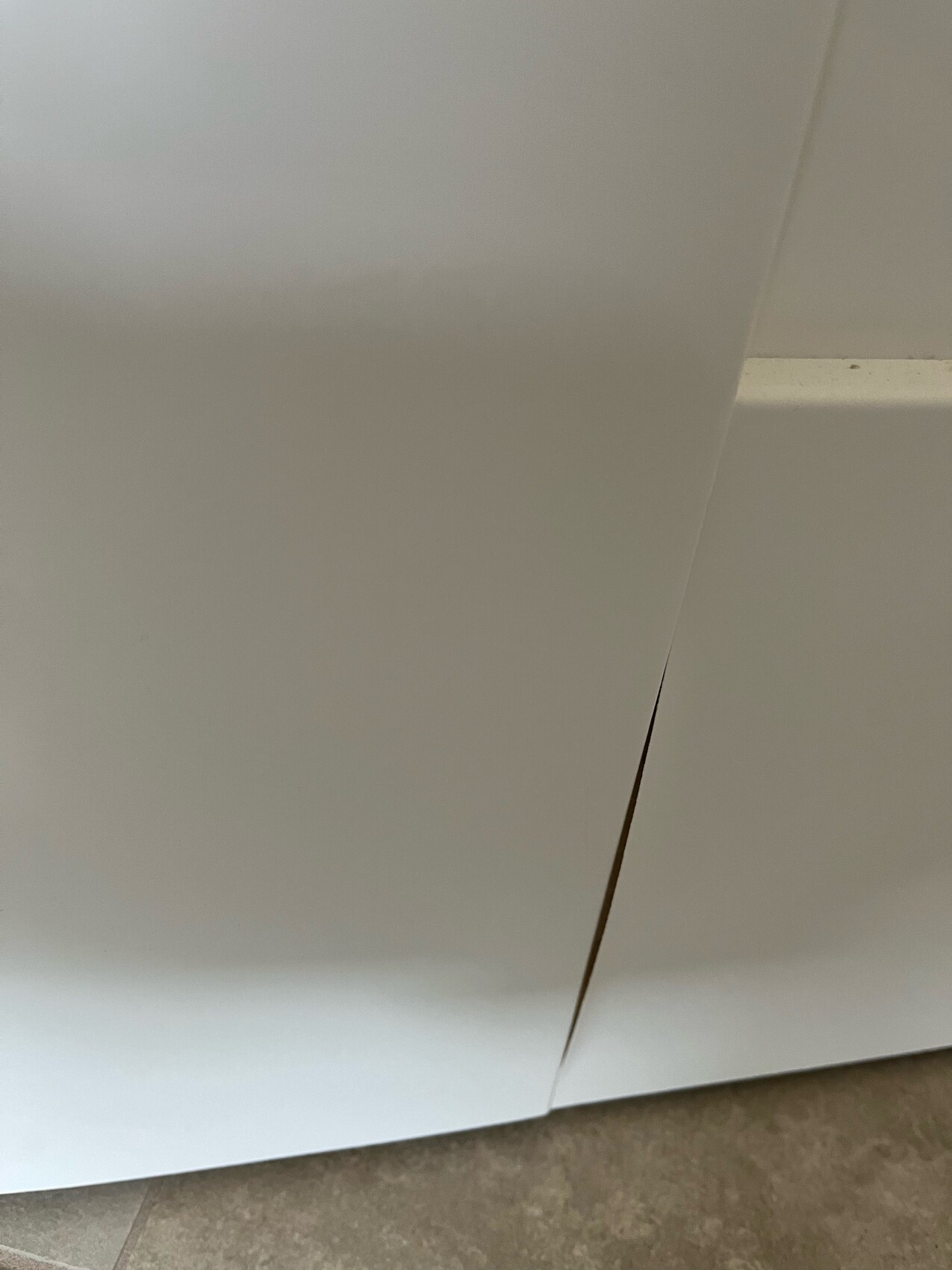

The doors were delivered in September 2023 and installed by a professional in October 2023. There were no problems for the first 10 months, but about three weeks ago, the surface started to peel off on six doors.
We are not experts and cannot tell from the condition of the door whether it is lacquered or foil-coated. In our case, we believe that these doors are foil-coated and not, as ordered, spray-painted.

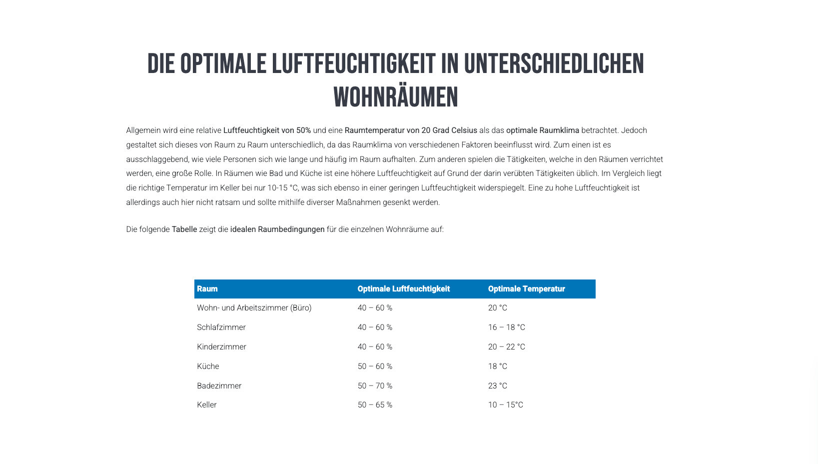

Humidity was 62%, a normal value given today’s outside temperature of 28°C (82°F) and an average outdoor humidity of 79%.
The representative stated, “Our installation instructions say the doors must not be installed where humidity exceeds 60%. Therefore, we as the manufacturer are not liable!”
Does this mean Ringo doors should not be installed in areas with higher humidity? In Bavaria, for example, humidity is often high during summer – so are Ringo doors unsuitable?
I took the liberty of researching the optimal room humidity myself.
According to the above table, does that mean Ringo doors are not suitable as bathroom doors?

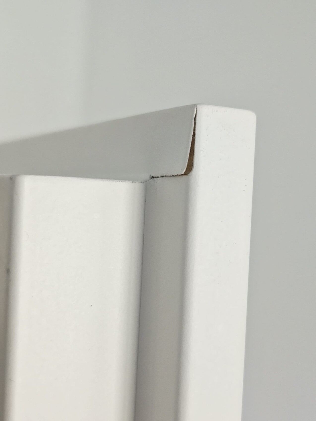

brueningt4 May 2025 11:24I have an update on our topic. The first doors have now been completely replaced free of charge. The cause of the surface issues was a manufacturing defect. The primer foil was not properly glued, meaning that in the areas where the surface came off, no adhesive was applied... The newly delivered doors are also damaged. On all doors, the upper edge along the border is damaged by one to two centimeters (about 0.4 to 0.8 inches), meaning the primer foil is torn. Let’s see how things develop. Our supplier is trying to get a refund from Ringo and then install doors from HGM (Park Lane).
