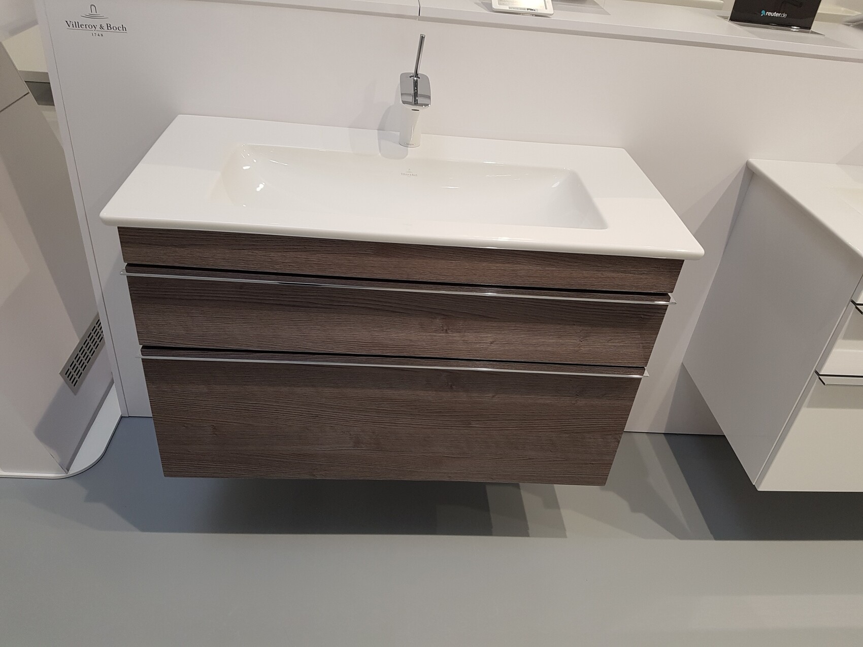

We choose a nice wide single basin used by one person. We don’t have to rush through our morning routine, and everyone uses the bathroom individually, or at least it’s not necessary to have two people standing at the sink together.
For the master bathroom, we go with the first setup.
For the guest bathroom, the second setup (but with a vibrant color on the outer panel, which still needs to be selected in combination with the tiles).
