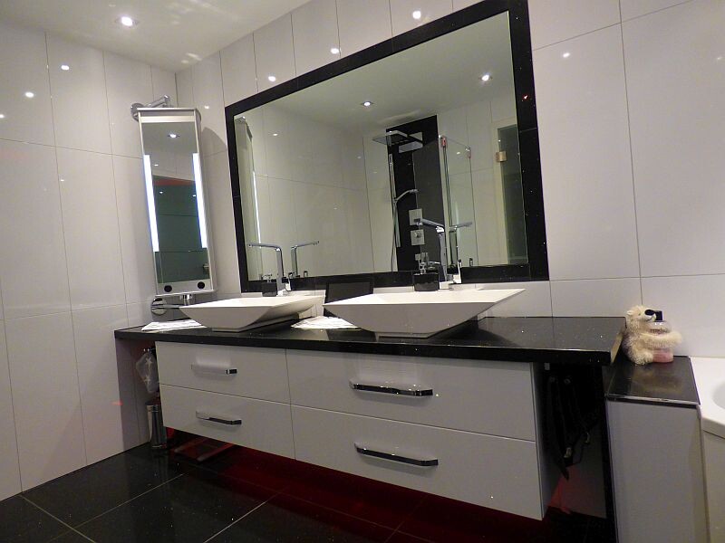

R.Hotzenplotz5 Oct 2017 22:10@Badjunge
Can you tell me which basins are installed in the lower picture? The furniture looks nice as well.
We were at our consultation marathon yesterday but postponed the decision on the washbasins. They had recommended a vessel sink to us. My wife really likes it. Personally, I'm not so keen on it but I can live with it...
We definitely want something deep, not a shallow one where the water runs out.
Hello Hotzenplotz,
the washbasins are extremely heavy and sturdy. I even dropped a full aftershave bottle into one, and nothing happened. They are really durable. Dyeing hair in them is no problem either.
However, they are hard to find.
It is the MANIA series by Eumar. Just google it. You can probably also order directly from the manufacturer.
No matter what you choose, definitely don’t go for a shared washbasin...
From our experience, whether it is a countertop or inset washbasin doesn’t really matter.
When the sample offer arrives, make sure to sit down before reading it ))
