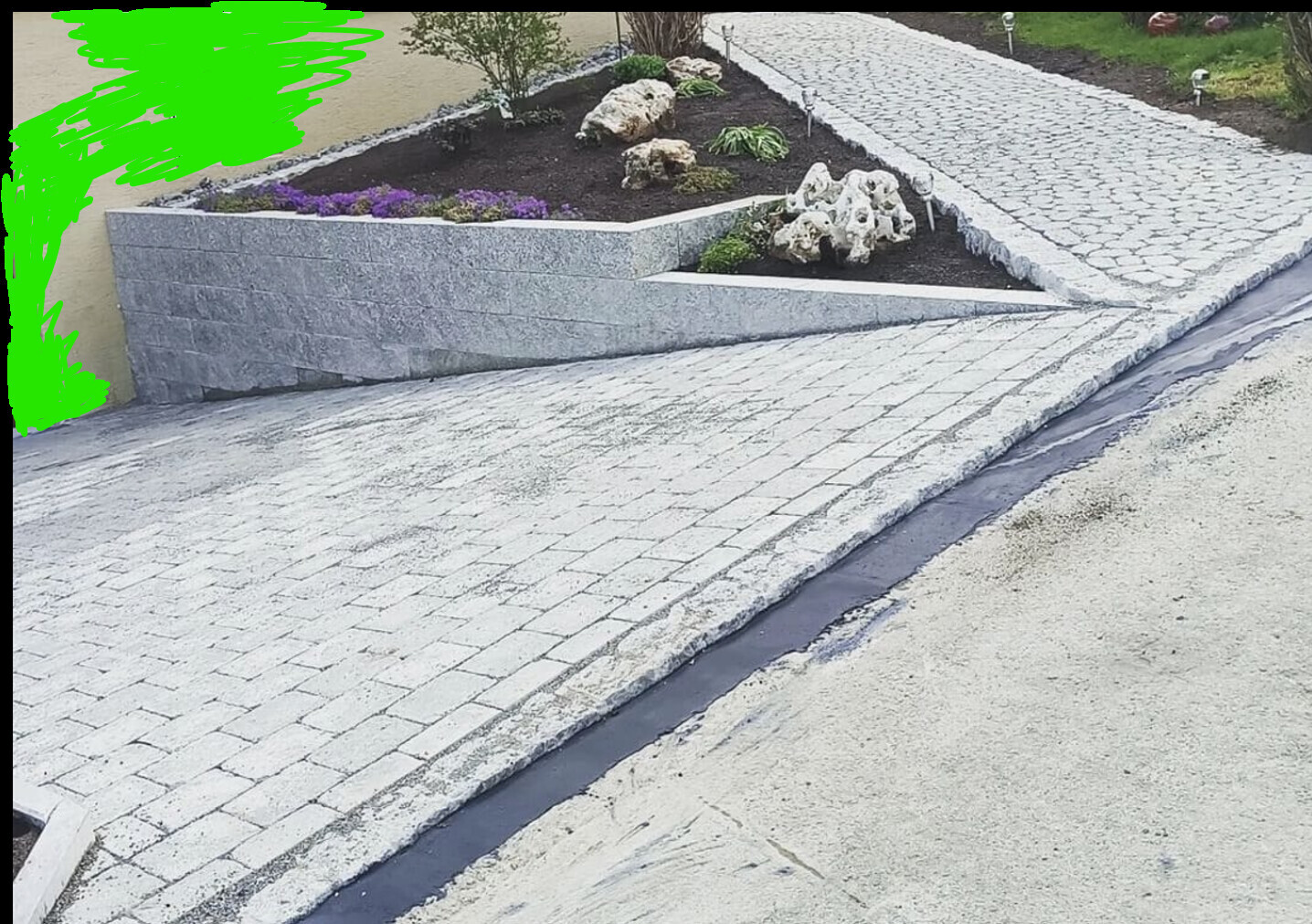

I have a photo where Arena and (probably) Tegula are mixed. It doesn’t look bad or confusing. However, in my case, the terrace would also be added.

os24laenger2 May 2025 11:00We have had Arena paving for over 10 years in the driveway (17% slope), carport, and pathways to the house. Everything is still exactly as it was on day one. Shoveling snow has not been a problem for us so far, but the wide joints do allow quite a bit of weeds to grow over time. I wouldn’t recommend it for the terrace because gravel can easily jump up between the joints, and individual stones behave like Lego pieces and can hurt your feet, so it’s better to choose something solid there. For our new house, we decided to use Arena again.
O
os24laenger5 May 2025 14:32We have Tegula on the terrace with Arena directly next to it. Our Arena is gray, with part of it black and the terrace in sandstone colors, but over time everything will turn gray anyway.
