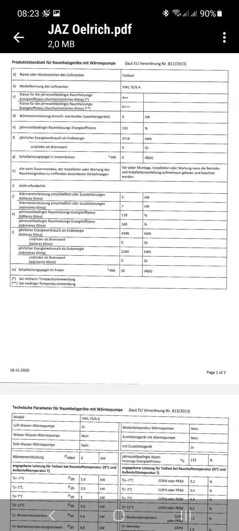

Hello, we received the information about our heating system for the new build (120 sqm (1,292 sq ft) living area) yesterday.
I would like to hear your opinions about it.

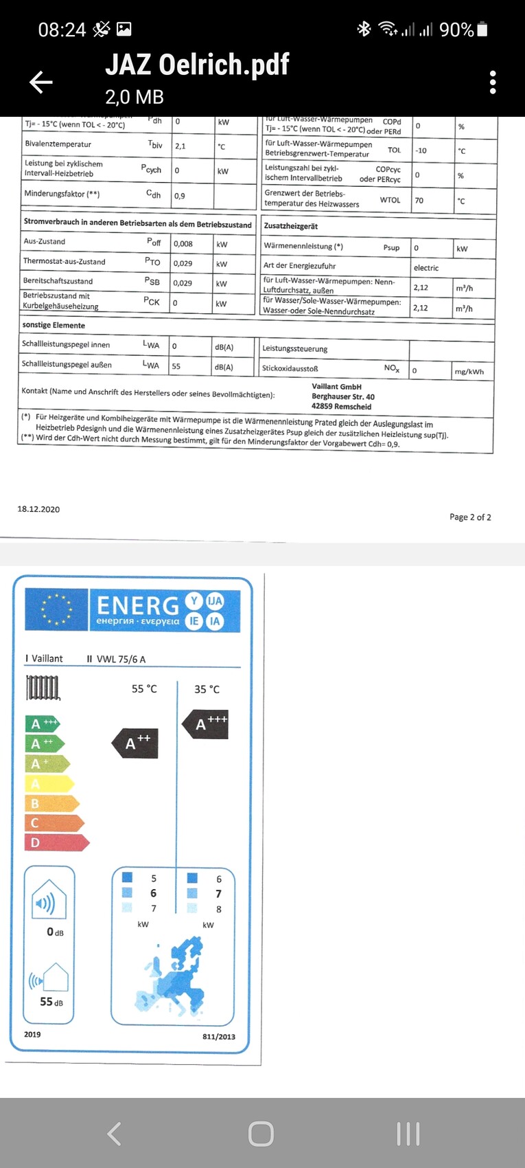

I have received the documents.
Formularseite zur Berechnung der Jahresarbeitszahl für Wärmepumpen mit Vaillant-Logo.
Screenshot eines technischen Dokuments mit Tabellen, Vaillant-Logo und Adressdaten.
Technisches Datenblatt: Raumheizgeräte mit Wärmepumpe, EU-Verordnungen 811/2013 und 813/2013.
PDF-Screenshot: Tabellenwerte + EU-Energiekennzeichnung für Vaillant-Heizung.

OWLer15 Feb 2021 09:10
In my opinion, the annual overview is irrelevant for sizing the heat pump.
We have approximately 190 sqm (2045 sq ft) of heated area and a building volume of just over 1000 cubic meters (35,300 cubic feet). According to the heating load calculation, the 55 kW Arotherm would have been sufficient, except for the pump capacity. That’s why we are now getting the 75 kW model, which is actually oversized.
When I see 120 sqm (1290 sq ft), I claim that the minimum factor of 2 is oversized.
The energy consultant does NOT handle this. For the design, you need a mechanical, electrical, and plumbing (MEP) planner.
Tolentino15 Feb 2021 09:12
Yes, the same applies to me. The pump capacity and the 55/6 model cannot achieve the annual performance factor of 4.5. Although the incentive scheme is being changed now...
