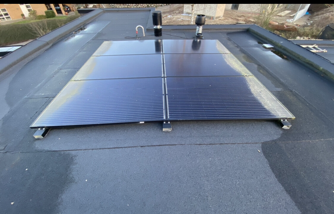

Thorben8116 Feb 2022 21:53Hello,
We have purchased a house in Denmark (Vejle) with a 2-year-old photovoltaic system on the roof. There are 6 panels, but I can’t identify the exact type. I assume the capacity is around 2 kWp.
Inside the house, we have a Fronius Primo 3.0.1 inverter, which can easily handle double or more of that capacity. There is plenty of additional space on the roof, probably 3 to 5 times more.
We also have an electric car and an EVBox Elvi charger in the house. Our electricity consumption seems quite high even without the electric car—estimated to be over 6,000 to 7,000 kWh per year.

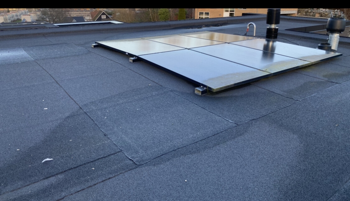

Thorben8126 Feb 2022 14:07In the meantime, I received a response from the local company here in Vejle/DK. They said they simply have no time for any additional projects, so I’m on my own. Crazy.
How realistic is it to set up a basic frame structure (or flat) and 6 to 9 additional panels? I would then hire an electrician for the connection.
I have a fairly large roof area that I could fully utilize, but then I would need to replace the inverter and probably also consider battery storage soon. Feed-in tariffs are practically nonexistent here.

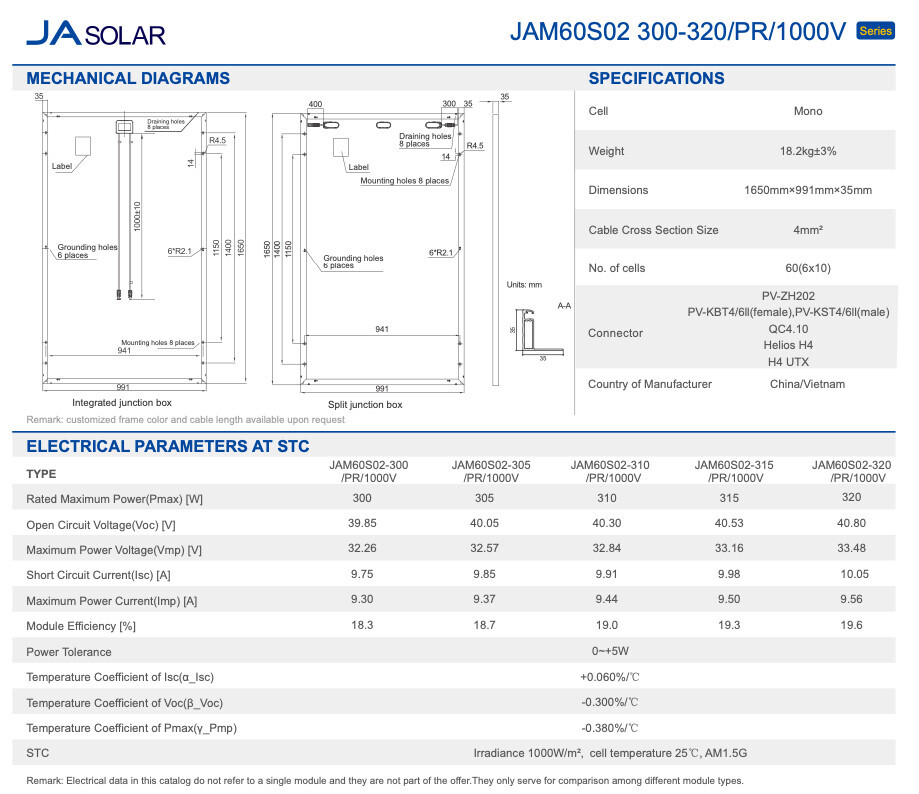

Thorben811 Mar 2022 09:25Hello again.
By now, I have a rough idea of which panels I have. They are from "JA Solar" and belong to the JAM60S02 series. Unfortunately, I don’t know the exact model (300, 305, 310, 315, or 320 Watt). I have quite a large roof area (3 flat roofs at different heights) and could also angle the panels, for example, to increase the “production window” and maximize the inverter’s capacity.
Unfortunately, these JAM60S02 panels are not available anywhere, so I will probably have to sell the existing panels?!
Additionally, I would really like to install a smart meter, either SMA Solar, Fronius, or something entirely different.
The Fronius Primo 3.01 is a single-phase inverter.
What is your first impression?
