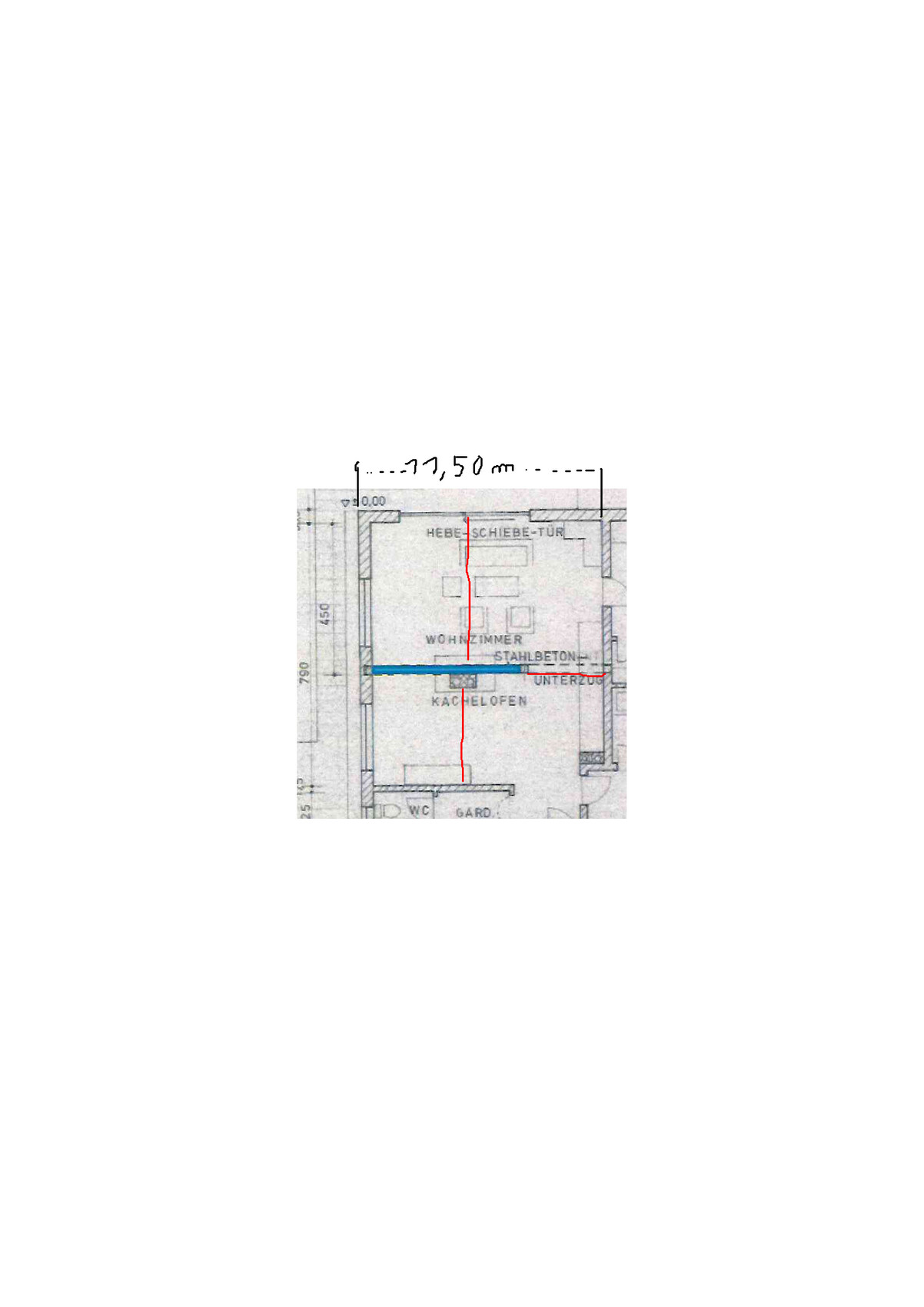

Hello, I am looking for a solution to a tiling problem.
I want to install new tiles (slate) myself in my 30-year-old house.
The tiles measure 40 x 60 cm (16 x 24 inches) and are to be laid on the floor in a third-bond pattern.
In the old tiles, there are three movement joints in the middle of the room.
The room has a U-shape. The old tiles will be removed down to the screed.
The room has underfloor heating.
Two of the joints run perpendicular to the tile pattern.
Problem: movement joints running straight across the third-bond tile pattern.
My idea is to bond a thin waterproofing membrane with silicone over the movement joints directly onto the screed.
I would grind (mill) the screed slightly in the 1–2 mm (0.04–0.08 inch) area where the movement joint will be covered to avoid any raised areas.
After laying the tiles on the waterproofing membrane using C2FT S1 tile adhesive, I would cut through the membrane again along the tile joints near the movement joint.
My hope is that this approach will transfer the straight movement joint to the zigzag (third-bond) movement joint of the tiles.
The tiles spanning the movement joint in the screed would then “float” on a thin silicone bedding.
What are the possible disadvantages of this method, apart from the shear forces in the movement joint that might not be properly absorbed in the tile joint?
Are there any other alternatives to covering the entire floor with expensive uncoupling mats?
I appreciate any constructive feedback.

RotorMotor7 Apr 2022 10:12The floating silicone structure doesn’t sound very durable, if it holds up at all.
I would cut the tiles at that point to realign the screed joint within the tiles.
Try drawing the room and the joints.
Since the wall changes the proportions, I would tile with the joint (that is, parallel) rather than perpendicular. Otherwise, the room would stretch even more in length. That way, you avoid that problem.
As far as I know, there are special systems for this. Check out Schlüter...
