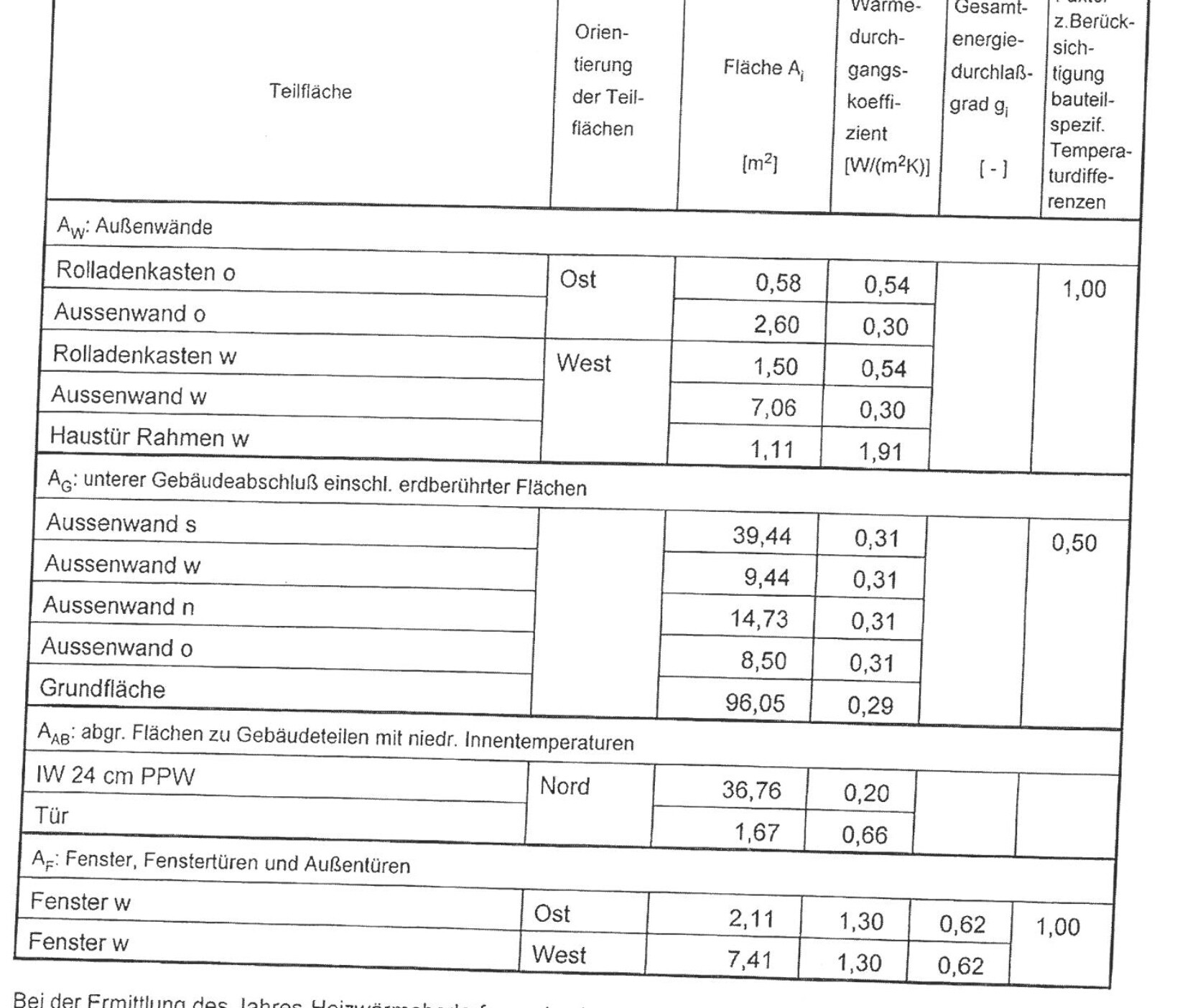

RockyFranco2 Aug 2020 23:20calculated by the planner back then.
heat transfer area 230 sqm (2475 sq ft) volume 222 km (138 miles)
annual heating energy demand 4015 kWh/year
calculated insulation attached
actually billed in electricity_heat (i.e., heating + hot water)
basement with 70 sqm (750 sq ft) uses 3000 kWh
living area with 200 sqm (2150 sq ft) uses 10,100 kWh
enormous.
ok, we actually don’t want to heat the basement anymore. At most, run the ventilation system there, should be feasible with a timer switch.
residential ventilation likewise with a timer or manually activated if bathroom is damp or wet. Otherwise off.
then gas + solar thermal for hot water is probably cheapest
or wood pellet + solar thermal for hot water
or ground source heat pump + solar thermal for hot water
the main thing is I don’t want mold in the house.
I think in 20-25 years the three kids will have moved out. The investment should be amortized after 20 years.
taking into account current subsidies and rising electricity prices, maybe even sooner
enormous.

Living area with 200 m² (2150 sq ft) using 10,100 kWhOh dear, even with a new heating system, the heating costs will be high.
Perhaps better insulation could be achieved through insulating the attic floor or other measures to reduce energy demand.
T_im_Norden3 Aug 2020 08:03The high costs are likely due to the concept of exhaust air heat recovery and the associated supply air openings for all rooms in the external walls. This usually works with passive houses but not with a "3-liter" house, which probably corresponds more to a KfW 70 standard.
Tassimat schrieb:
Oh dear, even with a new heating system, high heating costs will occur.
Maybe better insulation could be achieved through attic floor insulation or other measures to reduce energy demand.Honestly, I don’t see that here. The annual energy demand of 13,000 kWh is actually very low and comparable to new build standards.
