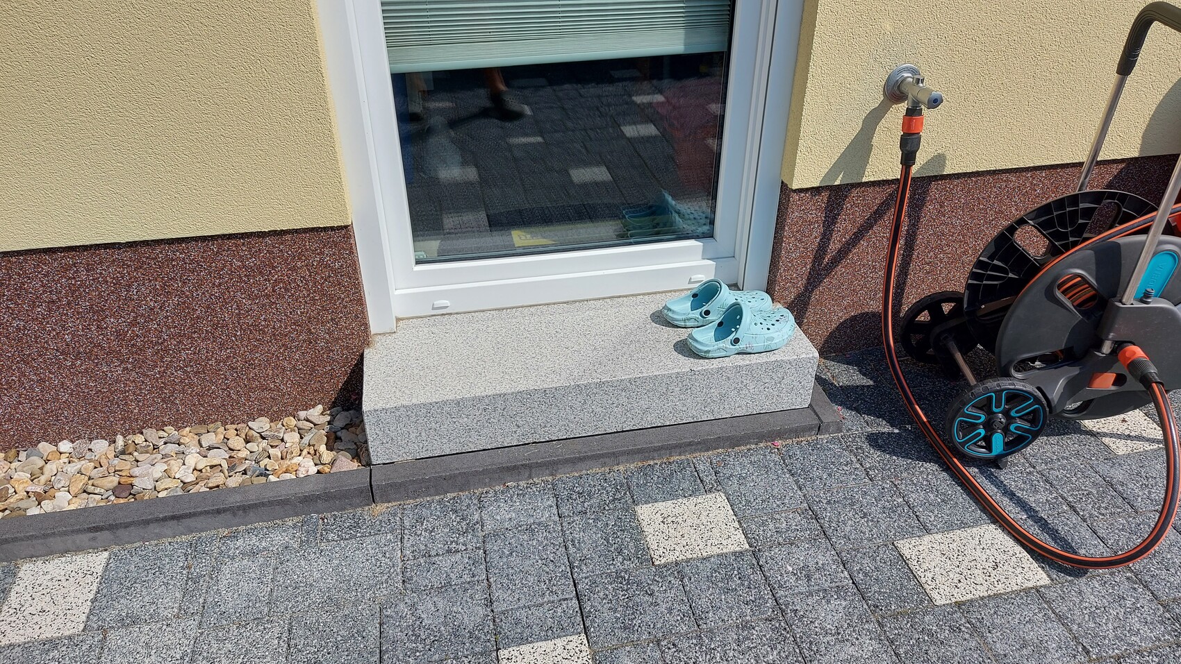

motorradsilke28 May 2023 08:44What will be placed on the outside there?
What do you plan to put in front of the XPS insulation on the outside? You can’t just leave it exposed.
As Yvonne mentioned, usually there’s a terrace there, or a step if no terrace is planned directly at the house or not at all doors.
We built steps from granite stones at those exits because we didn’t want a terrace directly at the house. For the fixed glazing, our general contractor installed a windowsill, the same as the ones on the higher windows.
However, this was done independently of the plasterer, who applied the plaster as usual, and then we added the windowsill afterward.
