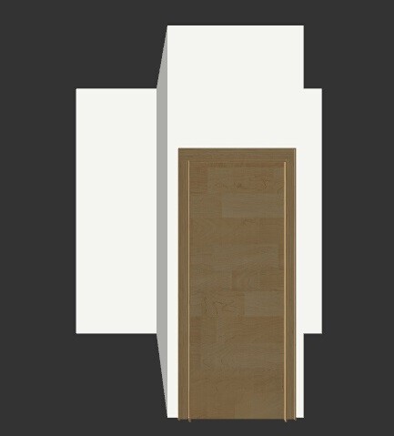

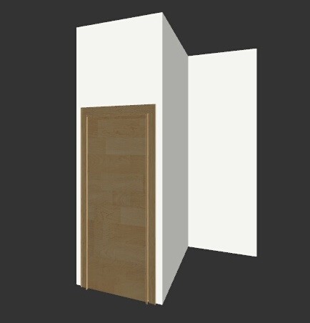

This will be located in my home office, meaning I plan to install two drywall partitions perpendicular to an exterior wall to create a niche about 1m (3.3 ft) wide and 1.5m (5 ft) deep. Currently, the office has a glass door, as I would like the equipment to be visible. The wall extensions that form the side walls of this “room” will stand free in the space. It looks approximately like in the attached pictures. Of course, I could also place the rack freely in the room, but I want to avoid visible cables and aim for as quiet an environment as possible.
