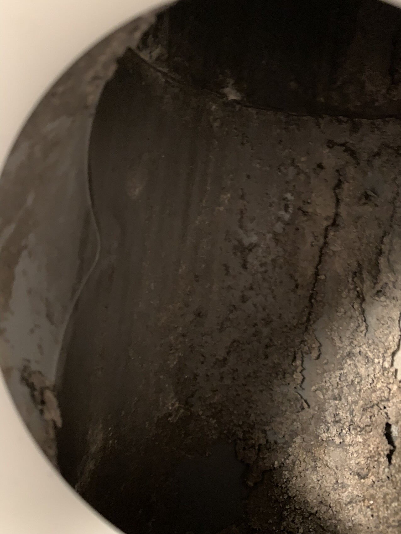

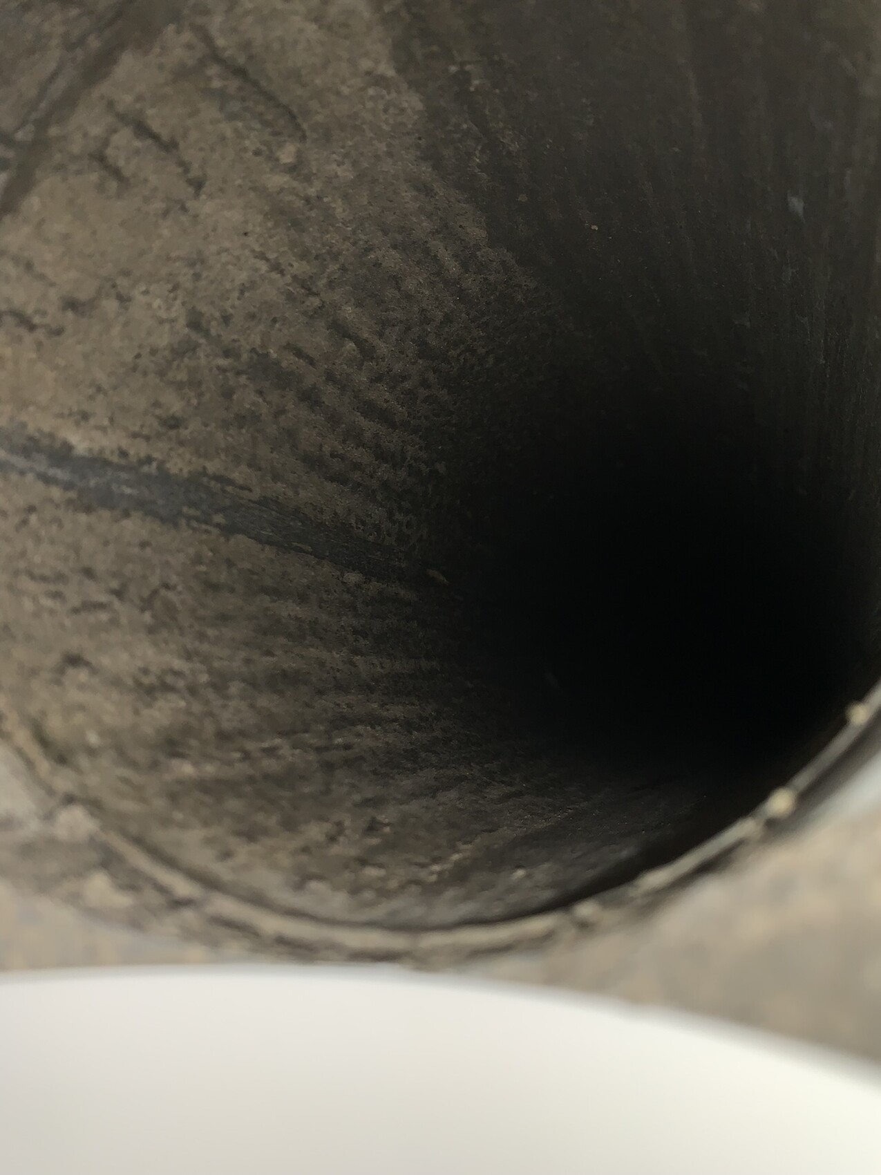

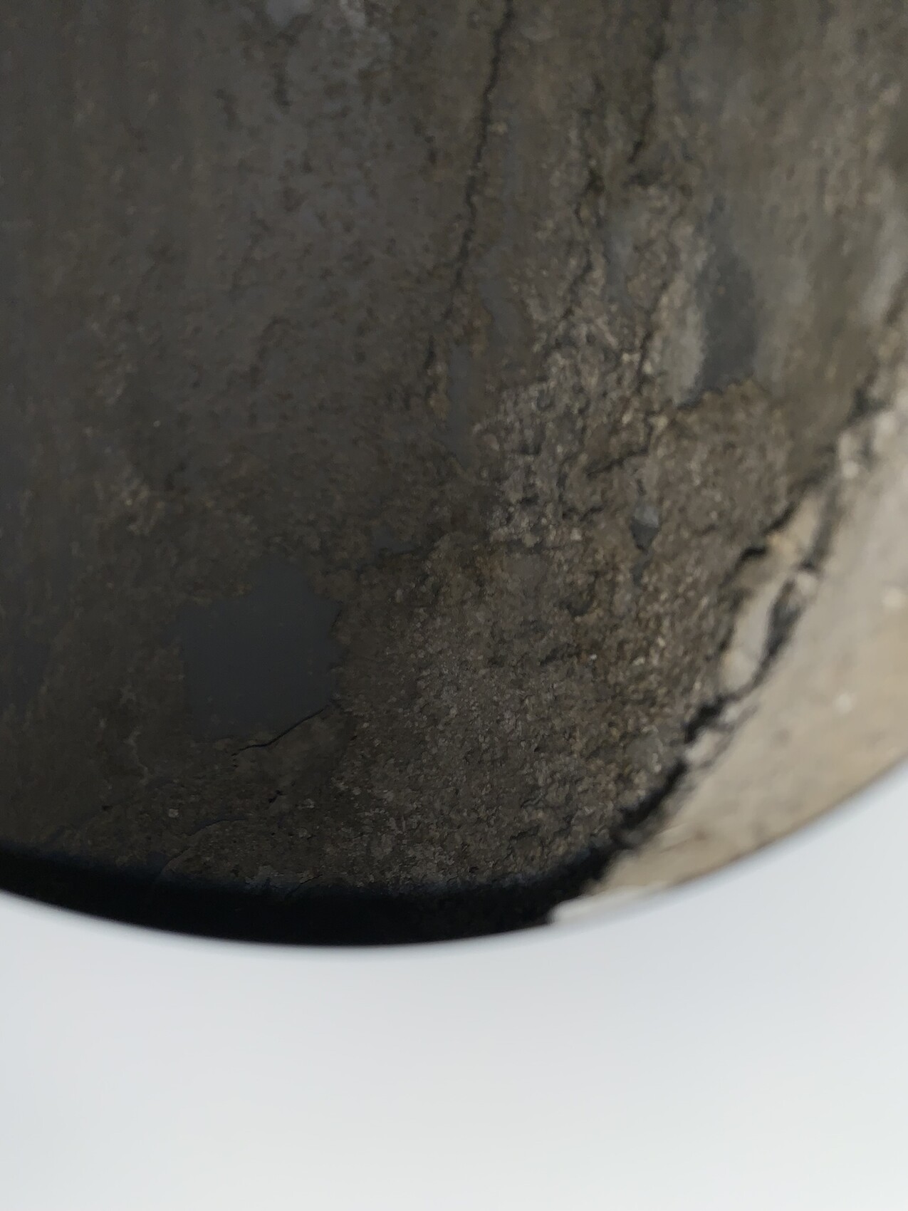

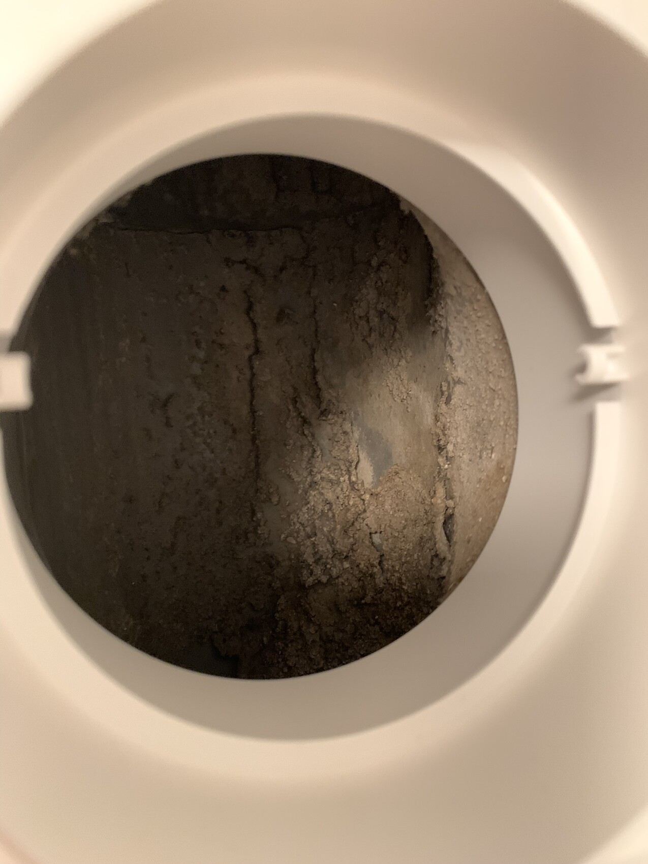

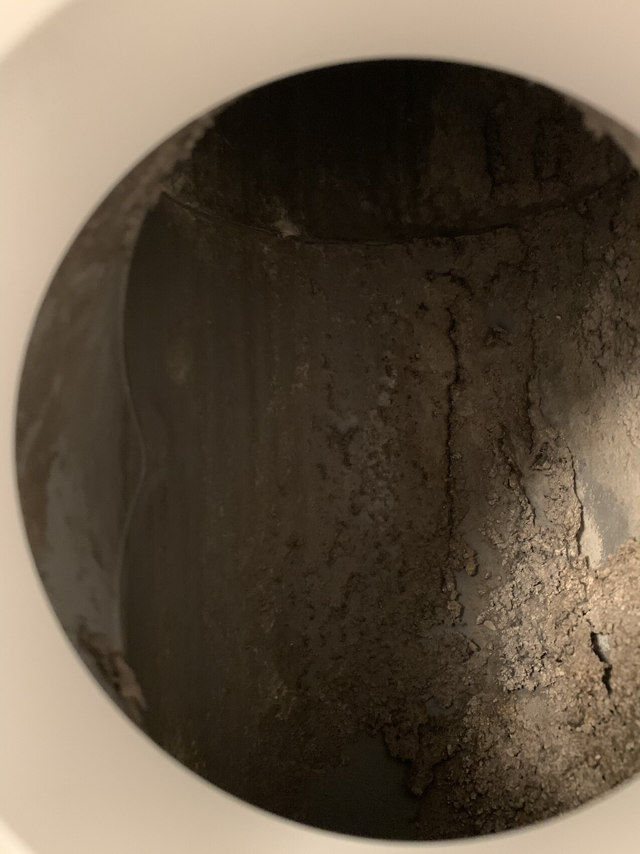

vinyl-66Hello everyone,
While replacing the ventilation in my guest bathroom, I noticed a strange coating on the inside of the pipe. The pipe itself appears to be made of plastic. However, inside there are cement-like remnants. These are gray, porous, and unevenly distributed. I am now concerned whether this material stuck to the inside of the pipe could contain asbestos.
The house was built in 1978. I am not sure if this area has been renovated.
Could someone possibly tell me what this material might be and why it was applied? Should I have it inspected?
Thanks in advance for your help.
Pictures are attached.
David
David

Jesse Custer26 Nov 2023 17:54Please forgive me, but I believe this is simply rubbish...
J
Jesse Custer26 Nov 2023 18:12Asbestos is a fibrous silicate – so it should look different from the outset...
I would consider this to be a deposition of sludge formed from dust and condensate.
Jesse Custer schrieb:
I thinkJesse Custer schrieb:
that should11ant schrieb:
I would … considerI do not consider asbestos and mold assessments, as well as structural analysis and load-bearing capacity, suitable based on photo inspections.Those I cited share this view and do not provide a definition.
Therefore:
vinyl-66 schrieb:
Should I arrange an inspection?Carefully remove a small sample and send it to a laboratory. Which one and where can be found by searching online.
