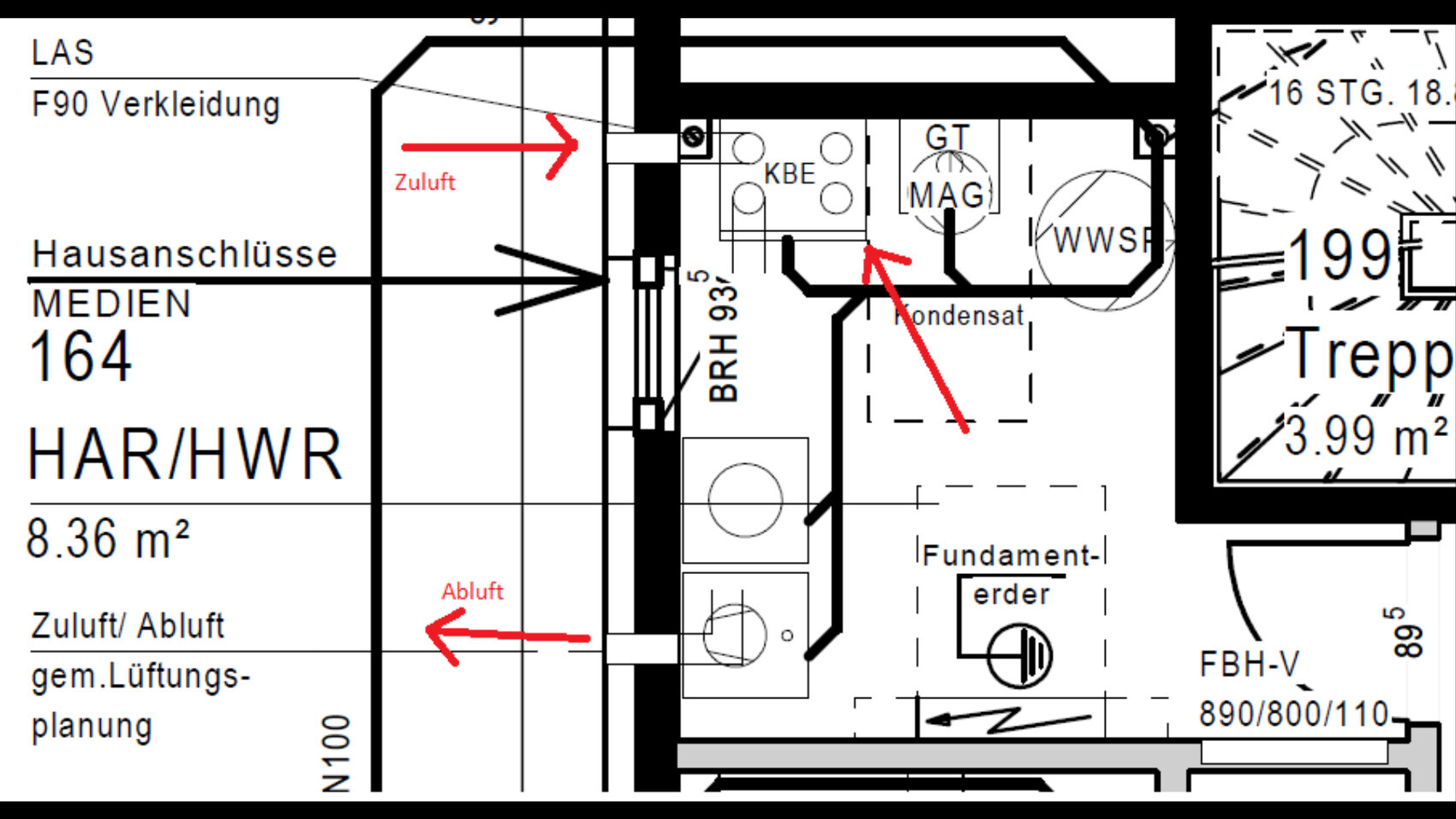

we are just about to submit our building permit / planning permission application. I still have some concerns about the ventilation system.
My architect says that the exhaust air can be installed low and the supply air above it, with a 2m (6.5 ft) distance between them.
My worry is that the stale air, which is known to rise, might be drawn back in.
Are my concerns justified, or is this not an issue?
Alternatively, the exhaust air could run along the ceiling to the far end of the room. However, that would probably take up shelf space and is less compact.
Routing around the corner is not possible since the room is centrally located.
Thanks in advance for your opinions.
Christopher

For me, the only remaining question is: why do you want to do it differently than planned? The mechanical ventilation system with heat recovery (in your case KBE) belongs in a small utility room, mounted on the ceiling or hanging on the wall. That way, the ducts don’t take up much floor space, except where the unit itself is installed.

The plan was for the ducts (supply/exhaust air) to run above and below the system. What is shown on the plan is what I have designed. Both options are possible.
I am now simply looking for the ideal solution, considering all eventualities.

The plan was for the ducts (supply and exhaust air) to run above and below the unit. The way it is shown on the plan is how I designed it. Both options are possible. I would do it as shown on the plan (with the ducts hanging from the ceiling in the utility room, so the outlets on the exterior are positioned high enough).
