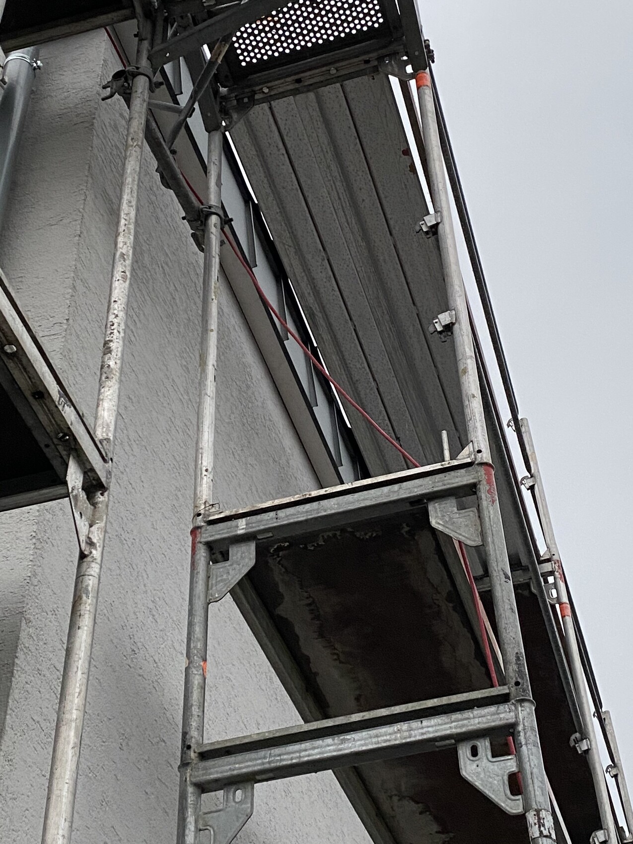

So the roof has been renovated with a U-value below 0.14, qualifying for subsidies.
The parapet itself is not directly attached to the facade; there is a sub-layer board underneath. Perhaps there is enough space there for the required insulation?
You can kind of see this in the picture.
Does a facade like this need to be replaced eventually? Or is it enough to just repaint it every few years?
We do have some small cracks, but these are not visible from a distance greater than 2 meters (6.6 feet) and are mainly limited to the window areas.
