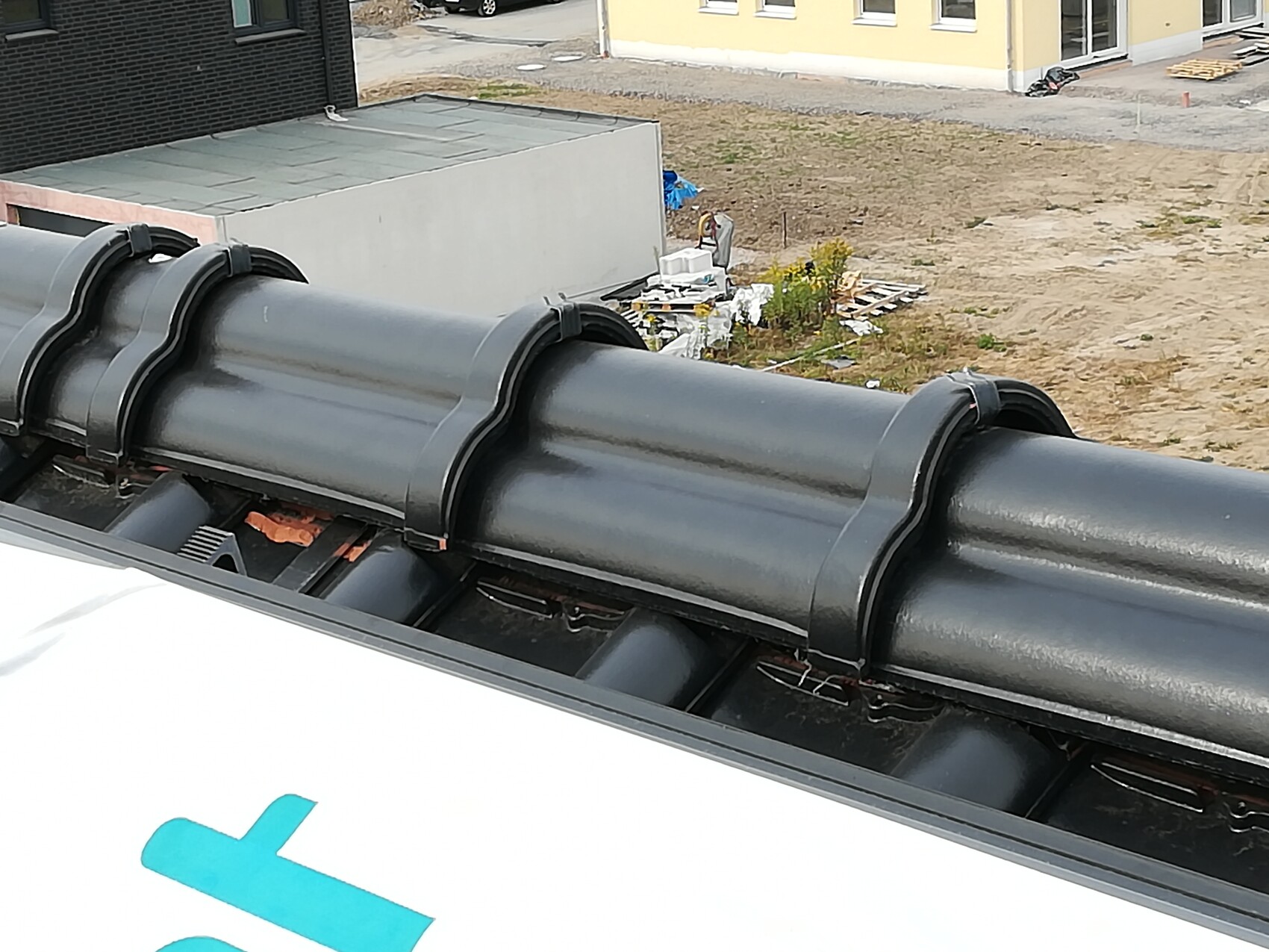

Bachi13Hello everyone,
after the roof covering was completed, the solar panels were installed directly under the roof ridge by the building services technicians. In my opinion, the ridge tiles and the ridge flashing were not properly removed and reinstalled for this work.
The ridge clips were bent open to remove roof tiles, and the adhesive ridge flashing was torn off. After installing the panels, the ridge flashing was roughly pressed back behind the fold.
The ridge clips were somewhat bent back after the ridge tiles were put back in place.
As a result, the ridge tiles are now much looser than before and can be moved sideways.
I have already raised this issue with the main construction company, and in response, the clips were hammered from above once again to bring them closer to the tiles. In my opinion, this was only moderately successful.
Question: Is it acceptable for ridge clips to be bent open and closed again, and is it okay if the ridge flashing is only partially adhered in front of the fold?
Thank you for your advice!
Bachi
