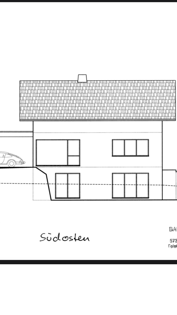

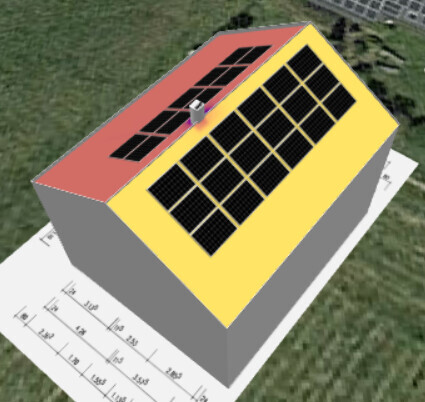

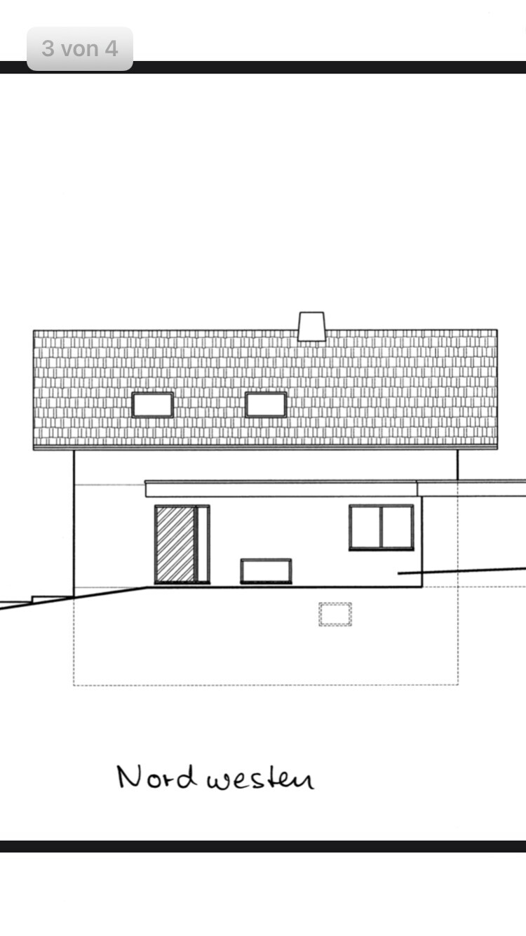

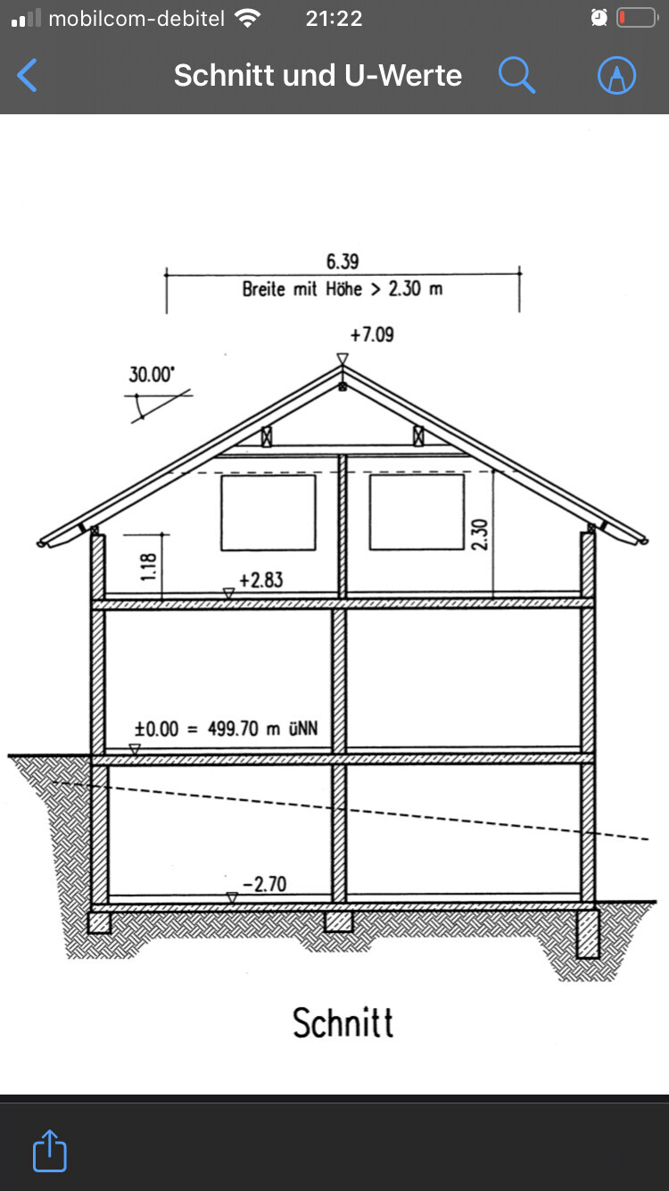

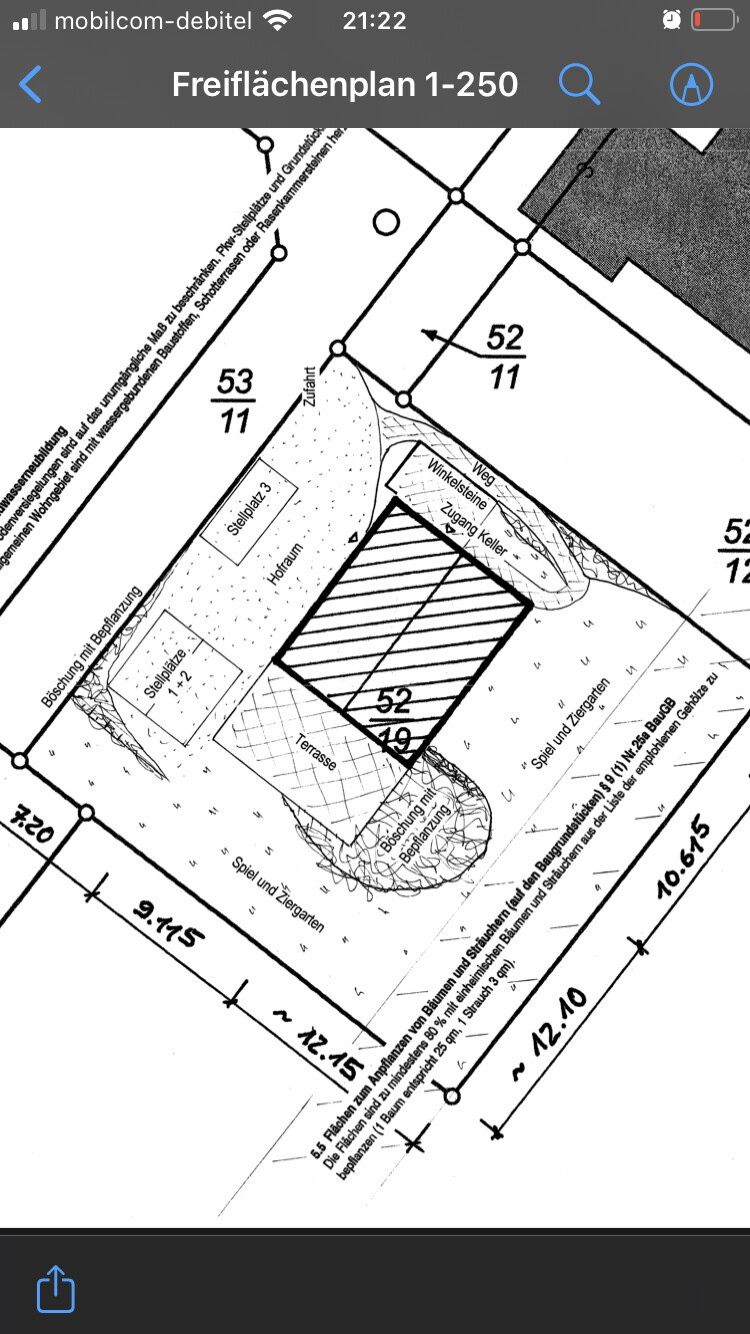

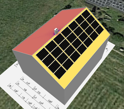

The layout is not fixed yet. It was initially offered only for the southeast side, and upon my inquiry, it was also offered for the west side. I would arrange it a bit differently anyway. It is important for me to know how many modules to install and how many on each side.
Attached are a site plan and the layout proposals. North is at the top.

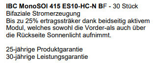

For us, there is a 25-year product warranty and a 30-year performance warranty – I have to admit that I didn’t quite understand the exact difference.kati1337 schrieb:
We have a 25-year product warranty and a 30-year performance warranty – I have to admit, I’m not exactly sure what the difference is.
The product warranty covers defects that may occur during manufacturing.
The performance warranty guarantees that the output will not fall below 80% of the rated capacity during the 30 years. I believe the performance is expected to decrease by about 0.7% of the rated capacity per year.
