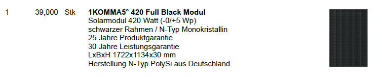

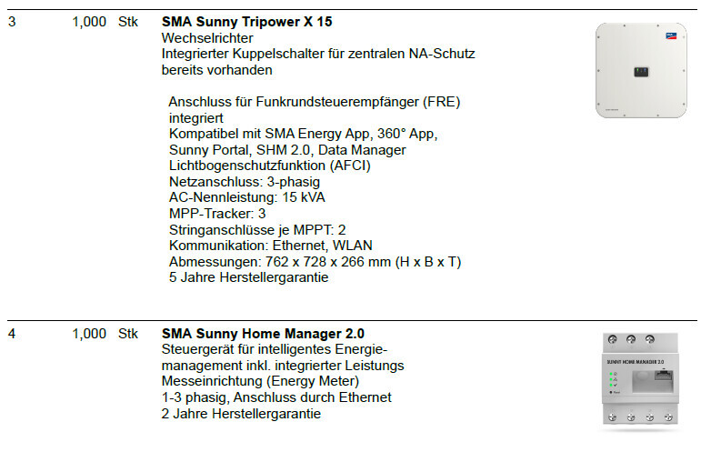

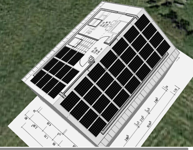

Based on your feedback, we have revised our system once again. The battery storage has been removed, there are slightly different modules due to delivery issues, and the system has become significantly larger:
39 instead of 28 modules (1.5° instead of IBC)
Larger inverter (SMA Sunny Tripower instead of Sungrow Hybrid)
What do you think? Does it look good now?

hanghaus202316 Oct 2023 15:06I would not replace the hybrid inverter in case a battery storage system is added later.
Dachshund9016 Oct 2023 15:09hanghaus2023 schrieb:
I wouldn't replace the hybrid inverter in case a battery storage system is added later. The system probably grew too large for that; the inverters that also support storage supposedly can't handle it. At least not the offered inverter. You would need two anyway.
Dachshund9017 Oct 2023 14:24Hello,
So, is everyone okay with the system and also the "new" components? If so, I would probably go ahead and order it that way 🙂

RotorMotor17 Oct 2023 14:32Just the question of why there is still one corner left empty?
