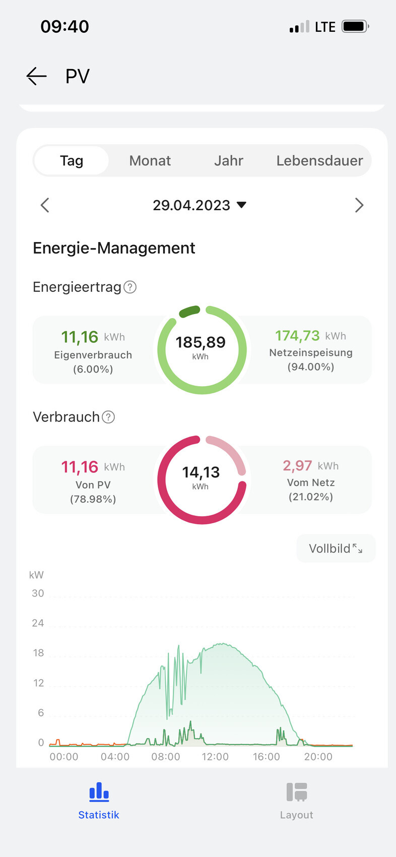

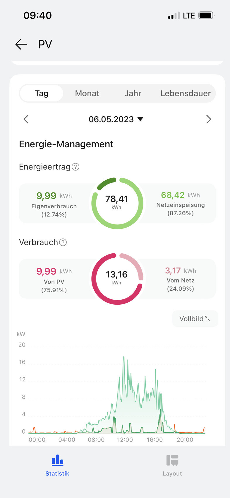

I can’t provide long-term experience yet, but this is the current situation for us:
37.4 kWp installed module capacity. East/West orientation.
This means only 50% of the panels are ideally exposed to sunlight.
Both roof sides are fully occupied.
The highest output occurred on lightly cloudy days, reaching up to 27 kW due to reflection.
We don’t have a storage system. Now in April/May, the system produces so much electricity that we still draw about 20-30% of our power from the grid.
Our daily consumption in spring is between 8 and 14 kWh (KfW40 standard).
Between 6 a.m. and 7:30/8:00 p.m., the system basically covers the entire electricity demand. (Northern Germany)
We paid around 1,150 EUR net per kWp at the end of 2022.
The images show heavy cloud cover and rain (May 6) as well as sunshine (April 29).
