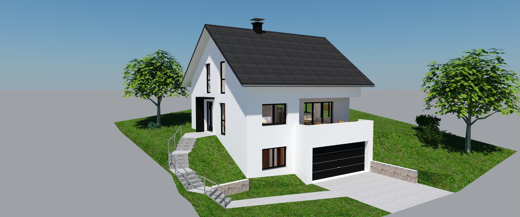

hanghaus200014 Oct 2021 13:55Arango18 schrieb:
I still need to upload that as well, but yes, the terrain slopes in that direction. I sketched it out. The garage driveway and entrance are on the same contour line but are a floor apart. Something doesn’t add up. Does the driveway slope downhill? I wouldn’t plan it this way given the slope. Are there any sectional drawings or elevations available yet?
hanghaus2000 schrieb:
I sketched it out. The driveway and entrance are on the same elevation line but are one floor apart. Something won’t work here. Does the driveway slope downwards? I wouldn’t plan it this way given the gradient. Are there any cross-sections or elevations yet? Unfortunately, there aren’t any yet, or at least I don’t have them.
It is true that significant fill will be needed at the entrance on the left side of the house. We hope to use the excavation soil for this, according to the architect’s plan. The neighbors did something similar.
Where do you see the biggest issues, and how would you approach this?
Attached is just a 3D view from the northwest perspective.
hanghaus200014 Oct 2021 14:08Has the eastern neighbor already built their house? Then pictures would be helpful.
As the simplest solution, I would swap the garage and the office. This way, you gain at least 1 meter (3 feet) and won’t need 20 steps up to the entrance.
hanghaus200014 Oct 2021 14:31How tall is the neighbor's house to the west? What is the view into the valley like? It might be better to move the house northward along the contour line. This makes the driveway to the garage a bit longer (resulting in less slope), and the neighbor to the south is also farther away.
Is a ridge direction parallel or perpendicular to the road required?
How tall is the neighbor to the west? What is the view like into the valley? It might be better to shift the house northwards along the contour line. This would make the driveway to the garage somewhat longer (thus less slope). Also, the neighbor to the south would be farther away.
Is a ridge orientation parallel or perpendicular to the road required?There is no neighbor to the west, we are the last property, and the view into the valley is unobstructed.
Shifting the house north is certainly possible, but I expect it would increase the earthworks costs, or am I mistaken? Although we would need the excavation material for filling anyway, probably not the entire amount needed…
The ridge orientation on our site is parallel to the road but can generally be chosen freely.
