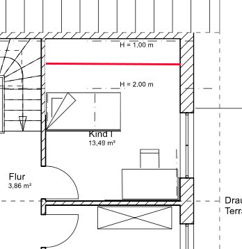

On the upper floor, I would skip the entrance alcoves for the bedroom and bathroom. In the bathroom, you could definitely experiment a bit more with the layout of the fixtures.I had the same thought, although I’m a bit concerned that the rooms might then become too small. However, I would, of course, make the hallway a bit nicer and wider in return…
hampshire14 Oct 2021 13:33You don’t lose any usability or visual spaciousness by adding the square meters to the hallway. In fact, you gain enough space there to comfortably pass each other without playing evasive Tetris.
Myrna_Loy14 Oct 2021 13:33Myrna_Loy schrieb:
I would plan built-in wardrobes and shelves under the sloped ceilings in the children's room. Kids don’t need wardrobes that are 2.20 m (7 ft 3 in) tall.I think that’s a great idea.
hampshire14 Oct 2021 13:36Myrna_Loy schrieb:
I would plan for built-in wardrobes and shelves under the sloped ceilings in the children's room right away. Kids don’t need wardrobes that are 2.20 m (7 ft 3 in) tall.Plan them but only install when the children are a bit older and the wonderful cozy niche for playing has lost its appeal. Our younger son once sleepwalked onto a 2 m (6 ft 7 in) Pax wardrobe when he was in elementary school and played Lego up there; maybe something taller would have been better...
