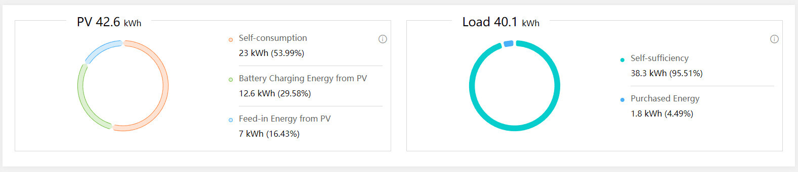

I know that battery storage often gets criticized, but we have had ours running for three weeks now, and I have to say it is definitely worthwhile for us.
At the beginning, I did all the calculations, comparing the purchase price with the warranty, and then worked out how many cycles per year would be needed to break even within the warranty period. The number of cycles I calculated was already a rather conservative estimate for us — so I believed the chance of not reaching that was low.
It is currently late summer, the air conditioning is running, the car is charging, and there is no question of the battery not emptying. We manage to fully discharge it every night, and also fully recharge it every day.
We are curious to see how winter will be — especially since the demand for the air-to-water heat pump will increase. At the moment, it is only heating water, so the air conditioning is off. Whether the higher load and lower efficiency will mean we can no longer fully charge the battery remains to be seen. For now, the battery is already full by noon, so there is still plenty of room.
Even if there are fewer cycles in winter, I am optimistic for three quarters of the year.
