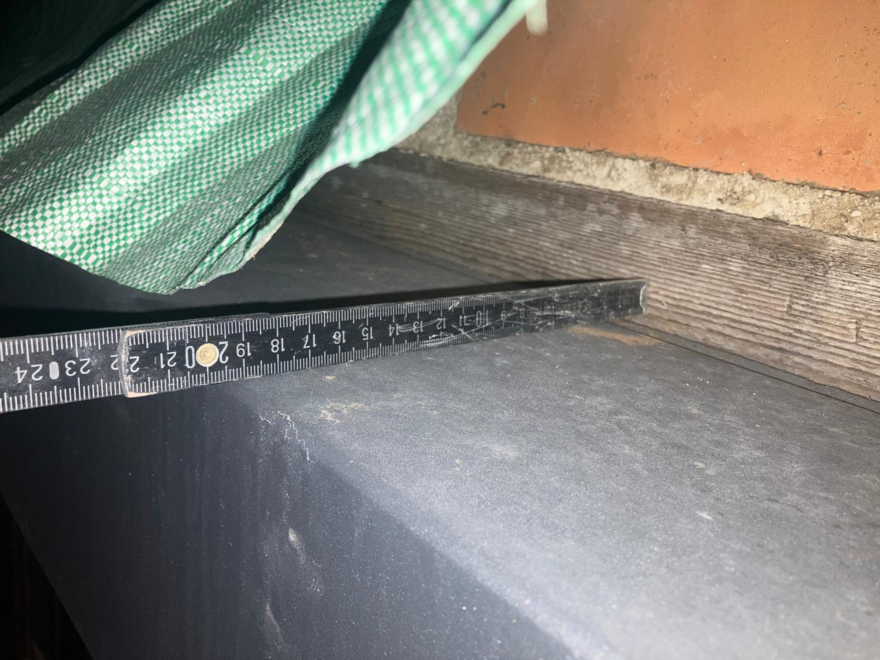

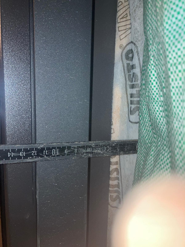

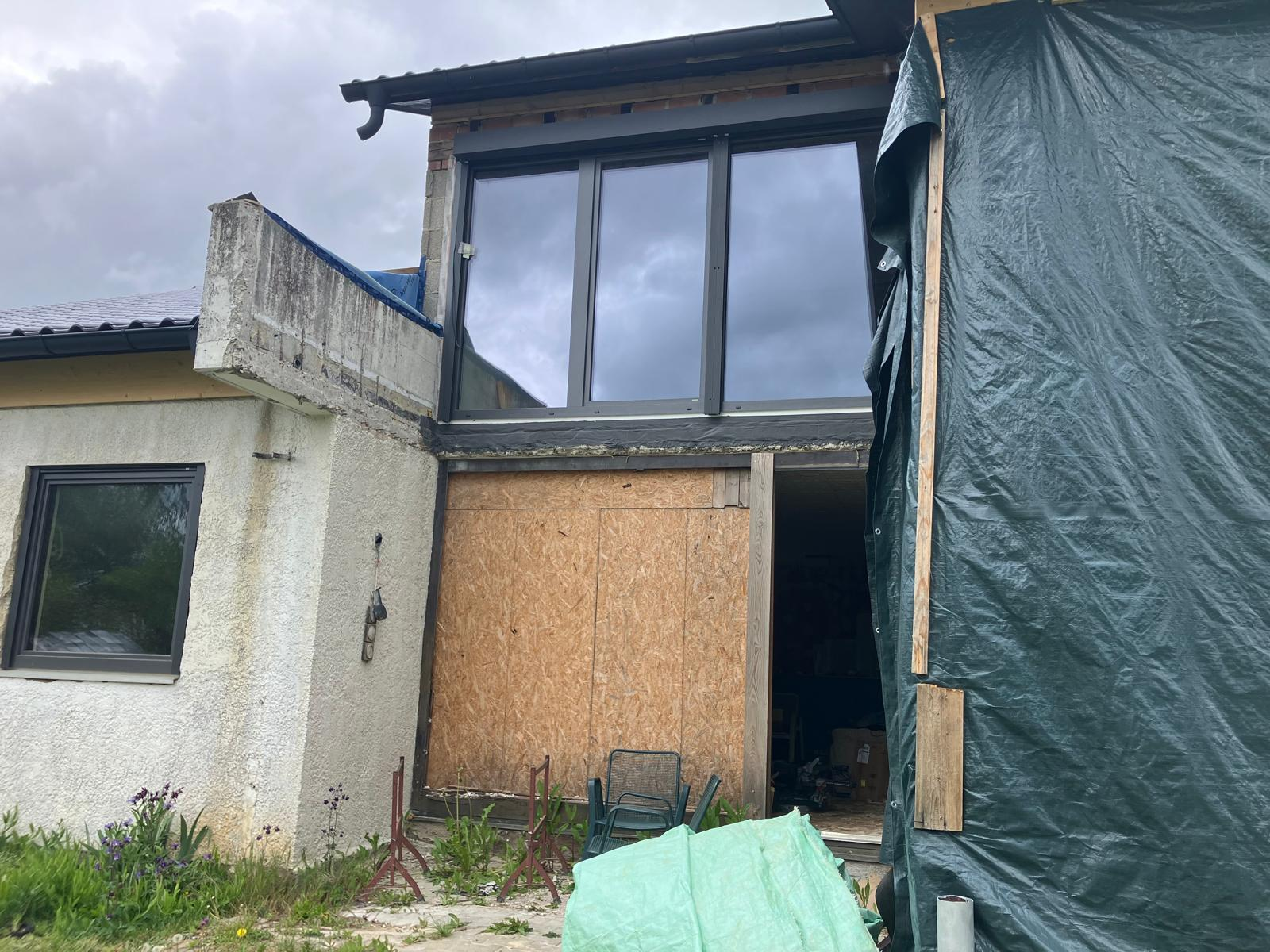

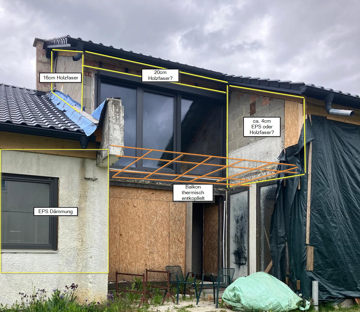

I’m interested in how you would best integrate my new balcony window into an ETICS system (external thermal insulation composite system). I may need to deal with different insulation thicknesses due to varying distances. Would you fully insulate the roller shutter box or insulate it about 20cm (8 inches) above to create a drip edge about 1cm (0.4 inches) wide?
At the right corner, the distance from the wall to the outer edge of the roller shutter guide rail is 12cm (5 inches).
I have planned the rest of the facade construction as follows:
- Upstanding wall on the roof surface with 16cm (6.3 inches) wood fiber insulation. Background: The roof was fully covered with wood fiber insulation above the roof deck. My carpenter has already made a neat connection for the facade insulation on the upstanding walls, so I want to continue using wood fiber here.
- Main surfaces, here I want to switch to EPS insulation, since the cost of wood fiber is a bit discouraging.
- Side wall next to the roller shutter (12cm (5 inches) distance), as mentioned, I can probably only insulate with 4cm (1.6 inches) here. For this reason, and due to its better insulation value, I would switch to EPS here as well.
Would you use EPS or a similar material entirely around the window area?
The balcony will be thermally separated and attached to the facade on the right and left by steel beams. What does such a mounting look like on an ETICS facade? Are there mounting modules or similar solutions available?

The 12cm (5 inches) on the right side is actually already an indication that you shouldn’t just apply the same insulation thickness everywhere without consideration. That’s exactly where those odd transitions often appear later, making you wonder after three years why the corner always looks different or gets dirty faster. You often see this with balcony windows installed later on.
Personally, I would fully wrap the roller shutter box and avoid creating an artificial drip edge—unless you have a clean structural finish planned. That 1cm (0.4 inch) protrusion often seems perfectly reasonable on drawings, but in reality, dirt tends to collect there and water still flows where it shouldn’t. If you extend the insulation 20cm (8 inches) above and work carefully with reinforcing mesh and a finishing profile, it usually lasts longer. Provided, of course, that the access for maintenance on the shutter box remains possible—surprisingly many people forget this.
For the 12cm (5 inches) on the right, I would probably choose insulation thickness of around 8 to 10cm (3 to 4 inches), so the guide rail is not completely covered but still properly insulated. Visually, a flush finish up to the rail usually looks nicer, but technically you need to check how much space is left for the plaster build-up and movement joints. Too little space looks neat at first but typically cracks over time—typical for new construction.
What does the rest of the facade build-up look like, or what insulation thickness is planned for the main surface? This is actually almost the most important information because otherwise you might optimize one detail while creating the real thermal bridge elsewhere. Especially above the lintel, work is often sloppy, even though temperatures there can later be 2-3°C (4-6°F) lower than expected.

Hello Nauer,
thank you for your reply. The revision of the box would be lost with full insulation. The same should apply to the roller shutter guide rail if I cover it over, right? Is integrating the roller shutter guide a common solution?
On the left side of the upward wall on the roof surface, I want to insulate with 16cm (6.3 inches) wood fiber. Background: The roof was completely insulated with wood fiber insulation above the rafters, and my carpenter has already installed a clean connection for the facade insulation on the upward walls, so I would like to continue working with wood fiber here as well. Do you see it as problematic if I then continue around the balcony window with EPS / Styrofoam? (Due to the better insulation value at the low insulation thickness).
The balcony is to be thermally decoupled and mounted with steel beams on the facade on the right and left sides. How is such a mounting handled on an ETICS / external insulation facade? Are there mounting modules that go through the insulation or something similar?
