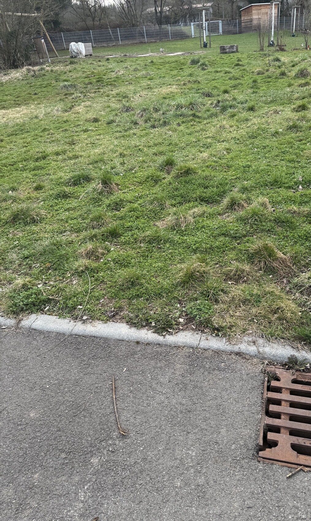

I had already pointed this out in your private road thread, advising you not to be so passive in resolving this It has been done, it will be a public road and was approved by the municipal council. On site, we found a manhole cover (correct?). The photo shows the view from the cul-de-sac.
Building a (underground) basement on a flat plot There is a desire for a basement without a bathroom or toilet – but with a washing machine. That might be critical and could require a sewage lifting station, or is that used only to pump wastewater away and prevent backflow?
It is intended as a clear utility basement with a sports room, technical room plus washing machine, and storage space.
D-Zug88 schrieb:
It has been done, it will be a public road and was approved by the municipal council. On site, we found a manhole cover (correct?). The photo shows the view from the cul-de-sac. The parallel street with the roundabout as well

Is the plot really level, or is the photo just taken at an angle?
D-Zug88 schrieb:
It has been done, it is a public road and was approved by the local council. On site, we found a manhole cover (correct term?). The photo shows the view from the cul-de-sac. This looks like a properly constructed street ready for billing, so there must be more than just surface drainage. The photos support the assumption of a flat plot (which means that building a laundry room and a utility space between the foundation slab and the ground floor will probably cost you at least around 70,000 (currency) extra, even if you plan to do the tiling yourself). Quite a lot of money for the convenience of going one floor down to do laundry. From the above-ground utility room, you can save yourself the need for a sewage lifting station, and a clothesline will also fit in the garden. The others at the gym start with only a few plates too, so keep at it!
