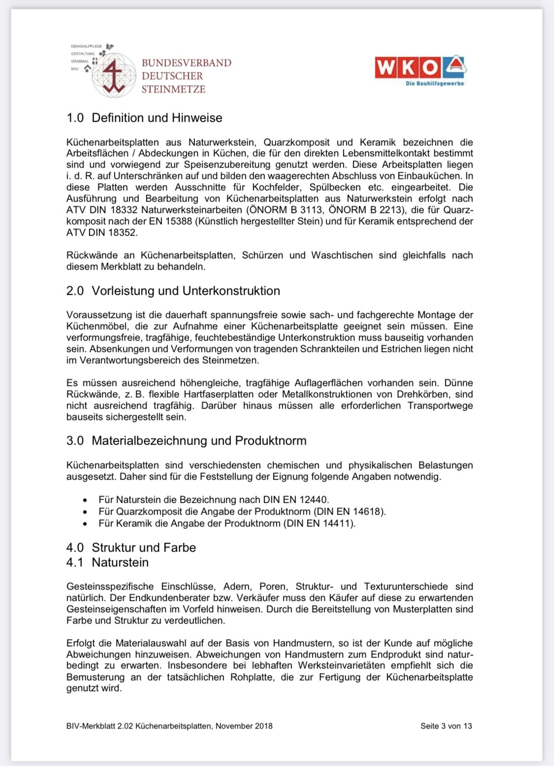

Myrna_Loy28 Mar 2022 13:47driver55 schrieb:
Natural product or not. That would not be acceptable to me, and they can take the slab back.
Is the kitchen already fully paid for? That would probably be the only leverage to insist on a replacement.If a specific grading or selection was not contractually agreed upon at the time of ordering and sampling, the customer will hit a brick wall. In that case, the seller can calmly refer to the DIN standard for natural stones.B
