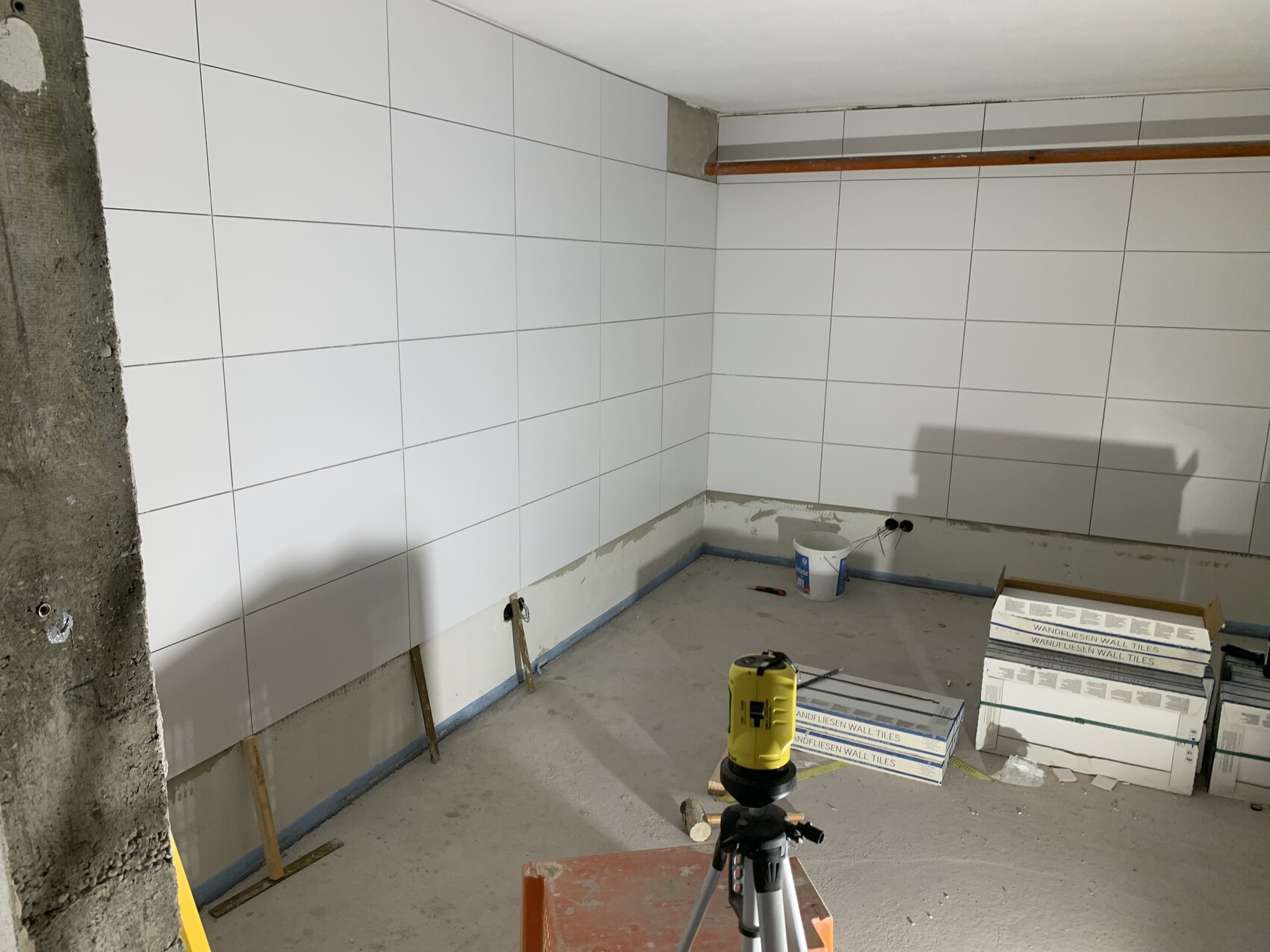

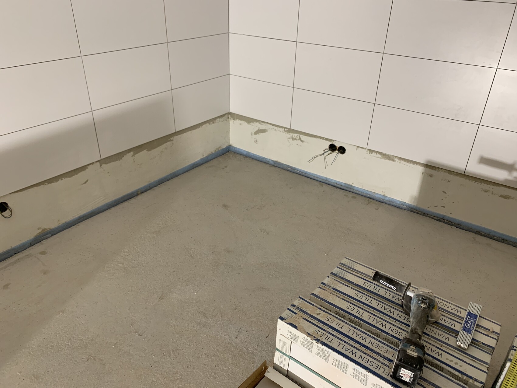

At the moment, I am working on renovating the basement. We excavated all the old concrete, paving, and natural ground. A new concrete slab was then poured (10-15cm thick) and connected to the foundation with steel bars. On top of that, a polyethylene vapor barrier was installed, followed by a concrete screed (industrial quality). The individual rooms and walls were separated from the screed by perimeter insulation strips.
Now I want to create a cove fillet on the wall with epoxy resin and then coat the entire floor with epoxy resin.

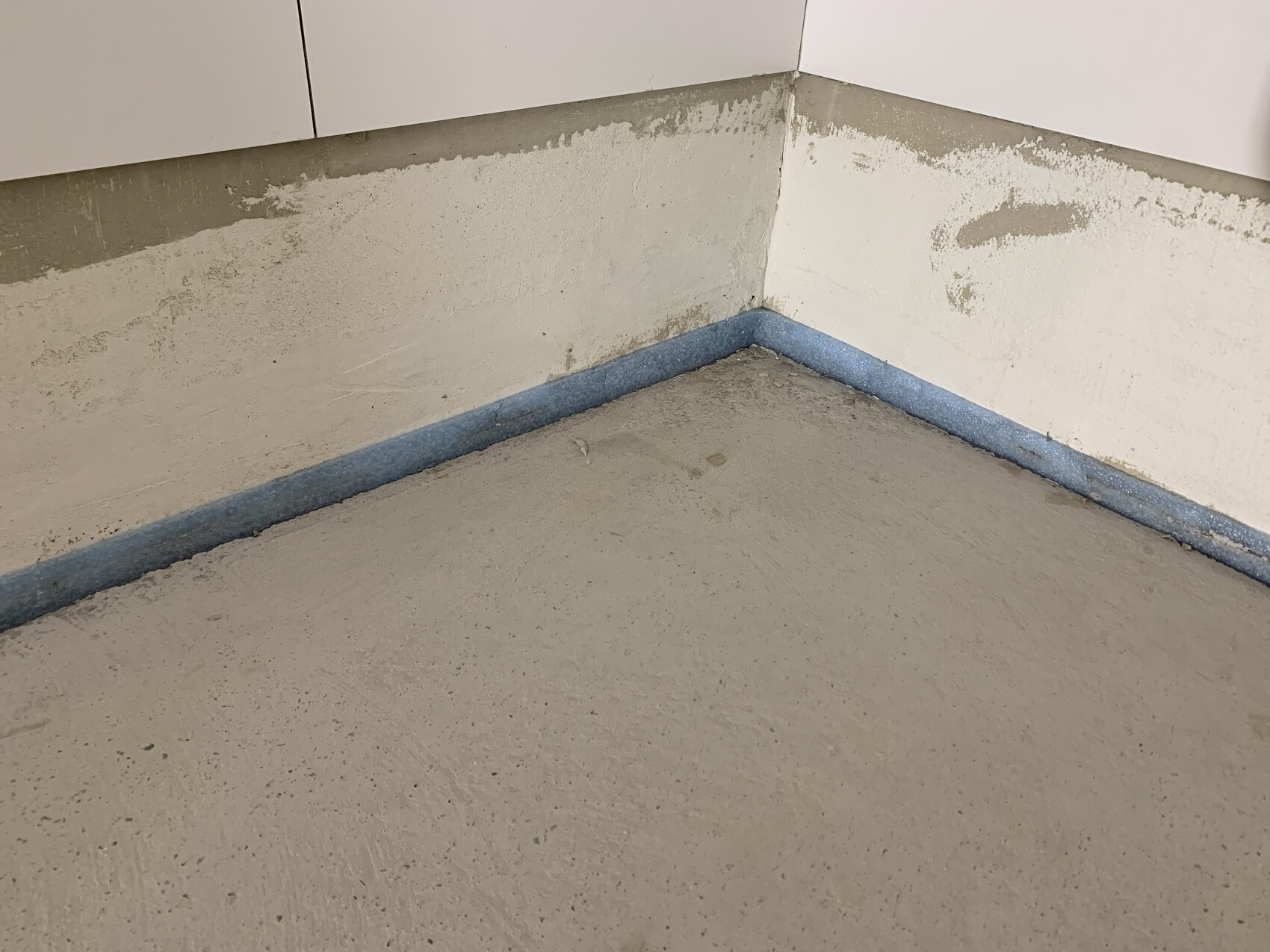

I have heard that the cove fillet should be applied onto the edge insulation strip. However, I have the problem that the edge insulation strip and the tile covering are already flush, and I do not want the cove fillet to protrude. In addition, the edge insulation strip is damaged in some places due to grinding the concrete.
Can I cut off the edge insulation strip and install a new strip with lower thickness to separate the cove fillet, floor, and walls, so that the cove fillet is flush with the tiles? What material should this strip be made of so that the epoxy mortar bonds well?
Can the strip be glued to the wall? If yes, what adhesive should I use?
Or do you have any other suggestions? I would be very grateful for your tips!

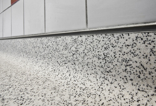

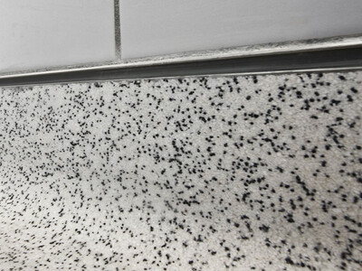

Furthermore, cove fillets can be manually shaped with appropriate forming tools, or prefabricated profile elements can be embedded into the base layer of the screed or concrete. These profiles can then be coated, or better: a color-matched sealant is applied by rolling the outer surface in the exact same shade as the floor.
With floating screeds, the profile is glued only to the floor, not to the wall.
Now an informed layperson might ask: how is it possible to make this so watertight that the vertical leg does not allow water to run behind it?
Good question. No current professional standards or guidelines address this issue.
My own solution, used in many industrial projects, is to apply a strip of swelling paste to the back side of the cove profile before installation. This paste automatically seals any water ingress by significant swelling.
Alternatively, a swelling tape can be placed behind the profile element, for example "TPH Hydrotite SS0330".
The upper edge of the cove profile is then simply finished with an elastic sealant for visual closure. Acrylic or silicone sealants cannot provide long-term waterproofing, but in this described approach, they do not need to.
This method was implemented several years ago in a wet area of a building in Berlin according to my specifications—and it still performs reliably today!
