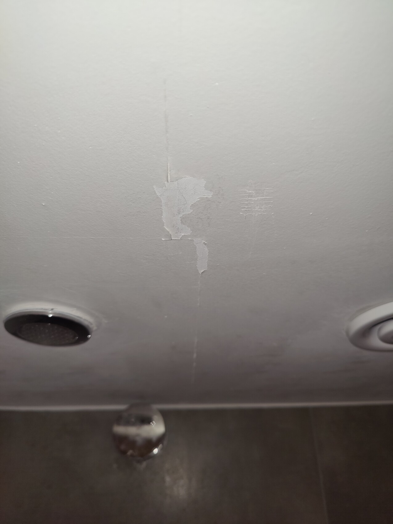

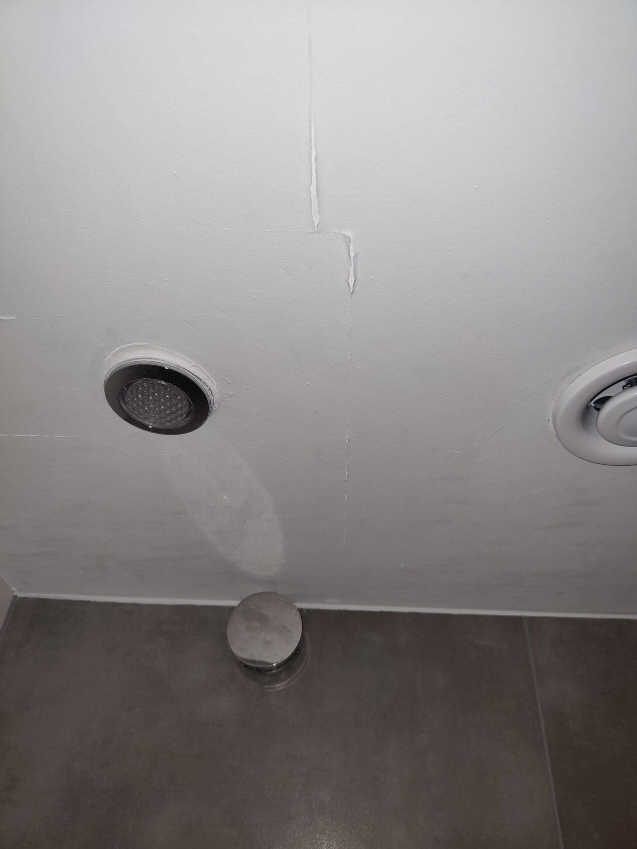

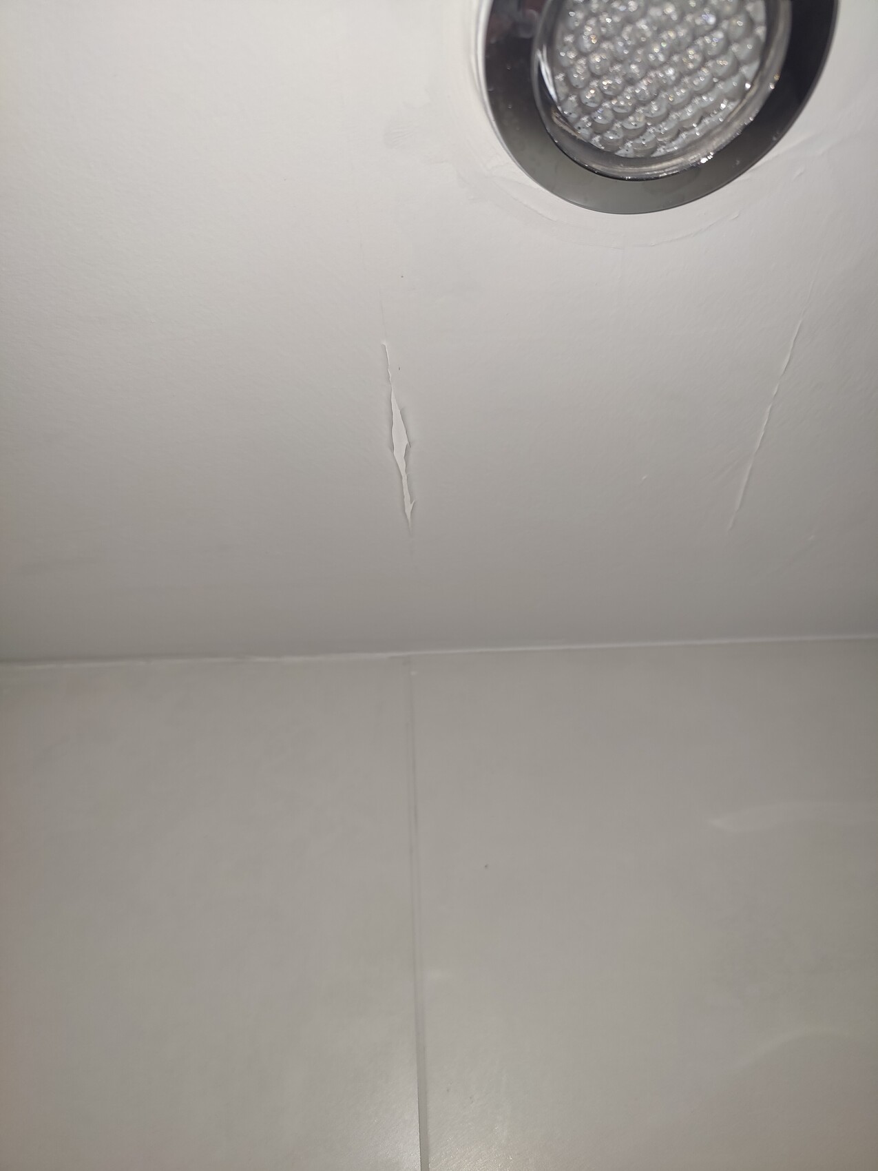

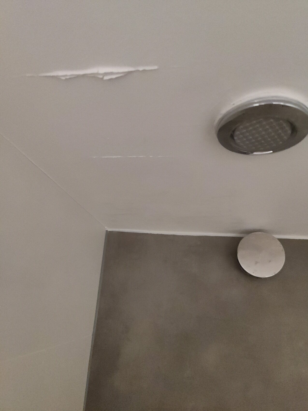

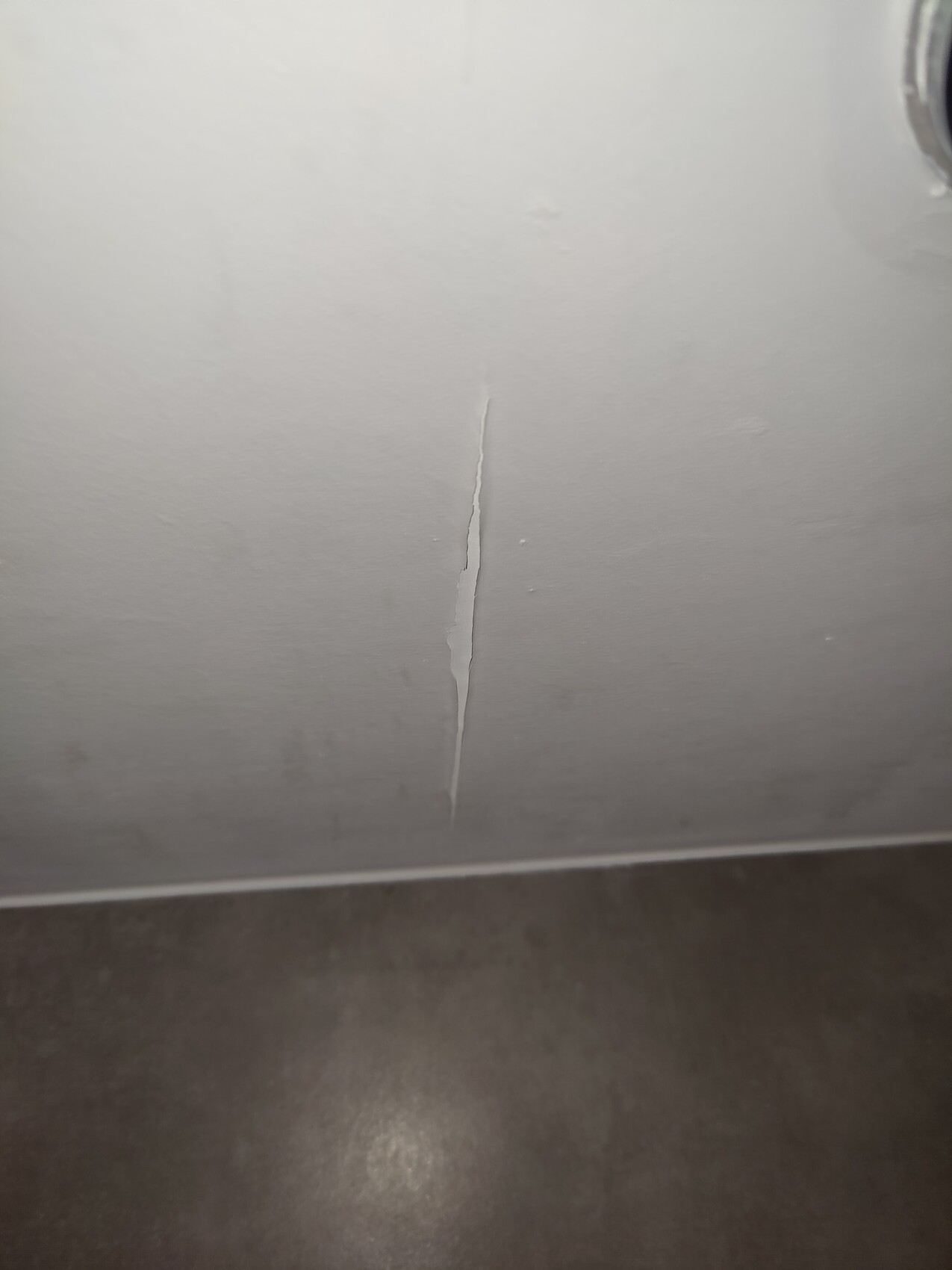

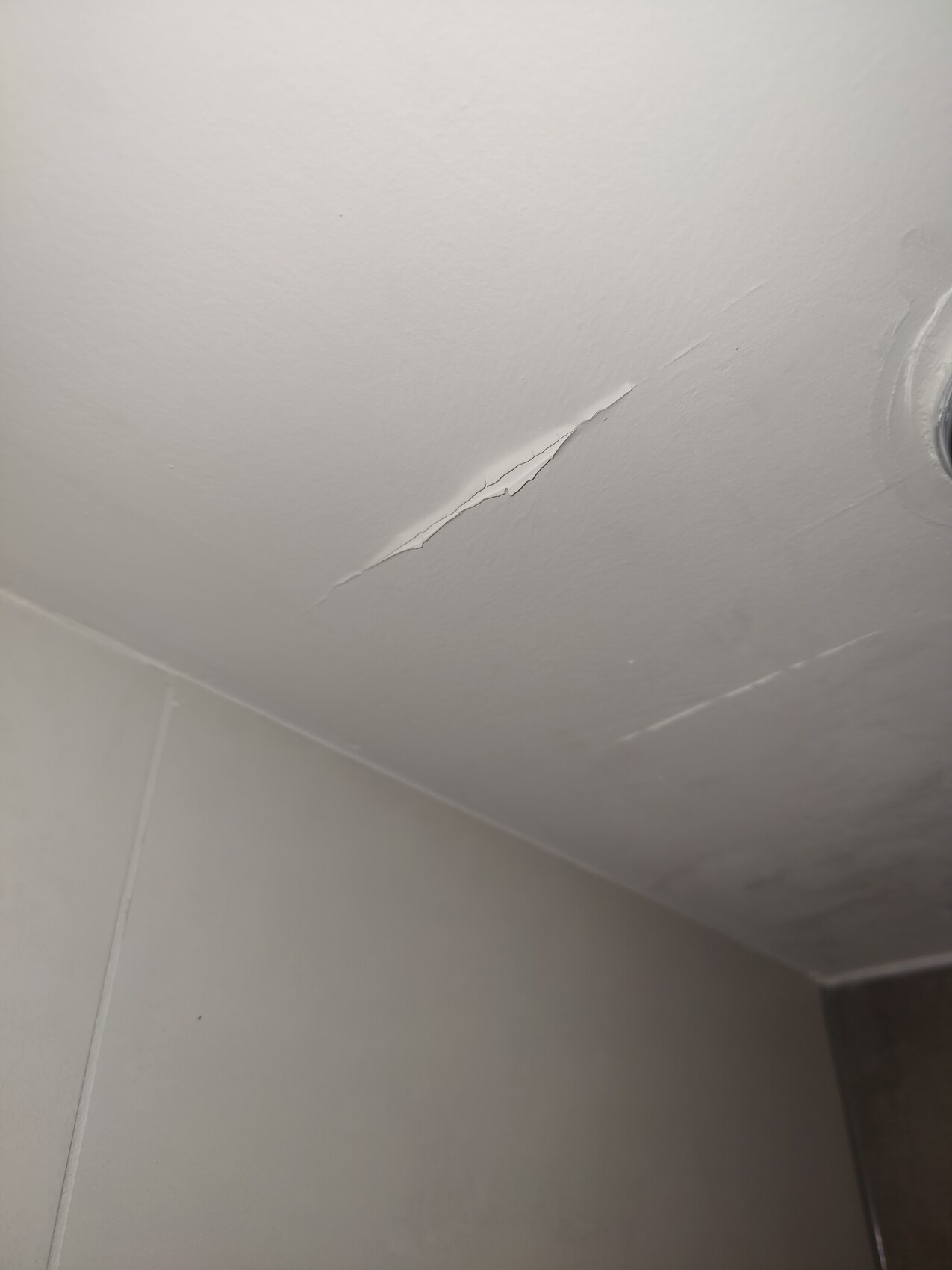

Hello, a ceiling in a steam room was constructed using the following layers:
- Aquapanel board installed without joints
- Aquapanel joint compound
- Primalon PM 200
- Disbopox W447 2-component universal resin
The coating shows some cracks and adhesion issues.
Does anyone have suggestions for repairs or materials suitable for refinishing or for a new layer buildup?
Best regards, Philipp

wpic29 Nov 2023 07:43
