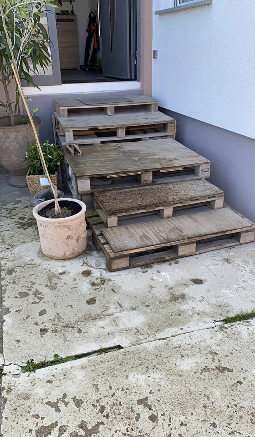

Now, instead of pallets, a large stone staircase is to be built.
The concrete slab in the yard will be removed.
For this, I plan to install formwork blocks shaped in a U to avoid damaging the base.
The base is insulated with XPS and plastered.
The actual stairs will be made with stone steps (not yet decided which type).
So far, that part is clear to me.
I will also pour an 80cm (31.5 inches) deep concrete footing under the formwork blocks.
