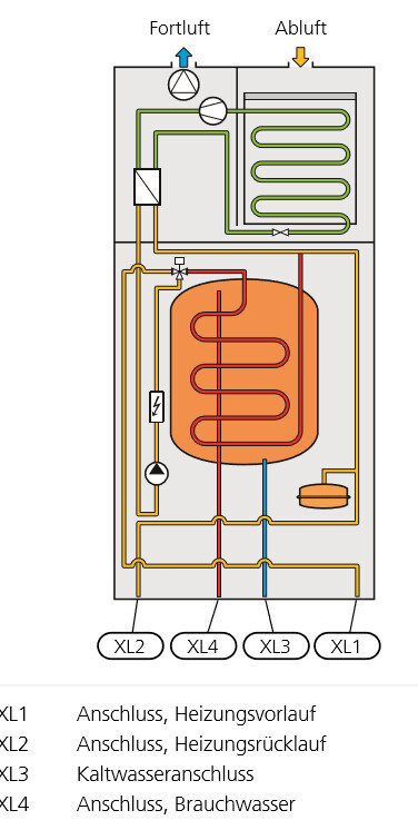

boxandroof5 Jun 2019 15:30The house’s exhaust air alone is not sufficient to operate the heat pump. In that case, either additional electric heating must be used, or the heat pump can also draw from outdoor air. I’m not sure if the latter applies here. The latter option increases complexity, initial costs, and depreciation expenses, while pure electric heating just generates additional costs.
There are few reasons to justify using such a heating system. However, general contractors seem to prefer it quite often.
With a standard mechanical ventilation system with heat recovery, the heat in the exhaust air is not lost either.
