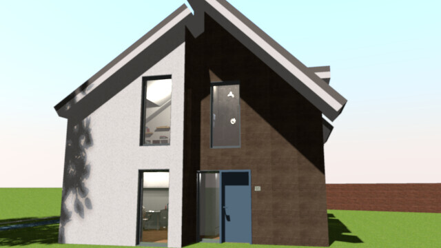

We are building a relatively small bungalow.
The narrow side of the bungalow, which is the gable, faces the front. The entrance is located there, with two windows on either side. These three elements are positioned more towards the left. As a result, there is a fairly large area of blank facade on the right side, which makes it look asymmetrical.
Does anyone have any ideas on what could be added or how it could be designed to avoid looking so empty?

Do you have details on how you do it? Our house has a recessed entrance. The entire entrance area is covered with Trespa panels. The back side at the terrace is done the same way.
I created a rendering for you. Since I can’t accurately show the typical Trespa joints, the image is just a rough idea. I can share an updated version once it’s finished.
For your house, I could imagine using this just as an accent.
You could easily do this with wood as well; it doesn’t have to be Trespa. That’s quite common too.
Or you could just add a splash of color. Many Danwood houses have a nice red or anthracite accent. You can check that out on their website.
winnetou7816 Jul 2017 09:58Yes, the base will of course be painted in a contrasting color.
I am only concerned about the small left area, which is relatively empty.

Or you could just add a color accent. Many Danwood houses have a nice red or anthracite accent there. You can check that on their website.That is nice of course, but a completely different concept. However, the idea of adding a few of the panels on the left side is not a bad one.
