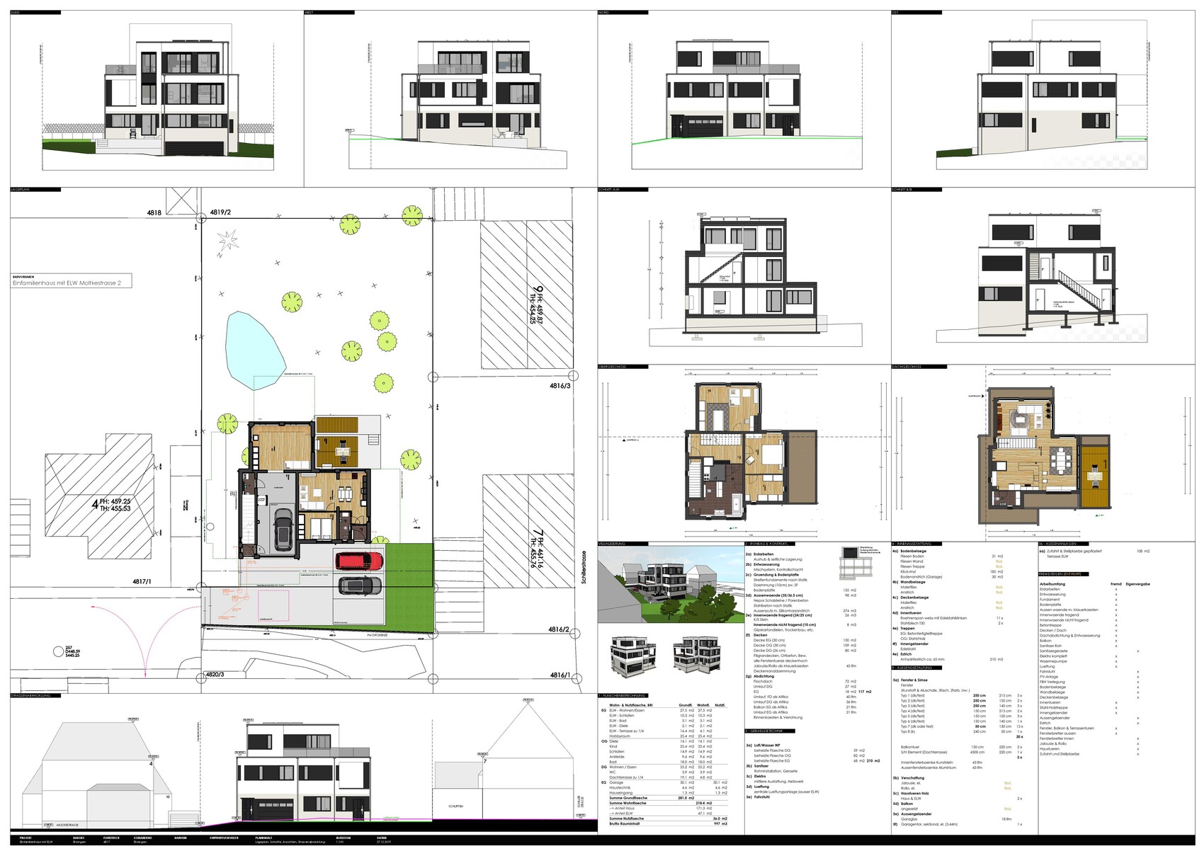

we would like to include an elevator in our single-family home.
In our current plans, we have allocated a shaft with a floor area of 1 sqm (11 sq ft).
To anyone with experience in this area: we appreciate any constructive advice.
Thank you very much! Alex
Architekturplan eines modernen Hauses mit Grundrissen und Ansichten

Unfortunately, I cannot see anything in your attachment.
If the elevator is going to have the standard size of 110 x 140 cm (43 x 55 inches), the shaft’s internal dimensions need to be 30 cm (12 inches) larger on each side. So, the shaft size would be 140 x 170 cm (55 x 67 inches). Of course, there are also custom-made elevators.
