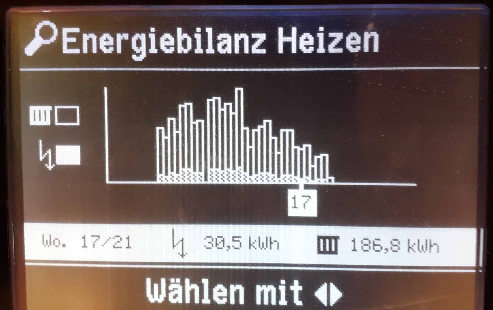

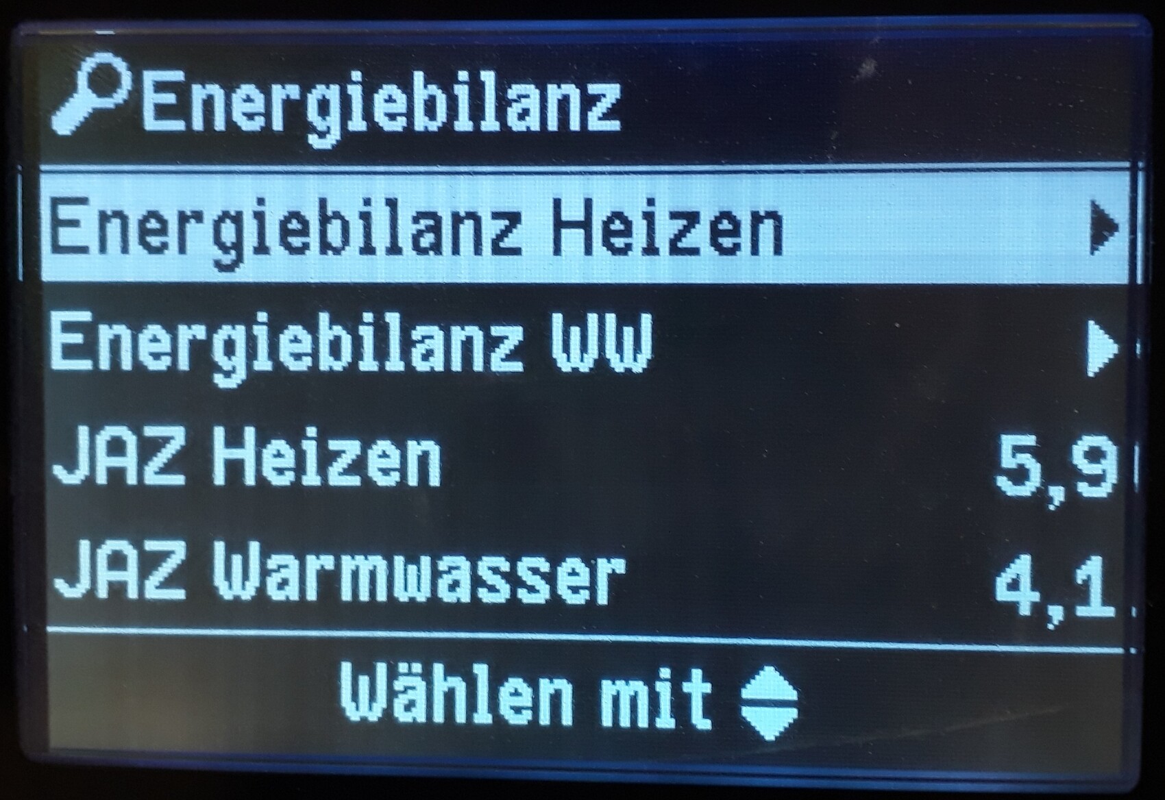

You can skip the intermediate meter because the function required by BAFA to measure the electricity consumption and heat output of the heat pump is already integrated into the heat pump itself—at least in our Vitocal (model 333):
A special electricity tariff for the heat pump is usually not necessary if you have a photovoltaic system anyway. So, a standard two-way meter typical for photovoltaic systems is sufficient, and that’s it.
