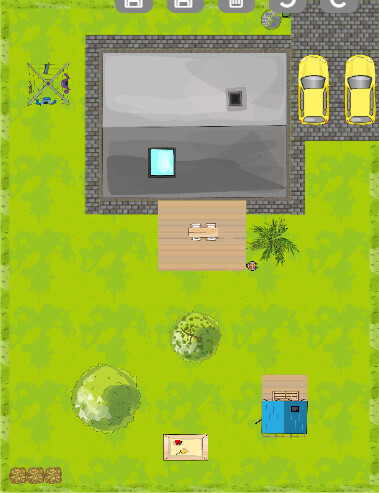

We are still in the planning phase and want to plan as much as possible in advance to avoid having to redo everything later... 🙂
I donât yet know what kind of garden shed we will build or when we will do it, but I am pretty sure that it makes sense to run a cable from the distribution board to the possible location of the garden shed beforehand.
But how should I handle potential lighting elements in the garden? If I later branch off cables from the garden shed, I would only be able to control them from the shed itself...
Or would it be better to run multiple cables, for example one non-switchable cable for the garden shed and another one (switchable at the patio door) into the garden shed and then branch off from there?
Attached is a sketch of the garden.
Thanks in advance
Marvin

An important factor for planning is the total cable length for the corresponding cable cross-section. Of course, it is also necessary to know which devices (load) will be connected to the supply line.
meister keks19 May 2018 20:53I would run a cable to the garden shed; later on, you can install a distribution box there, and another one under the terrace where you can also add a distribution box.

OK, thanks already! So, two outlets should be enough...? One for the garden shed (lighting + sockets) and the other controlled by a switch inside the house for the garden lighting.

How exactly does the cable run out of the house? Shouldn't it be beneath the foundation slab? I mean, you wouldnât just drill through the exterior wall... 🙂
