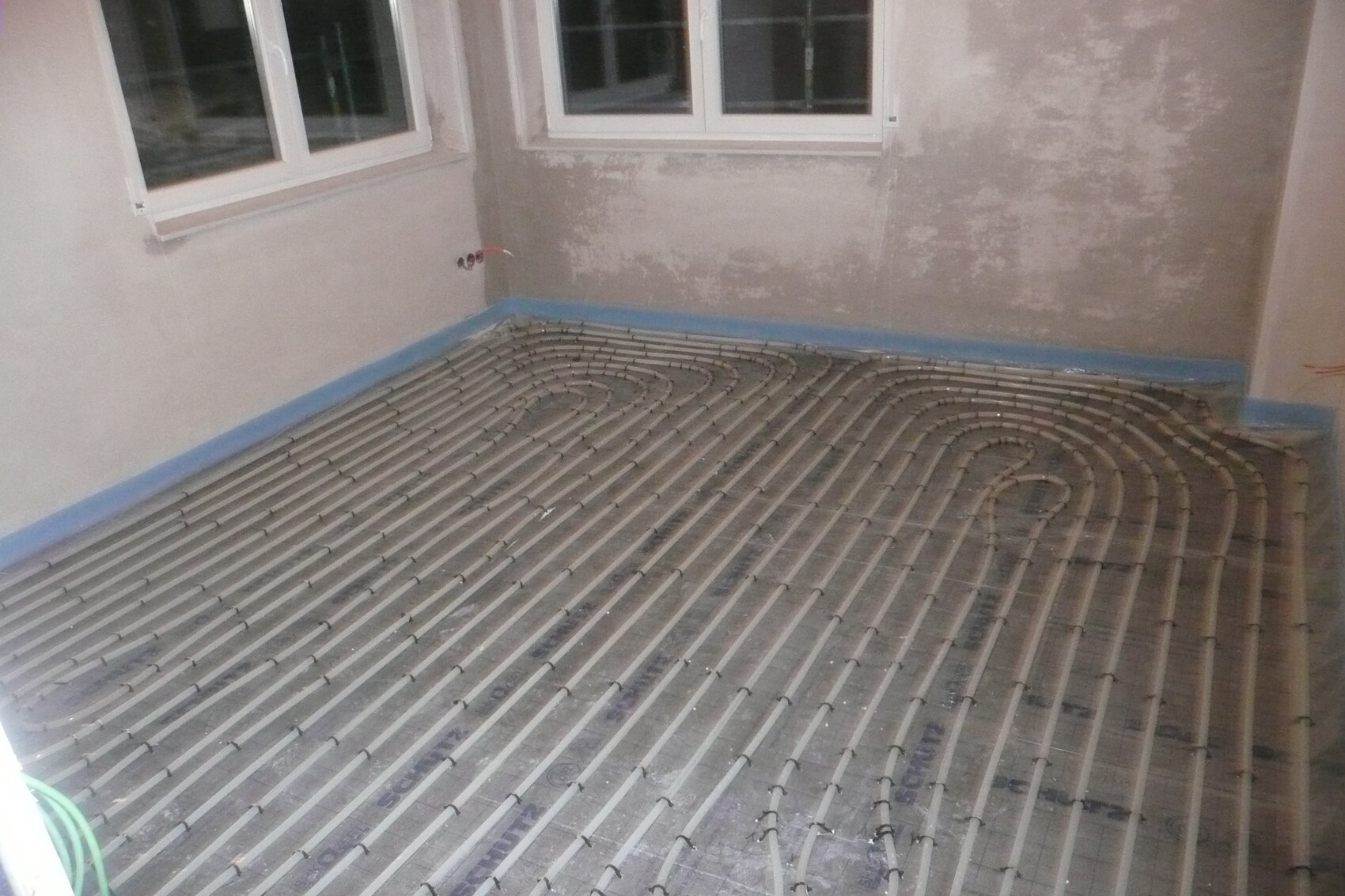

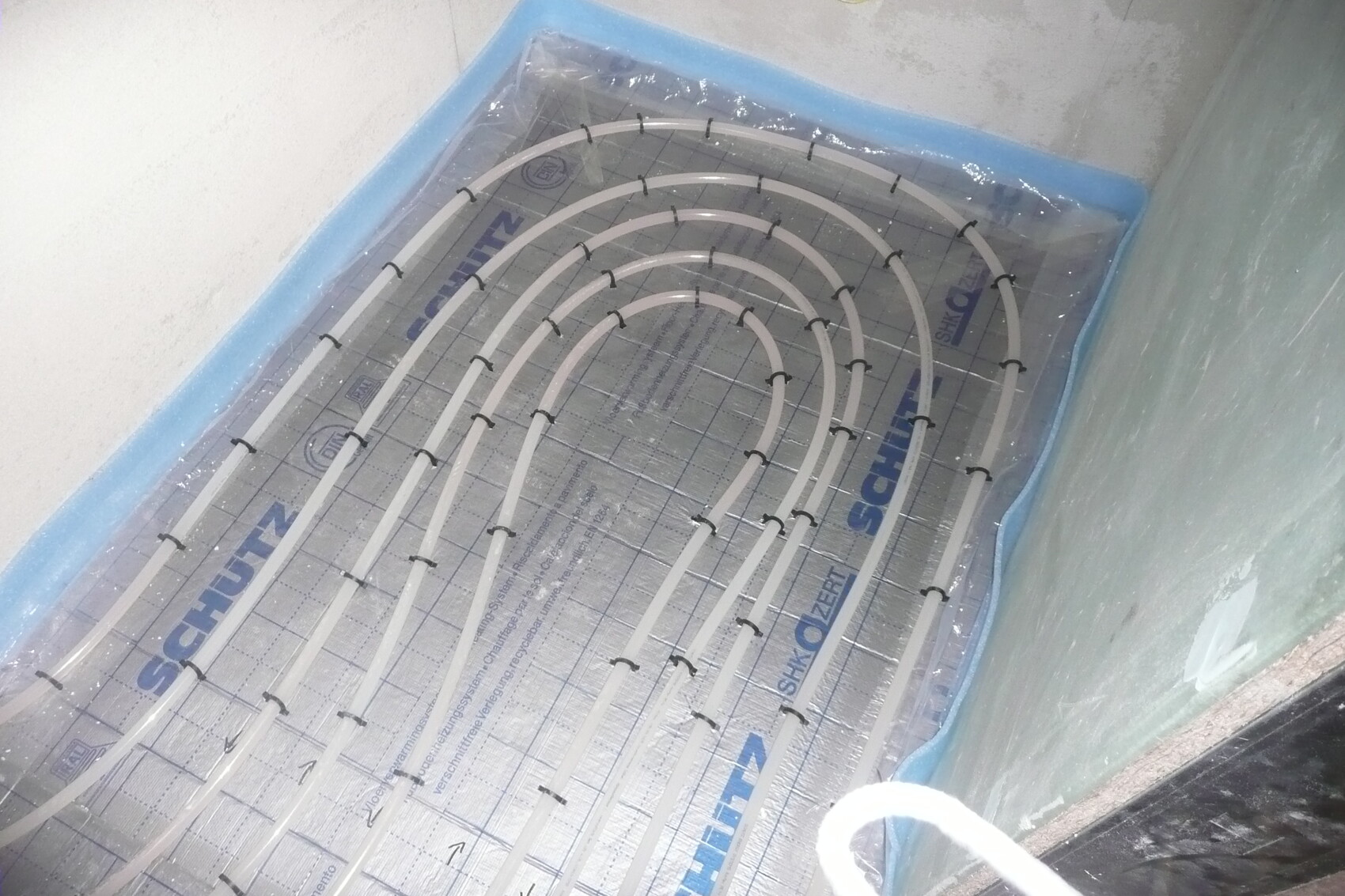

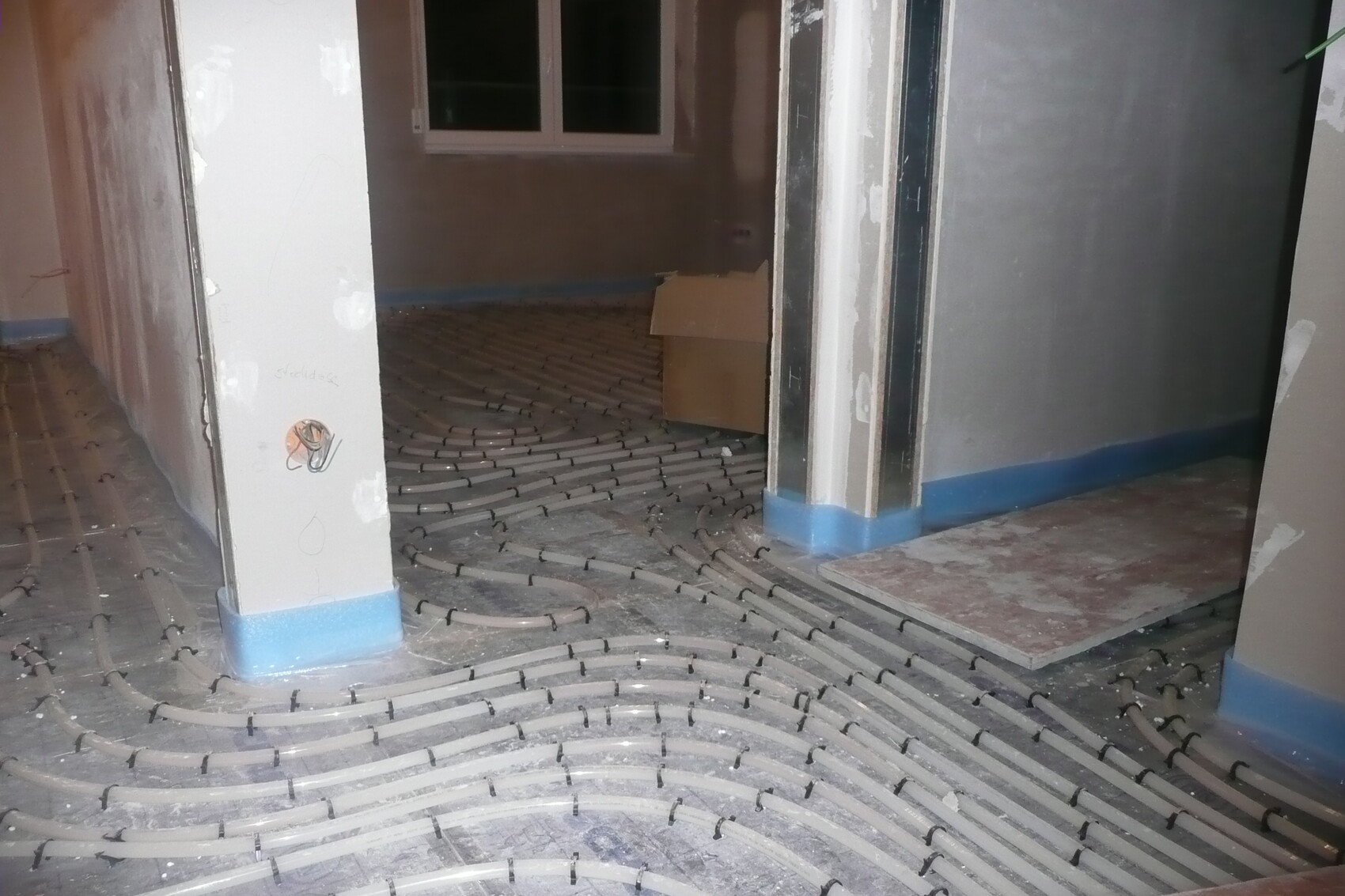

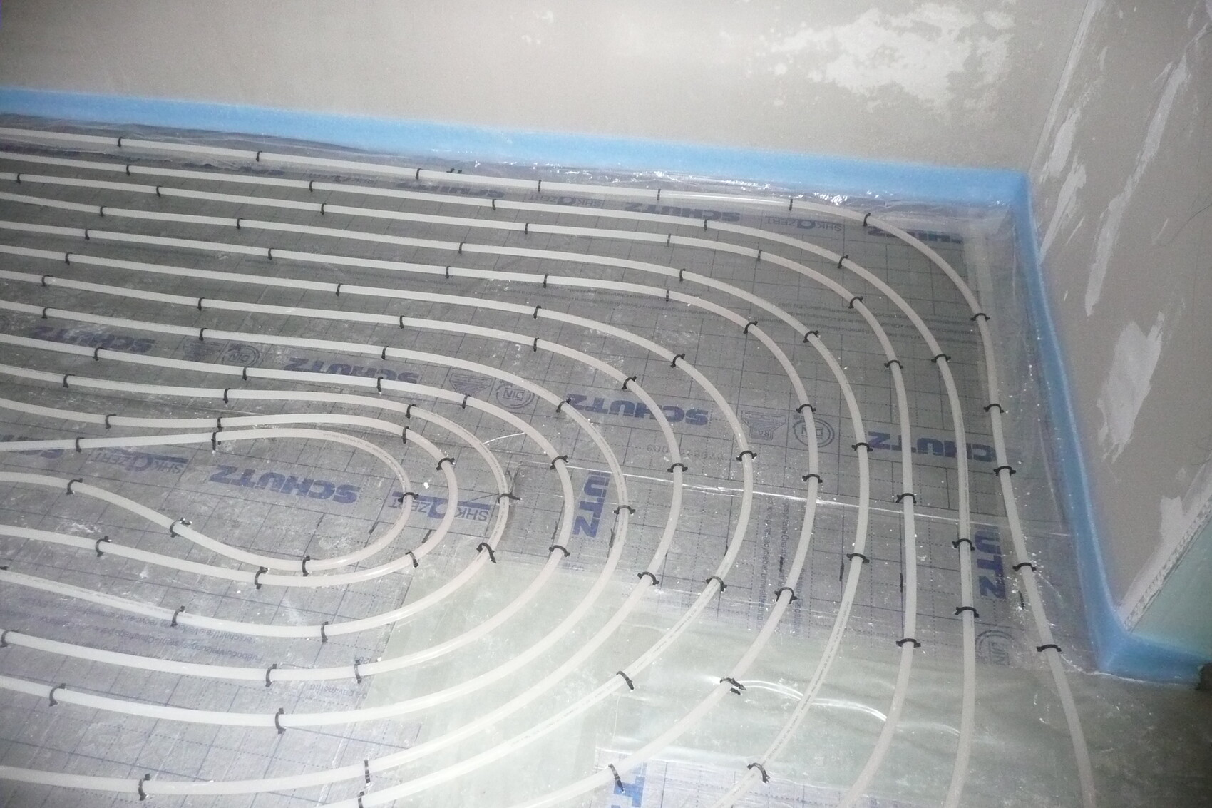

- The whole house has underfloor heating.
- In the bathroom, there are two additional infrared heaters because the underfloor area was not sufficient. They run for about 1 hour per day in winter—30 minutes in the morning and 30 minutes in the evening.
