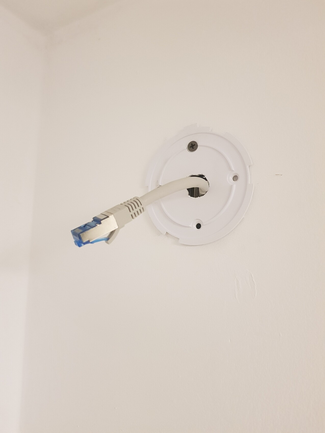

White round wall box with RJ45 network cable plugged in.
This is how I installed the UniFy APs. A deep flush-mounted box with a Keystone jack installed on a solid-core cable. A very short and extra flexible patch cable is used to connect the access point. I drilled a hole in the mounting plate of the access point and attached it. Unfortunately, the drilling pattern of the flush-mounted box does not exactly match the mounting plate, but I managed to secure it with two screws, which is more than enough.
By the way, they are mounted on the wall side and work perfectly.
