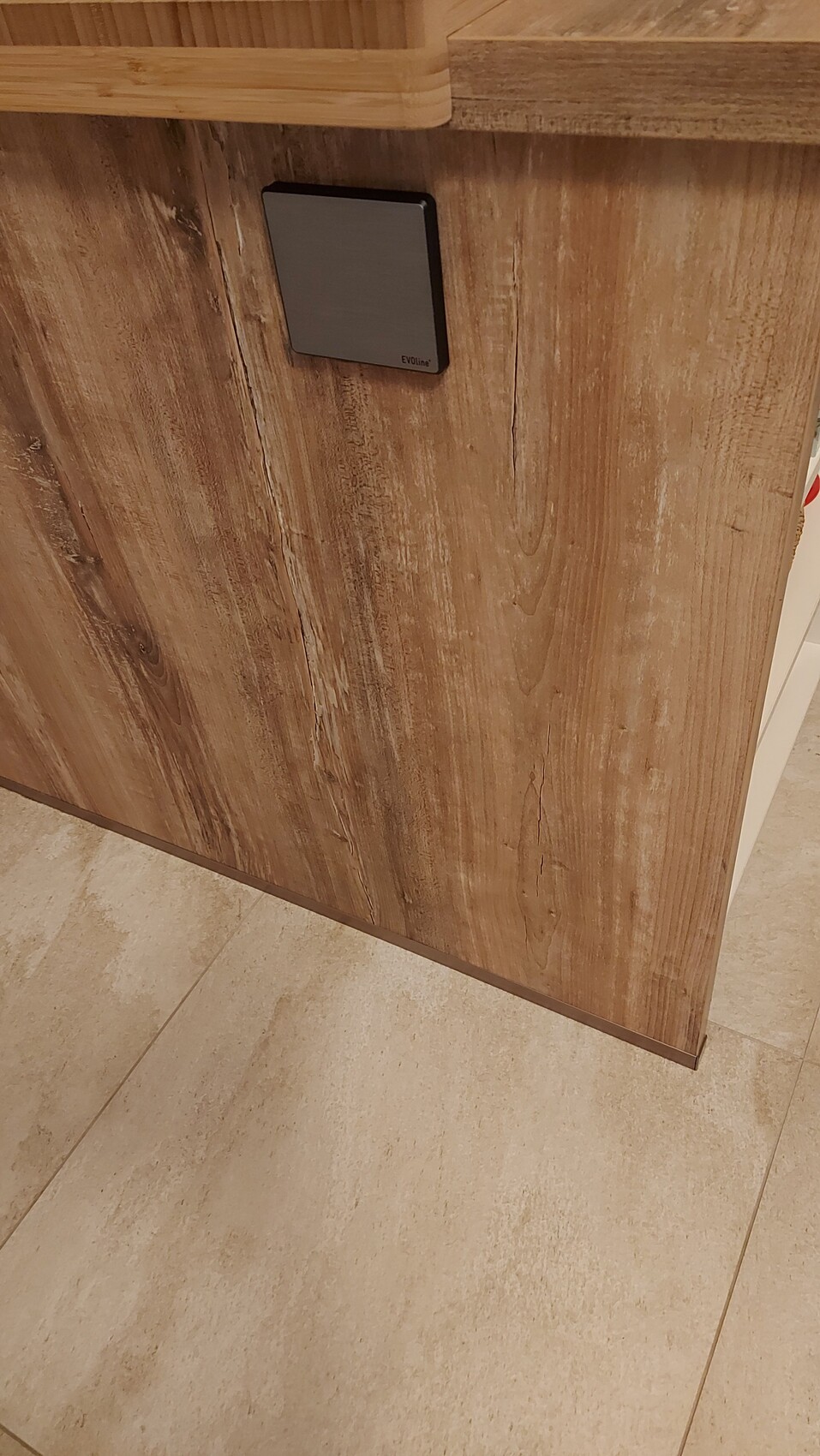

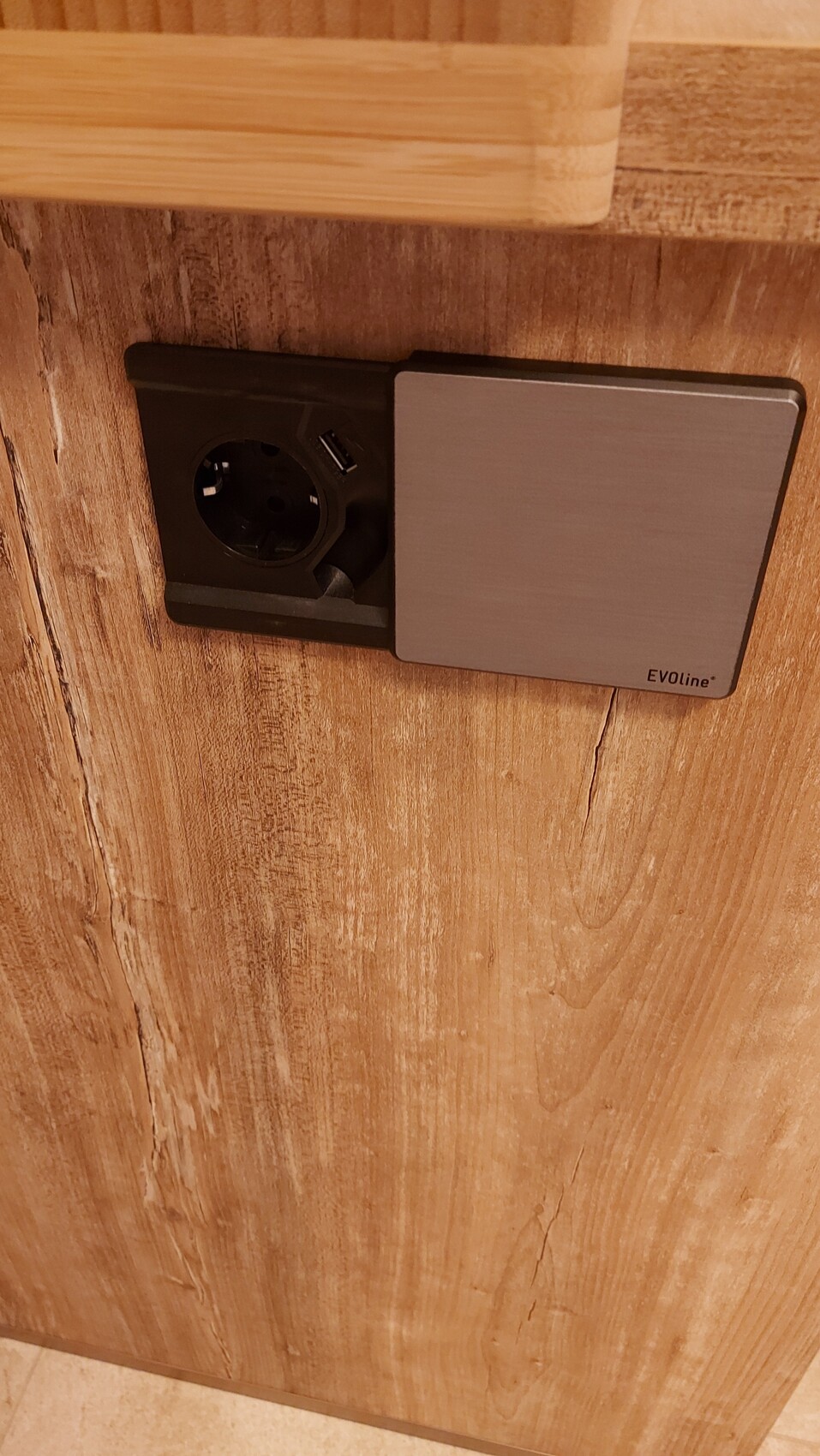

Nida35a25 Mar 2024 00:02
Stephan— schrieb:
So we simply screwed three surface-mounted boxes inside a cabinet (not very attractive, but it works)
We have this on the outside at the side, but only for the mixer when baking, or the vacuum cleaner
Gray square EVOLine switch system on a wooden panel.
Schuko socket with USB port and gray stainless steel cover on a wooden wall.

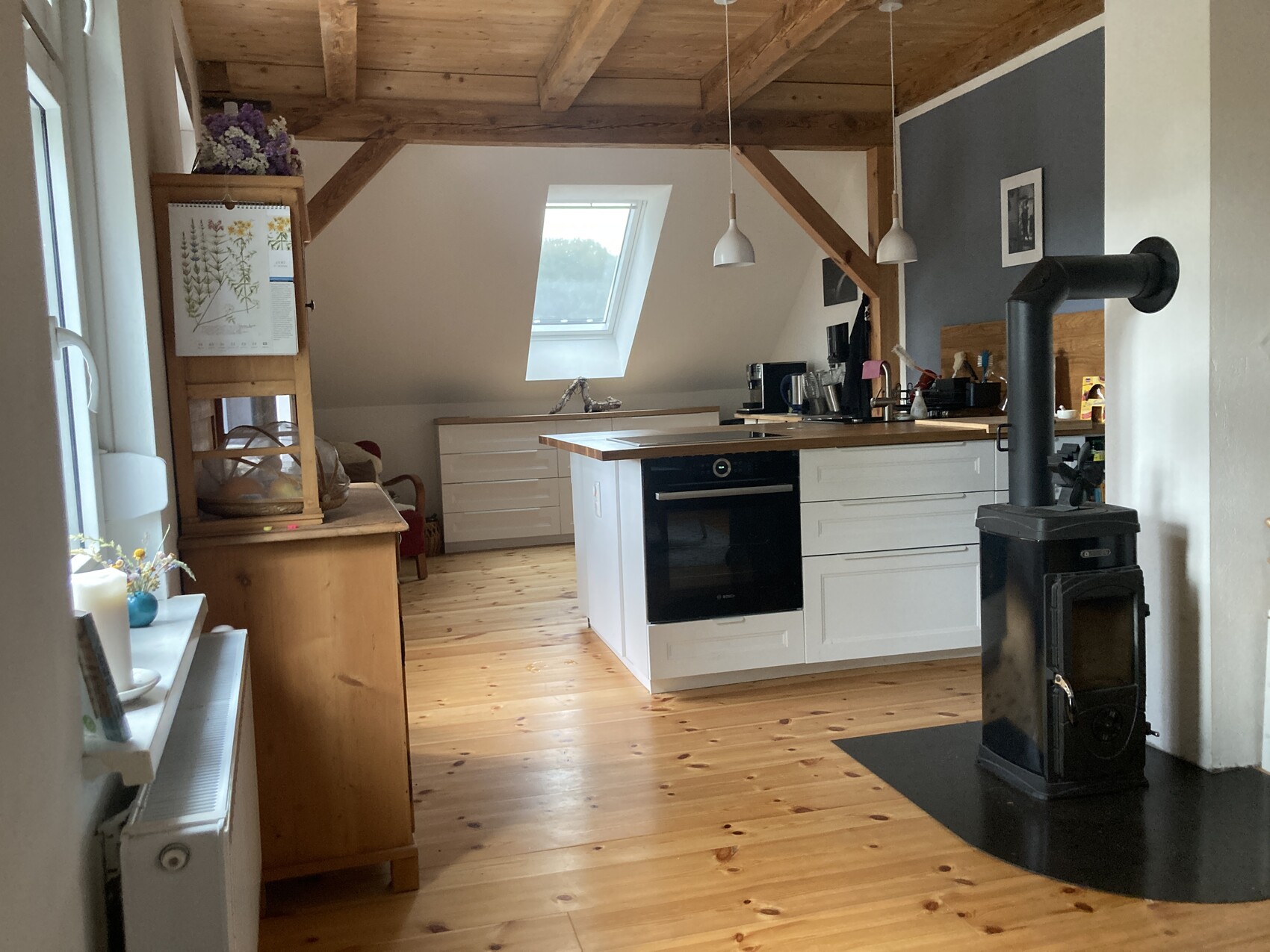

No new construction, so we had to work with what was already there (routing cables through the floor was out of the question). Maybe this still helps: We have a pop-up outlet on the island, one on the side including a switch for the light above the island. Inside the cooking island, there is a hidden outlet each for the dishwasher and oven (both use standard sockets) as well as two phases for the induction cooktop (independent).
Küche im Dachgeschoss mit Holzbalken, Holzfußboden, Inselküche, Kaminofen und Dachfenster.
