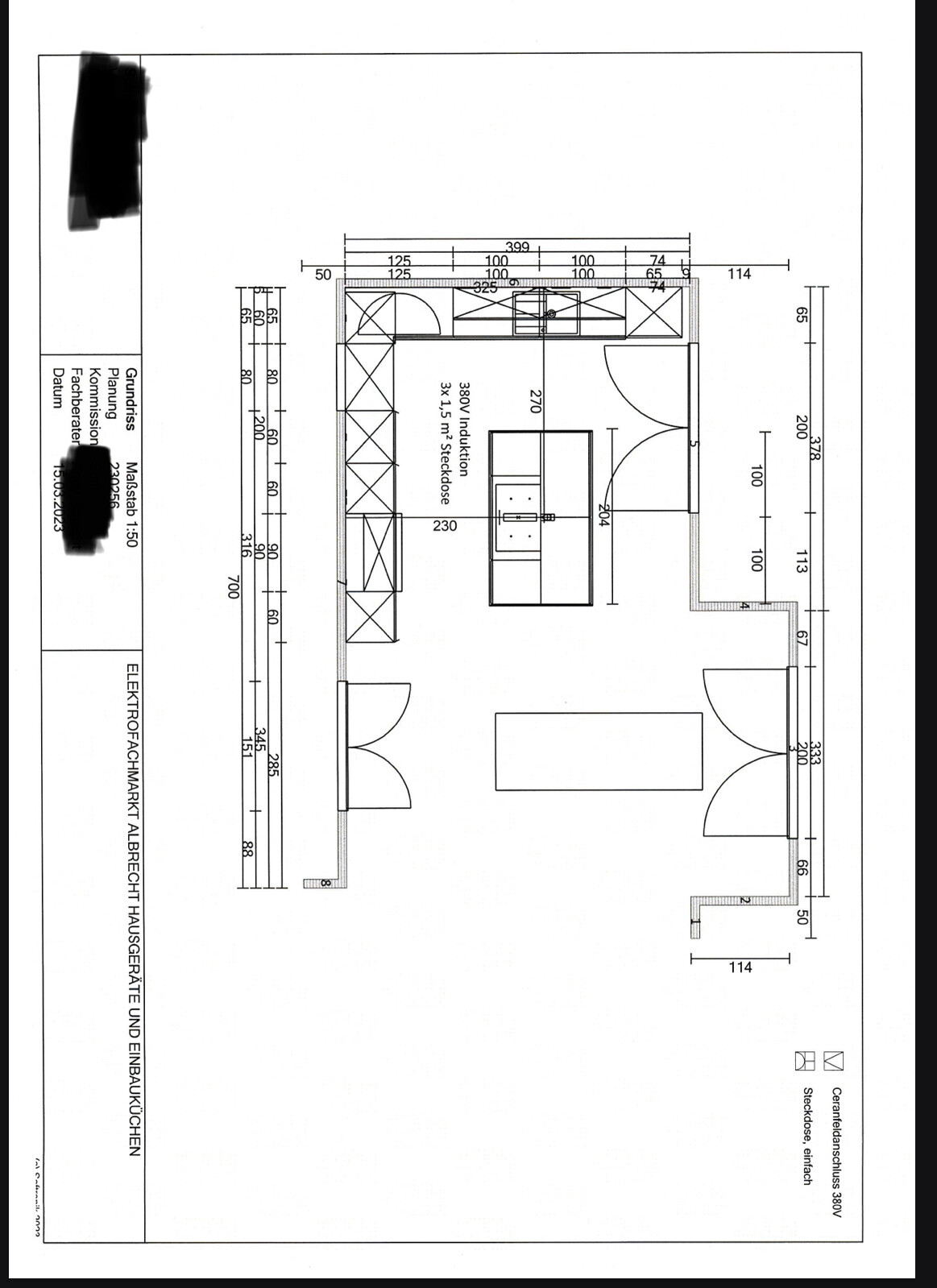

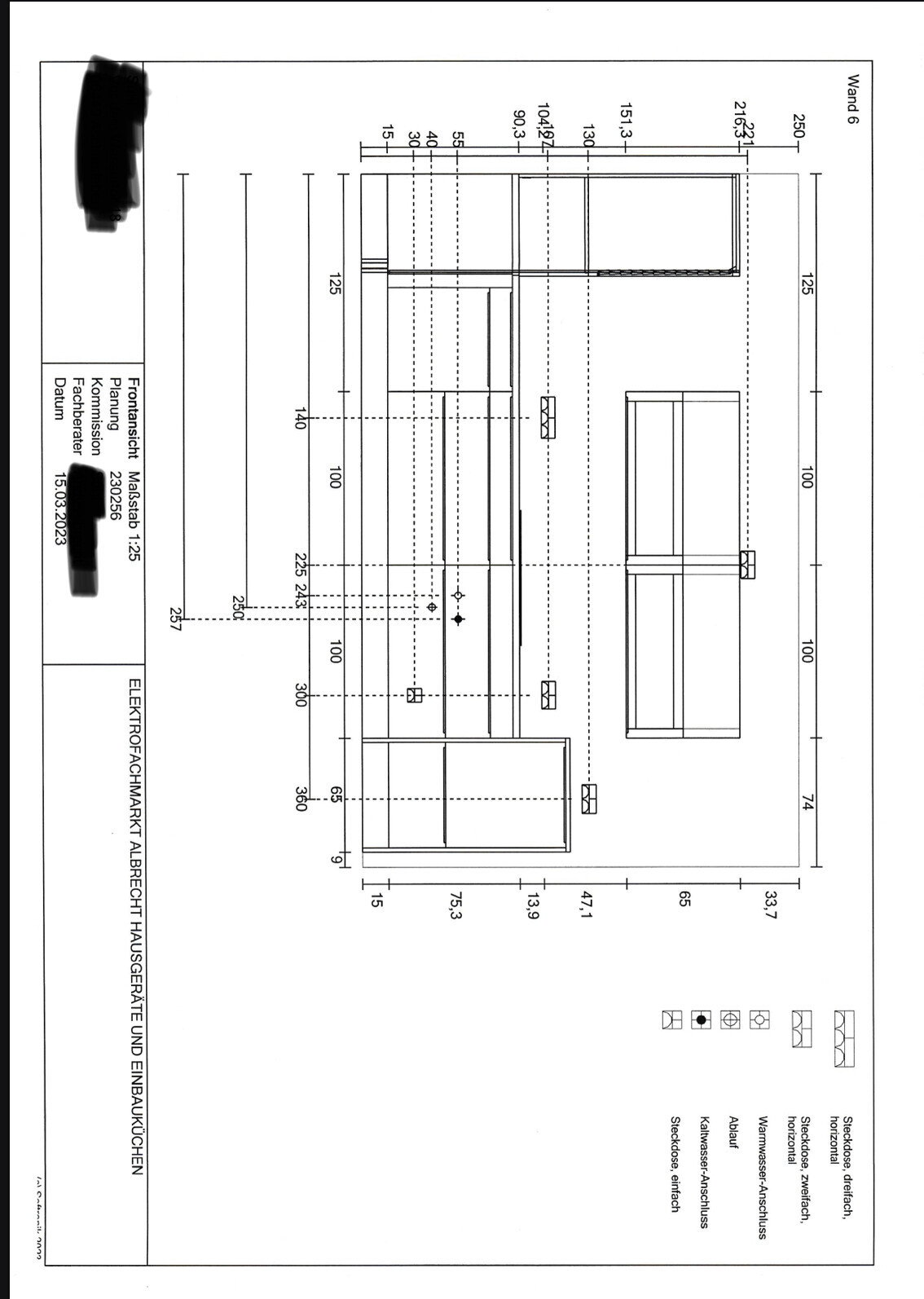

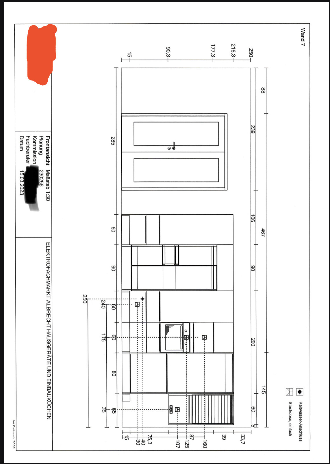

We recently had the electrical planning meeting. During this process, the following plan was created. Unfortunately, no furniture is shown, so I have also included a floor plan with furniture. This is our first time doing something like this. I would appreciate your feedback, as I am sure you can provide valuable advice and some helpful suggestions.
I am particularly uncertain about the kitchen, main bathroom, and staircase areas.

Should I really install 5 ceiling light outlets in the kitchen? Although a lot of light is needed, I wonder if this might be too many.
What do you think about the wall outlets in the staircase area?
For rooms of at least 16 sqm (172 sq ft), I have always planned two ceiling outlets. Do you think it is also necessary if the room is, for example, 16.5 sqm (178 sq ft)?

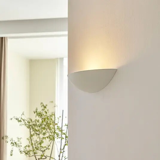

NatureSys20 Sep 2023 21:22Regarding the wall lamps: In our home, all of them are mounted at about 195 cm (77 inches) height and shine exclusively upwards. This creates nice indirect lighting (each dimmable) in both the living room and the dining room. There are three lamps in the living room and two in the dining room. Additionally, we have a lamp above the dining table in the dining room and adjustable surface-mounted spotlights (not recessed) in the living room.

Kitchen: Definitely install ceiling outlets above the countertops and any potential table. Plenty of sockets are essential, including at possible seating areas, whether for a toaster or phone charging.
