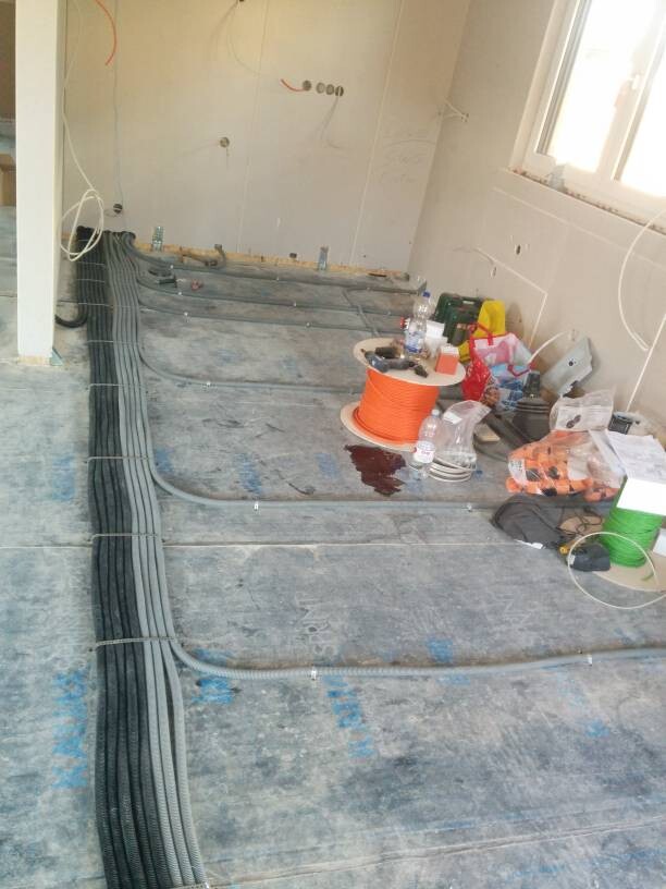

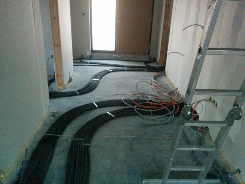

Is it common practice for the cables/conduits to be laid on the rough floor?
I'm currently bothering my architect a bit to finish the electrical scope of work because I always assumed with KNX that all the cables would go into the precast concrete ceiling together with the mechanical ventilation system, and then be covered with cast-in-place concrete.
The reason I'm bothering him is that I thought the electrician and the concrete contractor would have to work simultaneously...
truce20 Sep 2017 22:15
ruppsn schrieb:
Is it common to lay the conduits / empty pipes on the raw floor?
I believe this is common practice, but not absolutely necessary.
Theoretically, all supply lines could be installed within the ceilings and then brought up through the concrete at the relevant locations (e.g., power outlets per room, satellite, or network connections).
This way, the remaining wiring can be chased into the walls, avoiding the need to run them on the concrete ceilings.
However, we chose to lay the wiring on the floor because it requires less chasing and therefore fewer cables inside the walls. Additionally, it offers more flexibility for making changes later on.
In our case, only the supply lines for lighting and the motors for the roller shutters / blinds are embedded in the concrete ceilings because we also have ventilation ducts there, making the space for conduits very tight.
Our structural engineer was definitely quite frustrated about this.

Hello truce,
thank you for your quick reply.
truce schrieb:
The structural engineer was definitely shocked
Yep, our structural engineer also already has sweat beads on his forehead every time there’s news from us.
If you place the electrical installation on the structural floor slab, what will be your floor buildup height?
Which layer would compensate for the cables with the following buildup (160mm (6.3 inches))—meaning which layer would have less material above the conduits? Or does the entire buildup increase by the diameter of the conduits?
15mm (0.6 inches) surface finish (industrial parquet)
65mm (2.6 inches) cement screed
20mm (0.8 inches) impact sound insulation
50mm (2 inches) floor insulation board
10mm (0.4 inches) vapor barrier
I somehow find your option more appealing...
truce20 Sep 2017 23:05
ruppsn schrieb:
If you place the electrical installation on the ceiling slab (RFB), how thick is your floor construction then?
In a 160mm (6.3 inches) setup, which layer would compensate for the cables (meaning having less material above the conduit pipes)? Or does the entire build-up increase by the diameter of the conduit pipes?
In our case, there is 2 x 40mm (1.6 inches) insulation on the ground floor and 1 x 50mm (2 inches) insulation on the upper floor.
The conduit pipes, as well as the plumbing pipes, should all be completely embedded within these layers.
The screed installer, or whoever lays the insulation, will have the fun, though.
They have to cut out all the pipes and then refill with loose insulation.
So, no matter which option you choose, someone is bound to be less than happy.

We also installed our electrical wiring with extra conduits due to the increased cable volume for KNX. The conduits are embedded within the insulation. An electrician later mentioned that conduits aren’t necessary for NYM cables, but I preferred to have them anyway. We wouldn’t have had enough space in the ceiling otherwise.
