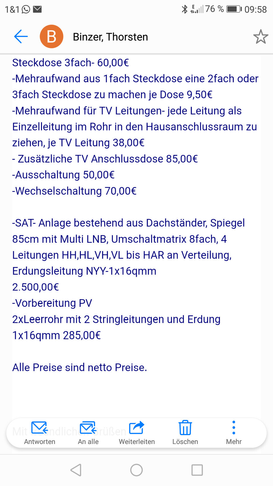

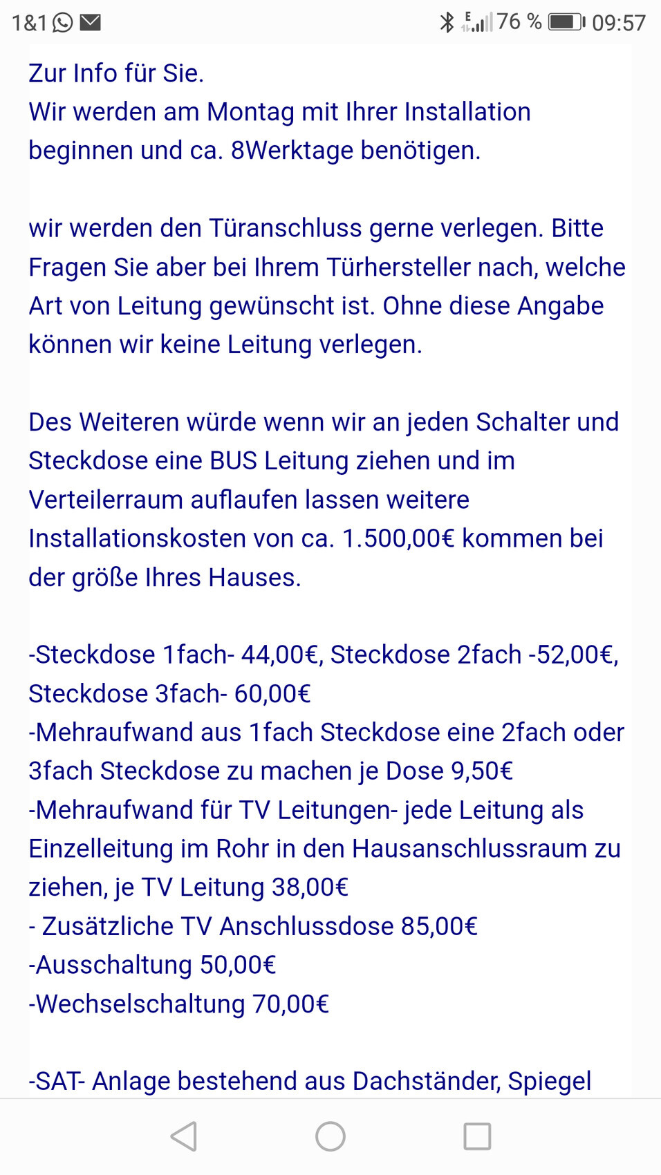

For internet/telephone, we only have 2 lines. He wanted to charge 108€ per outlet for more lines, so we are now doing it ourselves, meaning there will be an internet connection in every room.
