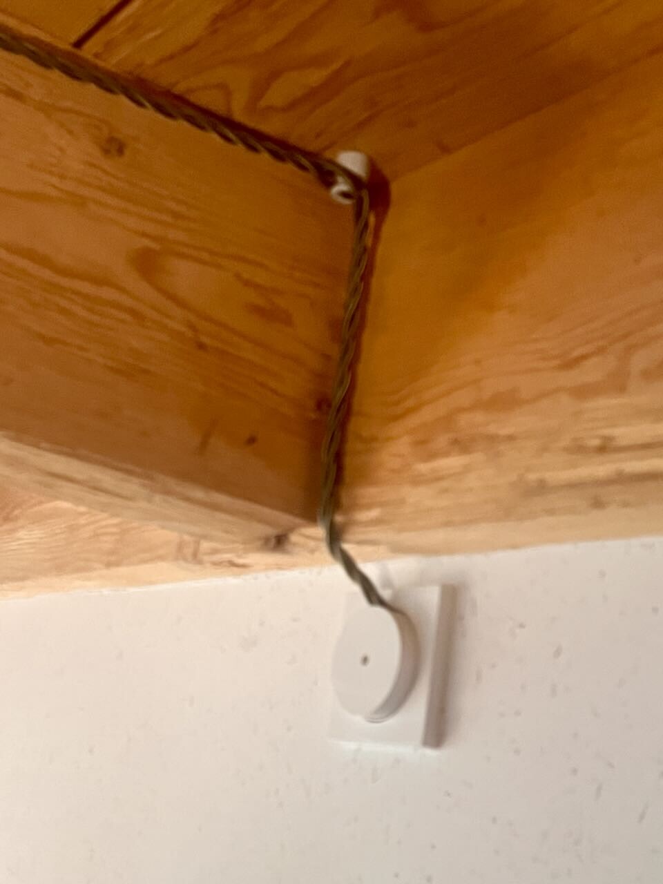

wiltshire27 Jan 2025 11:28I find it difficult to understand the problem since I am not aware of the progress on the construction site. I also did not fully understand where the light points are supposed to be placed. Actually, the installation within the structure should not be problematic if the location of the light points is already planned and the light fixture has been selected – although I might be mistaken due to my lack of knowledge.
I can suggest how to use a wall outlet box and run a cable from there – in my opinion – neatly to the light point with a picture. The box is by Berker, the cable by Gi Gambarelli. We decided on this option because the cable leads to a range hood installed under a solid wood ceiling, where it is not possible to run cables inside.

Do I understand correctly that the cable outlet is mounted on a standard 68mm (2.7 inches) hollow wall box / junction box? So you run your NYM cable to the box and then continue with the final cable from there?

wiltshire27 Jan 2025 12:33If the installation level is still open, you simply run a "sufficient amount" of cable to a point behind the future bench seat. When the bench seat is later installed, the lighting and outlets are integrated into it, and everything works out fine.
Flitz86 schrieb:That's exactly how we did it.
So you ran your NYM cable up to the outlet and then continued with the final cable from there?
