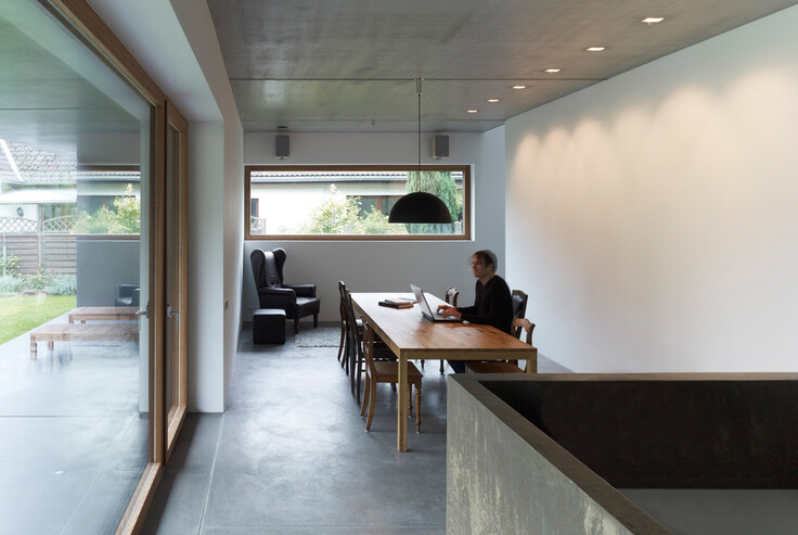

We are currently planning our house and would like to have a precast concrete ceiling, possibly as exposed concrete (depending on whether we like the look or not). Our plan is to place the cables for the ceiling lights (surface-mounted spotlights, not recessed lights) along the joints of the ceiling (see the pendant light in the picture). Is it possible to make the cable outlets exactly in these joints, or would that cause problems?
What should be considered in this regard?

Peanuts7413 Mar 2017 15:33I don’t understand the problem. The cable is not being installed from below into the joint, nor is a slot being cut into the ceiling. Instead, it is laid on the raw subfloor of the floor above and then drilled down at any point (or from below up, to prevent any chipping).
